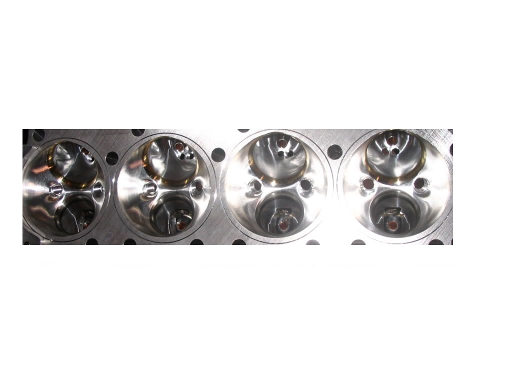

It depends. Without seeing the cylinder head, I can't give you an answer as to whether another Timesert could be installed.
I can tell you that cylinder heads can be repaired, but the cost of doing so would likely exceed the cost of just buying a complete reconditioned 3RZ-FE or 5VZ-FE (you didn't state which engine you have) head from a reputable engine repair/machine shop.
Repairing would usually be reserved for expensive cylinder heads.
An example of a cylinder head that was repaired before and after:
