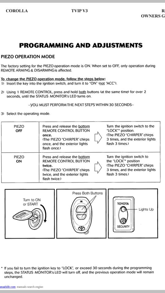

Has anyone tried to set the piezo to not chirp, then set it back to chirp? I found this for my 97 alarm system:
RS3000 Toyota Vehicle Intrusion Protection
I'll try it later today and see if this works. If not, I might just enable the Passive Arming System to just automatically lock after 15 seconds after the last door has been closed when the key is removed from the ignition. Peace of mind for the times I think to myself...did I see one blink when I pushed the button.

Darn...didn't work. I was able to turn the passive arming feature on though. It arms after 15 seconds but will not lock the door automatically.
Did replacing the piezo solve the problem? I'd like for mine to work again... It worked prior to me doing the timing belt and valve cover gaskets.
My guess is also a defective/worn pezio or relay/wiring. I set mine to pezio "off" 8 months ago and haven't heard it since. Easy/cheap fix I would think.

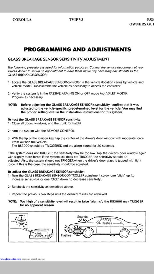

Looks like only the glass breakage sensitivity is adjustable.
