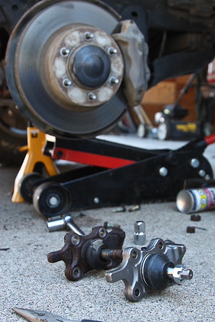

New JAPANESE lower ball joints
20110718-IMG_9681 by RickaShay24, on Flickr

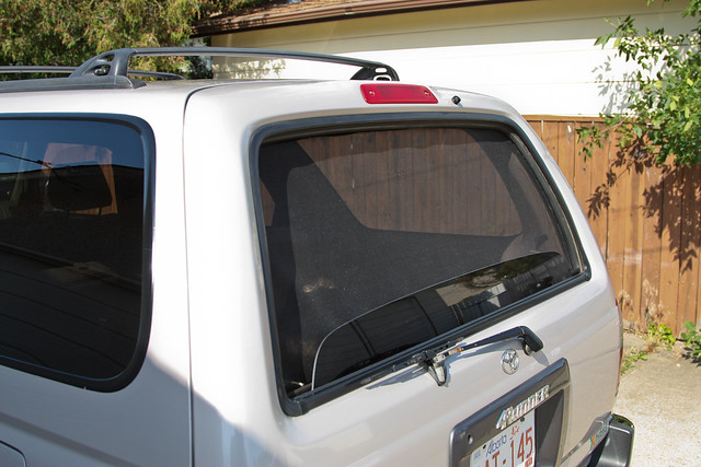

Rear window velcro screen setup to keep the bugs out when Im sleeping while still allowing some airflow...im already liking this mod.
20110719-IMG_9685 by RickaShay24, on Flickr

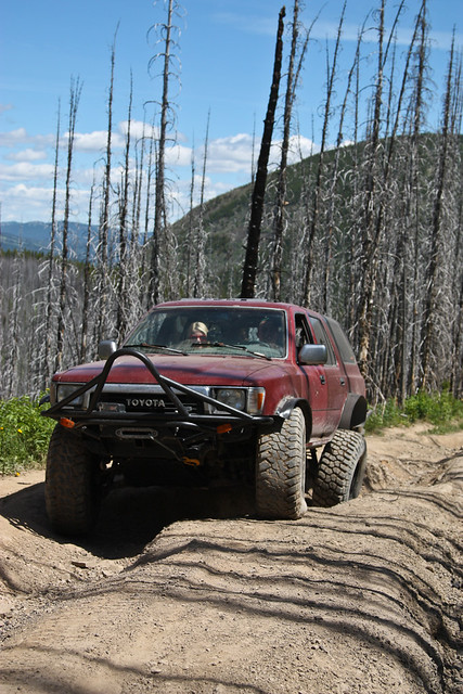

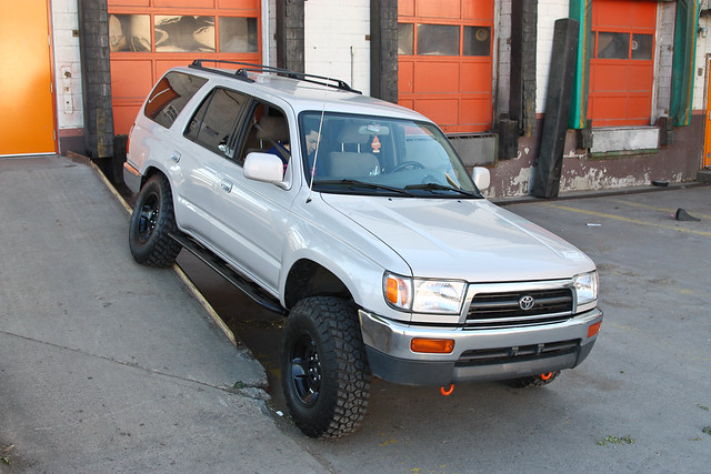

And some poser shots from a couple weeks ago that I forgot to post. Rear sway bar is off in these pics but the front remains. Currently I am running without BOTH sway bars. I will try the ramp again when I have time to see how much difference the front sway bar makes.
20110702-IMG_9525 by RickaShay24, on Flickr
20110702-IMG_9519 by RickaShay24, on Flickr
Hey man! Lookin good! I'm really interested in how you put up that rear screen......have any other pics of it???
Thanks!! I don't have any other pics of it at the moment but I will try and get some from the inside when I get home from Whipsaw. I just bought "industrial strength" sticky velcro tape and ran a thin strip of it round the parimeter of the window on the inside. Then I got the bottom flat area of the screen mesh to stick to its corresponding side on the strip of sticky velcro. ONce the screen mesh was held in place I just worked the screen around and stuck it to the velcro. Then trimmed the remaining screen mesh.
lol that might be confusing, it will make sense when I get a couple more pics.

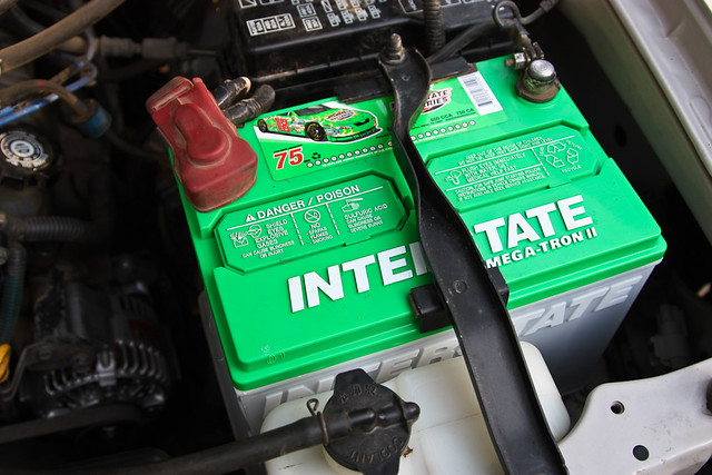

After some power issues on the Whipsaw trail, it was time to replace the alternator. While I was at it, I did the battery. It didnt hurt that I got my battery for dealer cost!
Re-manufactured Toyota alternator. After thinking about doing the Chevy CS-144 Alternator, I decided to stay Toyota seeing as how the original lasted 13 years. I got my friend at the Toyota parts desk to look for something that puts out more than the standard 98 4Runner alternator's 60A at idle. The 99 4runners apparently came with one that puts out 80A at idle, so I ordered one of those.
20110727-IMG_9899 by RickaShay24, on Flickr
The battery is an Interstate MegaTron. 600CCA and 750CA.
20110727-IMG_9894 by RickaShay24, on Flickr
Update on the screen. Now that I have camped 9 days in my truck in the last 2 weeks, I can say that the screen is definetly a nice feature. It needs some work though as the sticky velcro is starting to pull apart from the screen mesh. I think I will get it sewn together. I personally dont ever need my rear window to be open to reach inside of the truck so I am probably going to try and find a more permanent solution where the screen just stays there for good!

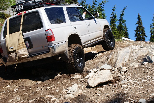

Cool video. I'm sure the info is somewhere, but what are the big cargo bags you've got hanging from the backs of several rigs, including yours above?
Its a "Trasharoo." A spare tire mount trail garbage bag. (or get creative where you mount it like I did if you dont have a spare tire carrier yet...) Our group strongly believes in leaving the trail cleaner than it was when we got there. They have pouches in them for tow straps and other recovery gear to make your frequently used stuff easy to access. They also have a drain at the bottom of the bag so your wet garbage will drain out. Or some people simply use them for storage and will even throw wet clothes in them like wet suites.
