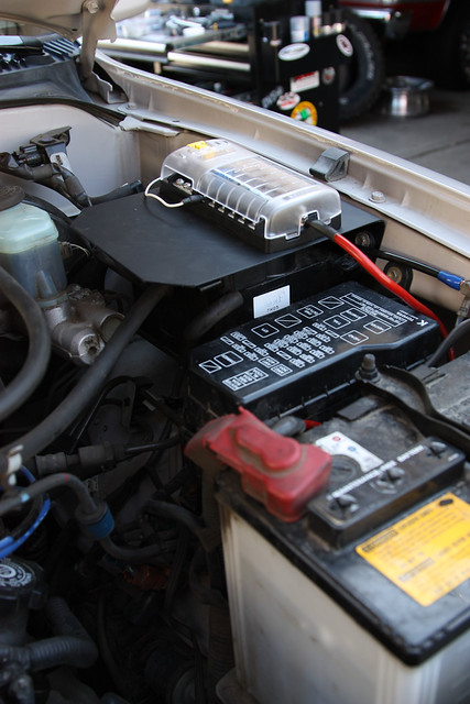

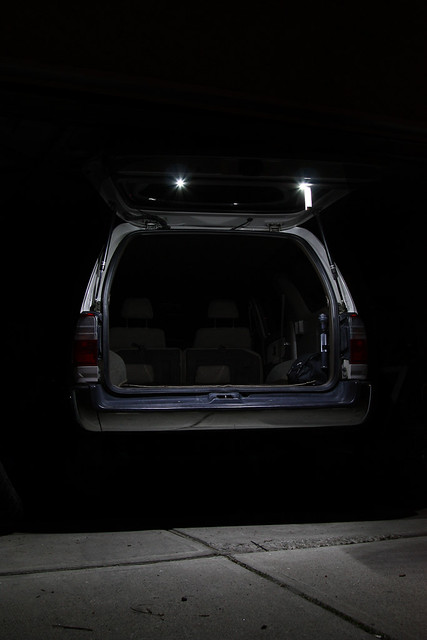

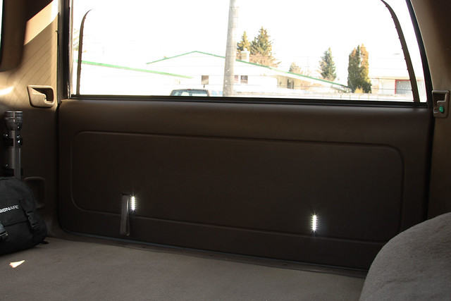

I recently ordered some LED pods from Oznium. I wired them through the rear hatch and placed a switch where the dust cover locks into place. These are going to be awesome for camping as they will provide overhead lighting when the hatch is up and im digging through my gear and interior lighting when I close the hatch and go to sleep in the back of the Runner. I installed my Blue Sea Fuse Block and "custom" mounting panel while I was at it. Have a look:
The LED's are WAY brighter than I imagined they would be!!
Illuminated 2 by RickaShay24, on Flickr
Here you can see the switch on the right.
Illuminated0 by RickaShay24, on Flickr
and the fuse block: Im excited to have some super clean wiring on this build!!
Fuse Block by RickaShay24, on Flickr
And stay tuned.... the KM2's are being mounted on the LC80 wheels as I type....:)
Got my LED's installed today!!
After - LED's

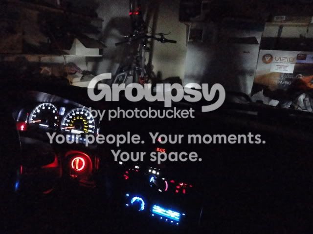

Your LED's look great. Doesn't look like there are any hotspots. At the risk of being an ass and asking for something lots of people have posted, can you post the list of LED's you used and where you got them? I have the same climate control as you and half my lights are out.
Thanks, I got the colour scheme from "GottaBeTRD" haha, the picture he posted below is actually the one that made me think, "hey I want a red/white two-tone LED instruments!"
I ordered this from SuperbrightLEDs:
3 | WLED-x5: 5 LED Wide Angle Wedge Base Bulb| $ 3.94 |
WLED-NW5: Natural White 0.95 (Cluster)
3 | NEOx-x: NEOx LED Instrument bulb | $ 1.29 |
NEO3-R: 3mm NEO3-x Red (A/C, rear window, defrost)
1 | NEOx-x: NEOx LED Instrument bulb | $ 1.29 |
NEO4-R: 4mm NEO4-x Red (don't remember but I used it! its for one of the buttons...)
8 | 74-xHP3: Wedge Base LED bulb | $ 3.49 |
74-RHP3: Red (for the climate control, shifter, and key ring)

Thanks! Yah, I have a Canon Rebel XSi. I have a few lenses but my "fave" and newest lense is my Canon 24-105L f/4. Its WAAAYYYY too nice, seems effortless sometimes!

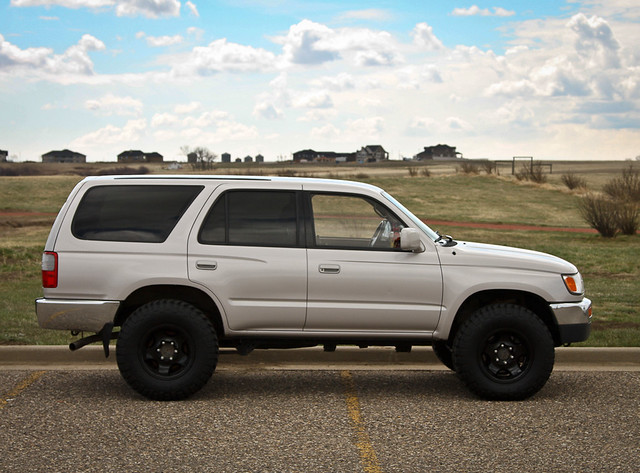

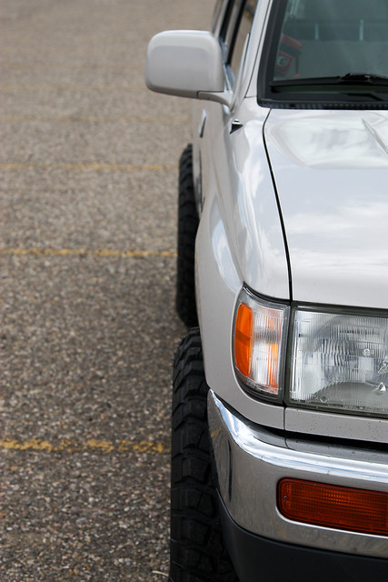

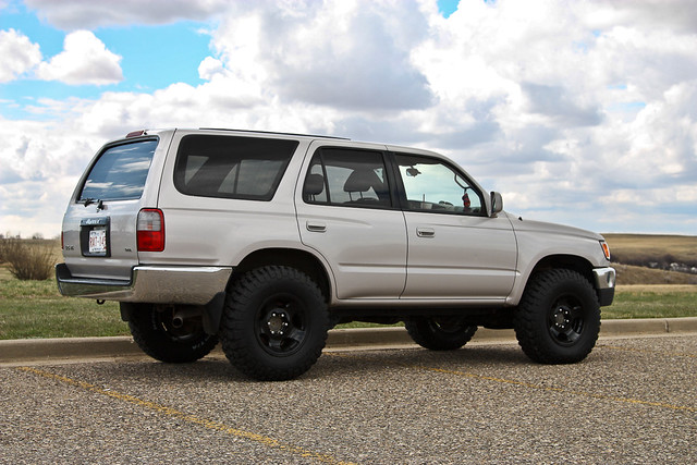

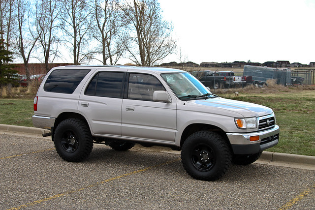

KM2's are on. They look great but i'm worried the tires are gunna have troubles stuffing in the wells due to "no lift" and the more aggressive width/backspacing of the LC80 wheels. Tomorrow when I wake up = poser flex shots to check my clearances..... a lift may be in need sooner than I hoped!!

I flexed out the rear end with my jack and it looks like the tires are going to clear the fenders, but barely. So, do I buy a OME lift (dont want to cause ive alredy spent way too much on this thing this already) or drop $120 and get a 1" bodylift and eliminate my rubbing worries forever??? decisions...
