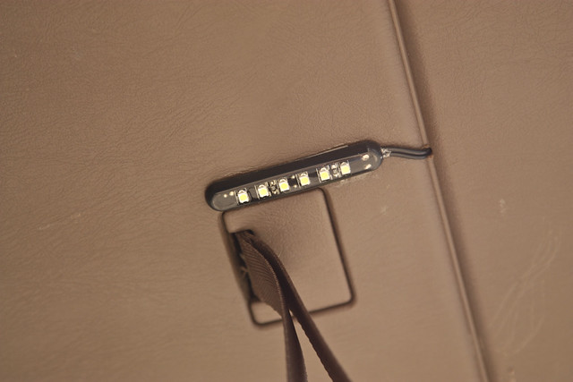

I have been asked several times by a few members to post more details on my rear screen and my rear hatch LED's.
FINALLY, here are some photos:
The LED's are pretty self explanatory but you can see here exactly how I have them installed.
20111002-IMG_0468 by Headlight Hookup, on Flickr

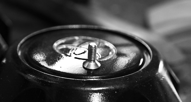

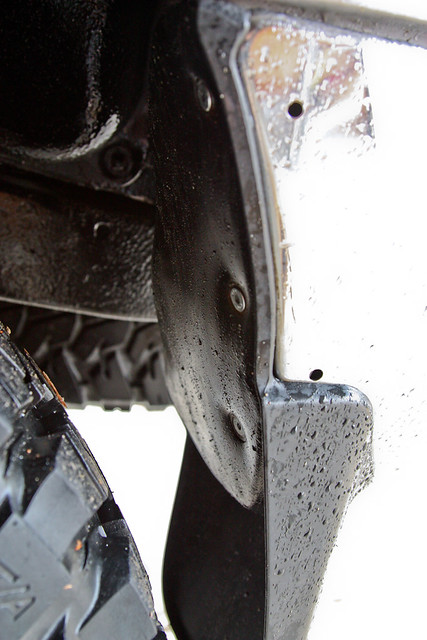

I saw this on BigFish's thread originally. I had been planning on remedying the rubbage in the rear on the mud flap bolts for a while, but seeing it on his thread inspired me to actually get it done. I found these nice countersunk stainless allen bolts at the local bolt/nut store. I wish I had photos before and after but this is actually going to make a HUGE difference offroad, no more terrible sounds and me scared of ripping my tire lugs off on the old square bolt heads.
the bolt:
IMG_0480 by RickaShay24, on Flickr
Flush mounted mud flaps:
IMG_0478 by RickaShay24, on Flickr
IMG_0474 by RickaShay24, on Flickr

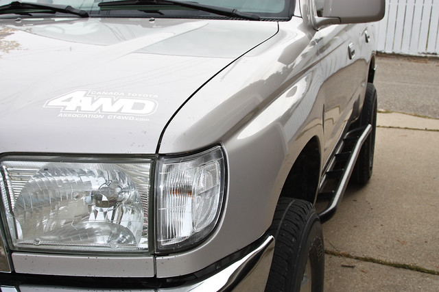

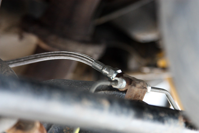

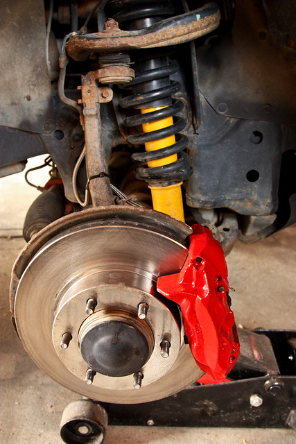

FINALLY got my Tundra 199's installed. New pads, rotors and Crown stainless brake lines front and rear. And if anyone wants to know if the Tacoma Banjo brake lines work on the Tundra's, they do. Just need Tacoma banjo bolts. Im loving the extra stopping power. Only bad thing is they dont clear my LC80 wheels. I had to get a spacer machined to clear them. It is less than a quarter inch in thickness and I may be able to run it without extending the wheel studs but more on that in the spring when I swap ther wheels back over.
Poser:
20111015-IMG_0500 by RickaShay24, on Flickr
Classy as always - Hallmark Autobody shined mine up nice too!

I was able to get my new suspension picked up from the US and installed this past week.
My old setup:
OME 881 (without top-out spacers), OME comfort shocks/OME 890 with the "comfort" rear shocks
Hub-to-wheelwell measurements:
F:21.5"
R:23"
My new setup:

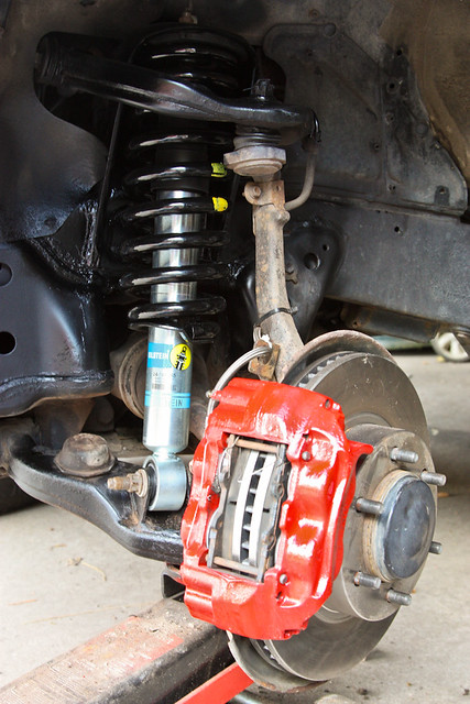

New TRD Tundra coils, Bilstein Tundra 5100's/LC 8 wraps, Tundra Bilstein 5100's
I set the Tundra coils on the 2nd notch -> hoping to get about 2.5-2.75" of lift.
F:23"
R:25"
20111022-IMG_0519 by Headlight Hookup, on Flickr
Here are my CV angles (with Toytech diff. drop) after the fronts were installed:
20111022-IMG_0522 by Headlight Hookup, on Flickr
Here are the 8 Wraps:
20111022-IMG_0521 by Headlight Hookup, on Flickr

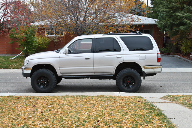

AFTER Stance (Tundra/LC):
20111028-IMG_0524 by Headlight Hookup, on Flickr
YES, the truck is pretty raked but it doesn't look as bad in person. I know that the LC coils take a few weeks to settle and should sit about .5" lower after some use. Right now, the truck has ~1.5" of rake and I'm hoping it will have just over 1" after it all settles. Either way, the rake will be eliminated when the truck is loaded up and used for it's intended purpose: wheeling!

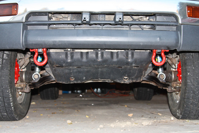

Budbuilt - IFS and Belly Skid! (Christmas come early)
Lotus Development - lower control arm mount skids
