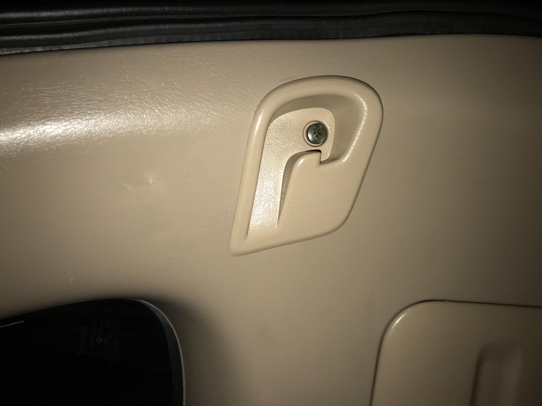

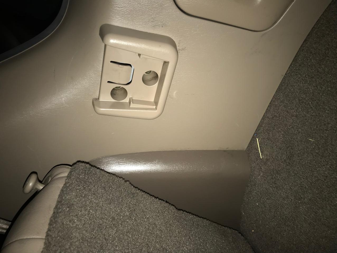

Does anyone know the part#'s for the cargo cover and the brackets?
What is the difference in the brackets?
I apparently have the square one? (pictures of front and back brackets mounted in truck)
can they be switched out for round ones if I find a cargo cover with round ones?

they can be switched out for the ROUND ones very easily....
just two screws and its out... the part where it secures at the back of the vehicle DOES NOT need to be replaced... they are the same...
i've had a pair of round mounts that i would like to go to a good home if you're interested
There's a little more to it than that if you want it to retract.
Yes it's easy to do, There is a spring in each end piece that has to be
wound in the right direction with the correct number of turns for each side.
As you disassemble it just pay attention you will understand how it works.
I did the same this year with mine, took 3 tries to get it right.

Here are the cover p/ns for '99 (the square one):
RETRACTOR SUB-ASSY, TONNEAU COVER
64901-35030-B1 MOON MIST, TRIM1*
64901-35030-E1 MD.OAK, TRIM4*
Unless I'm mistaken, the round ones are stock for the '01 & '02. For some reason, Toyota removed the pull handle on the cover for those years. You just have to grab the edge of the cover itself.
For this reason, I've seen a few later model owners switch to the older version, so they get the pull handle.
Sent from my SM-G900V using Tapatalk
In addition to the pull handle the older version (1996-1999) has the flaps that covers the area between the rear seat and the end of the cargo cover. The older version is superior in every way. As soon as I bought my 2001 I sold the cargo cover. I installed the trapezoid-shaped receiving “sockets” to mount the older style.
