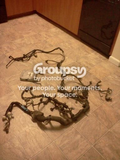

Not much of an update as far as actual progress, but I did find a manual wiring harness and ECU out of a 98 4R from a member here. That will make the confusion of wiring a whole lot easier. But that will also do away with any hopes for using the multi-mode xfer case.

As you can see Im taking my sweet time with this, but today I got my manual harness and ECU!
wiringharness.jpg~original
WOW, sure glad I found my Runner Manual from the get go! That is a ton of stuff to change!
It is a bit of work, but ill be about $750 into the swap when its all said and done, and that's about half what it would cost me to build my auto like I want it. Also, ill be 1 of 2 limited manuals that I know of. All I need to do now is order a clutch and get my buddies together and we can knock this out in an afternoon.
