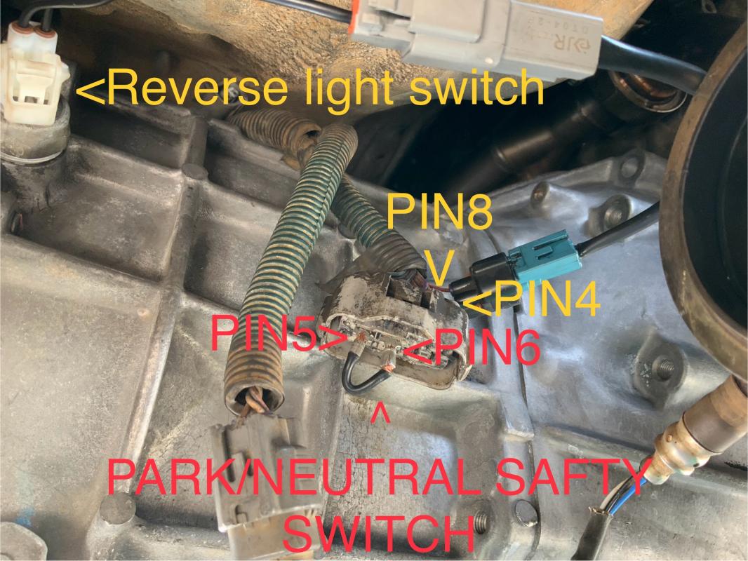

5-Speed Swap Wiring Diagram
Help please
PARK NEUTRAL SAFTY SWITCH= on automatic transmission
CLUTCH DEPRESS SWITCH= on clutch pedal assembly?
CLUTCH START CANCEL SWITCH= on L dash
CLUTCH RELEASE SWITCH= don’t know where this is?
REVERSE LIGHT SWITCH= on manual trans

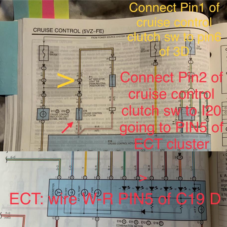

So basically I just want to confirm where the CLUTCH DEPRESS/RELEASE SWITCHES are please. Much Mahaloz in advance.

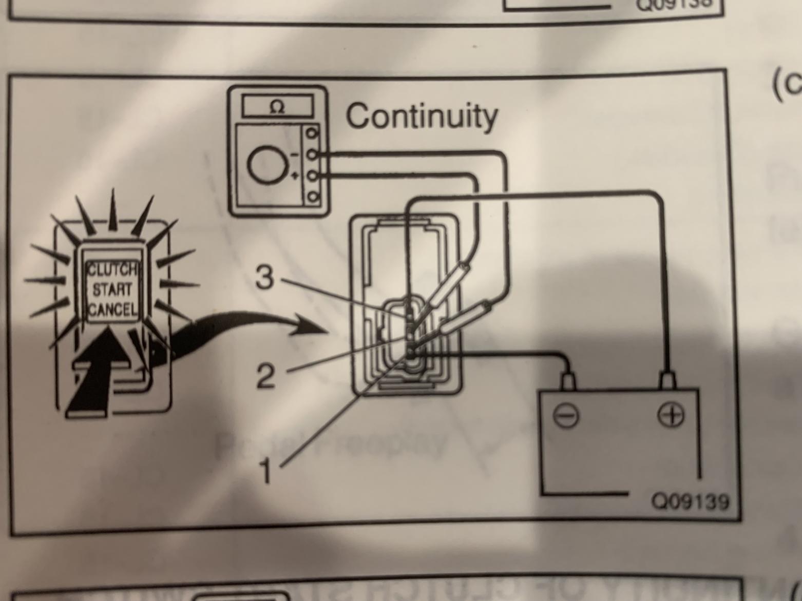

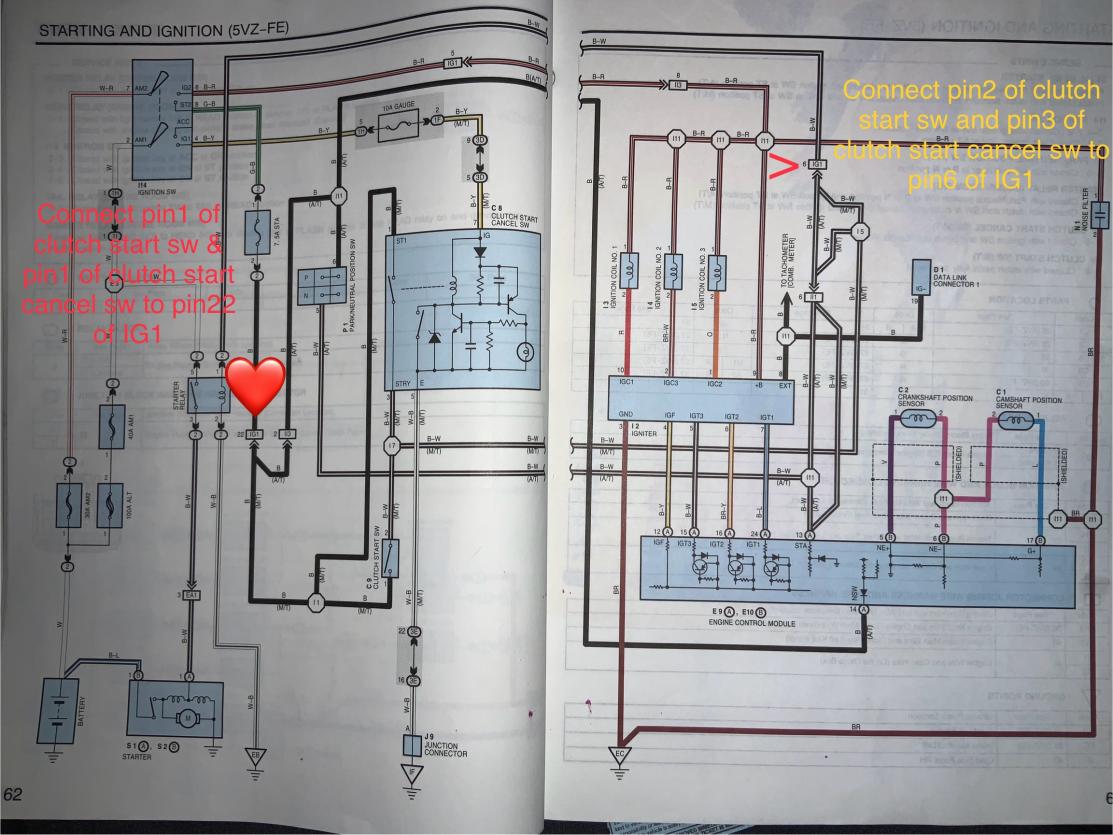

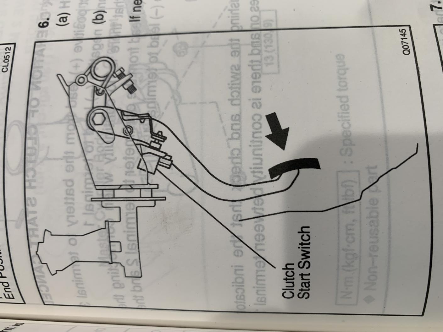

I found it
CLUTCH START SW=CLUTCH DEPRESS SWITCH
CRUISE CONTROL CLUTCH SWITCH=CLUTCH RELEASE SWITCH
Got the answers by looking at my FSM and it turned out the same, just worded differently. Much Mahaloz from Oahu,HI

Clutch Depress Switch: it’s on the clutch pedal assembly, when you press the clutch all the way to the floor, the clutch pedal will engage with a switch allowing the vehicle to start.
Clutch Release Switch: also on the clutch pedal assembly, but the switch is always engaged until you start to push the clutch in. If using cruise control, once the button is disengaged, the cruise control will automatically cancel.

Much Mahaloz . I figured it out after looking at my FSM & EWD. So if I understand you correctly, if I get a small piece of wire and crimp 2 spades on each end of pins 5&6, the truck will start? There’s a guy on YouTube that did the same conversation, but plugged the park/neutral switch on the existing plug to make the truck start. If I can just jump pins 5/6, it would make a cleaner install
I was thinking of this:

[MENTION=105773]busmup808[/MENTION]
You’ll have to confirm with your EWD for your specific model year (I can help with that if you need), but for a 1999 yes just jumping pins 5/6 like you have shown in your photo will allow your ignition to start.
Ewd
The colors and PIN numbers match the same for my 98. I crossed reference everything and it is identical

It will start like that but I would not want to do a final install like that. Understand that all you are doing is grounding the starting circuit. that is what the park/neutral switch and the clutch depress/cancel switch do. If you ground it permanently it will start in any gear at all times. If you do choose to do it that way its better to do it in the body behind the glove box where the engine harness comes through and it is dry. Or better yet take that starting circuit wire and run it to the clutch depress switch or even to just a grounded switch somewhere and then you will have a theft proof vehicle
Mahaloz for the input, but this is just a temporary thing for me to move the truck around. I have a clutch/cancel switch with pigtail coming in next week and the clutch release sw/cruise release sw on the clutch assembly will be wired in correctly. I would never make this my final. I’m taking the wiring further and will be adding the 2HI & 4LO light up in the cluster when engaged. When done, I will post pictures of what I did to complete in detail.

I only have one more wire to connect and that is the wht/red wire to the clutch release switch on the top of the clutch pedal assembly. I installed the blk, blk/wht, & blk/yel wires that I had from a factory wiring harness from when I purchased the truck. I will post pictures of how I did it. It made the wiring a plug & play.

Big Mahaloz to [MENTION=177008]Team_Jake[/MENTION] for the diagram and information needed to make this swap successful. You are much appreciated. It’s been a while since I stepped on a clutch to start a truck, let alone drive it. I think 2008 was the last time. I still have to finish my exhaust and install the front/rear driveshafts. I’ll do that tomorrow.

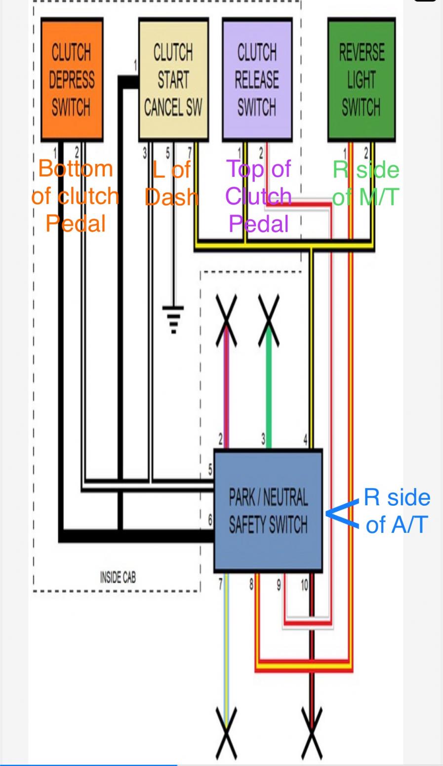

Hey everyone,
I was helping another forum member wire their 5-speed swap, and as a result I created a wiring diagram for them showing how to modify an existing electrical harness, so I figured I would share. This wiring diagram shows each of the wires of the Park/Neutral Safety Switch (from the automatic transmission), and their corresponding locations when swapping in a manual transmission (to include the clutch depress switch, clutch start cancel switch, clutch release switch, and reverse light switch). There already exists a diagram similar to this, but this one includes the clutch start cancel switch, and is more complete by showing the corresponding connectors, pin locations, and a wire color key.
For anyone attempting this swap and modifying their existing wiring harness, all you need to do is cut all the wires just before the Park/Neutral Safety Switch, cap the 4 un-used wires, and lead the remaining wires to the various switches, all shown in the diagram below. This shows everything to have your 4Runner work as if it came from the factory with a 5-speed.
Note: the connectors and wire colors in this diagram are for a 1999 5VZ, other model years or engine codes may be different. If you are attempting this swap, you should refer to the appropriate Electrical Wiring Diagram for details specific to your vehicle.
<a data-flickr-embed="true" href=" " title="9D231C84-88AC-46DD-A26E-6E5EBB38AAC75-Speed Swap Wiring"><img src="https://live.staticflickr.com/65535/53693439242_23f942fa36_c.jpg" width="800" height="669" alt="9D231C84-88AC-46DD-A26E-6E5EBB38AAC75-Speed Swap Wiring"/></a><script async src="//embedr.flickr.com/assets/client-code.js" charset="utf-8"></script>
<a data-flickr-embed="true" href=" " title="2831C632-846B-4010-A6B5-861B52F423B25-Speed Swap Wire Color Key"><img src="https://live.staticflickr.com/65535/53694767005_04006b6363_c.jpg" width="800" height="478" alt="2831C632-846B-4010-A6B5-861B52F423B25-Speed Swap Wire Color Key"/></a><script async src="//embedr.flickr.com/assets/client-code.js" charset="utf-8"></script>
<a data-flickr-embed="true" href=" " title="0634672C-E5D5-4FD2-8534-397F2F990A535-Speed Swap Switch Connector Key"><img src="https://live.staticflickr.com/65535/53694539793_c4c9c591e8_c.jpg" width="292" height="795" alt="0634672C-E5D5-4FD2-8534-397F2F990A535-Speed Swap Switch Connector Key"/></a><script async src="//embedr.flickr.com/assets/client-code.js" charset="utf-8"></script>
A few notes:
  • If you only want your 4Runner to start and run after your swap, all you need to do is jump wires 5 & 6 on the Park/Neutral Safety Switch. Just cut the wires before the switch and tie them together to complete the circuit. Cruise control, clutch start safety, and reverse lights can all be wired later.
  • This diagram has nothing to do with the ECU in your 4Runner. Whether you have an A/T ECU, or the M/T equivalent, you still have to either re-wire according to the diagram above or swap out your wiring harness. Your vehicle will operate the same regardless of whichever ECU you have (the only difference is the Check Engine Light an A/T ECU will throw for not receiving signals from the shift solenoids). If you want (or need) to get rid of your CEL, you must find the appropriate M/T ECU for your 4Runner. Model years 1998 through 2000 have a plug-and-play M/T equivalent ECU, and model years 2001 and 2002 have a plug-and-play M/T equivalent ECU only found in 2003 and 2004 Tacomas. For model years 1996 and 1997, there exists no plug-and-play ECU -- For these model years I suggest swapping the wiring harness (in which case this thread doesn't apply).
  • The transfer case operates completely independently of the transmission. This means no special wiring is necessary to get a multi-mode transfer case, j-shift transfer case, or other transfer case type to work after a 5-speed swap, as long as that transfer case is the one you had before the swap and you are not swapping wiring harnesses. (I had a multi-mode transfer case before my 5-speed swap, and I still have it after my swap -- it operates without issue)

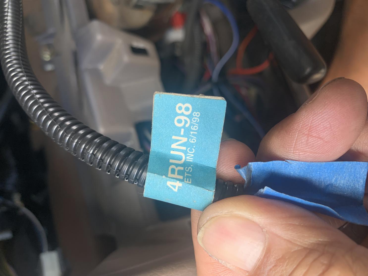

I got a manual ecu and engine harness out of a 98 and I'm putting it in a 2000 can I just use the ecu and keep the auto harness and wire it up or do I need to swap the 98 harness to? Any way to explain the wiring a little better?
'98 has very different wiring through the whole chassis from a '00. Unless you are changing the rest of the chassis wiring, you do not want to put a '98 engine/trans harness in your '00. (to be clear, the engine/trans wiring and connectors are VERY similar - it is the chassis connections that totally change)
You should use the '98 harness as a 'donor' for the trans connectors you need and find a 99/00 MT ECU to run the engine.
-Charlie
