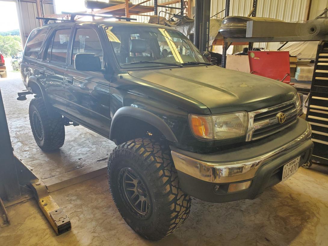

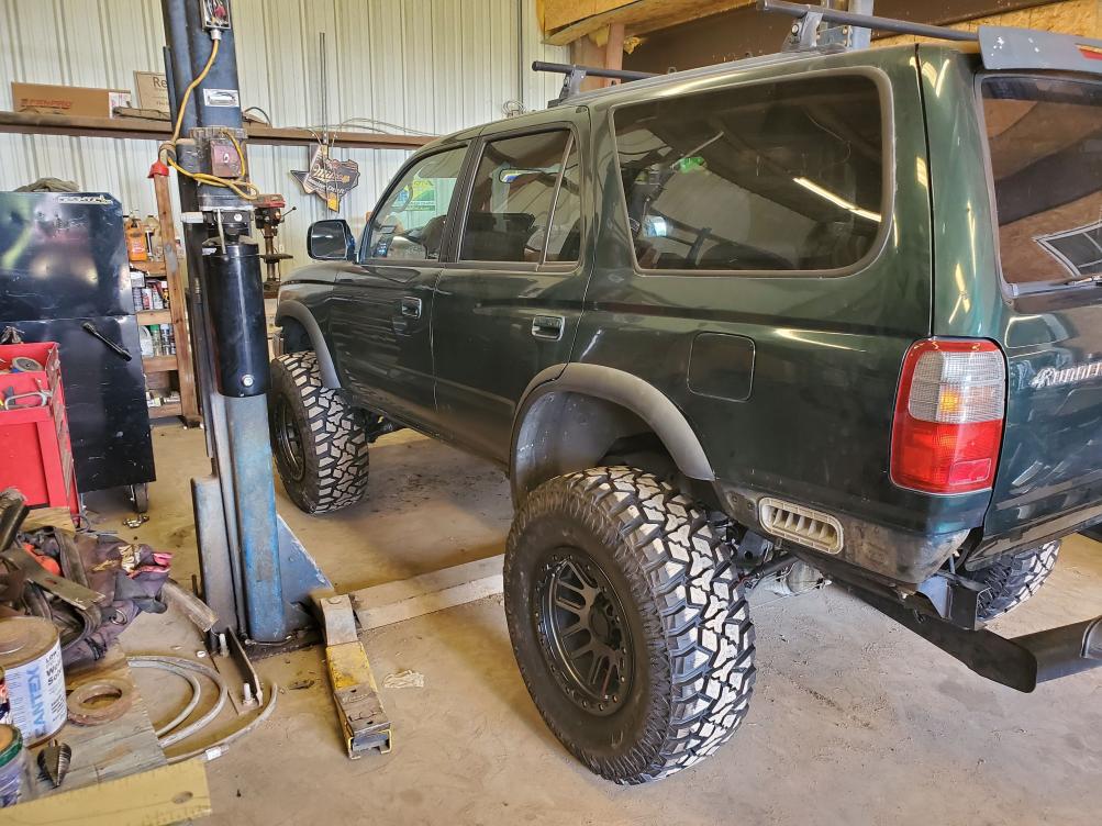

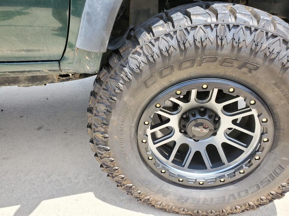

next I knew I wanted to run 35's so I went ahead and ordered them.
17x9 (4" back space) Vision Nemisis wheels and 35x12.5" Cooper Discoverer MTP tires. UPS guy didn't even want to drop them close to my garage and left them out on the street.
I mocked one up to see what I'm in for... :bigok:

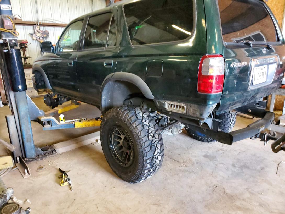

Now to make room I started with a 1.5" body lift from 4crawler. Simple enough...
Also, I wanted to make room early to ensure easy access to bolts and the stupid rear shock upper mounts so I could install my suspension lift with more ease...
And instead of worrying about the rear bumper, I got rid of it until I can build one.

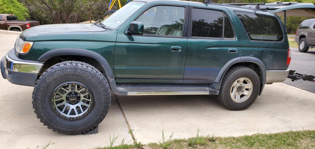

Next I noticed the rear axle seals are leaking...so, 5 hours of watching Toyota time and researching online and I got my axles taken apart and old seals removed. I didn't have a press so I opted to take the axles to a local shop to have them press on the new bearings, etc. However, and I should have insisted or taken it elsewhere, they refused to swap the inner seal ring direction as was suggested. At the time, I thought fine, I'll just not press the new seals in all the way (give or take a mm).
The seals held for 3 wheeling trips but are leaking again...:mad2::frusty::frusty::frusty:

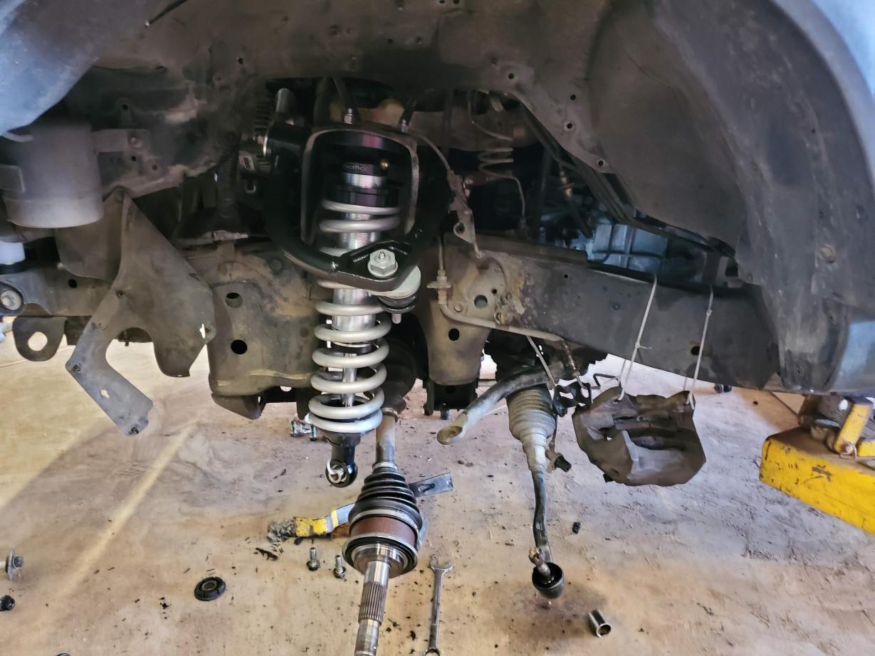

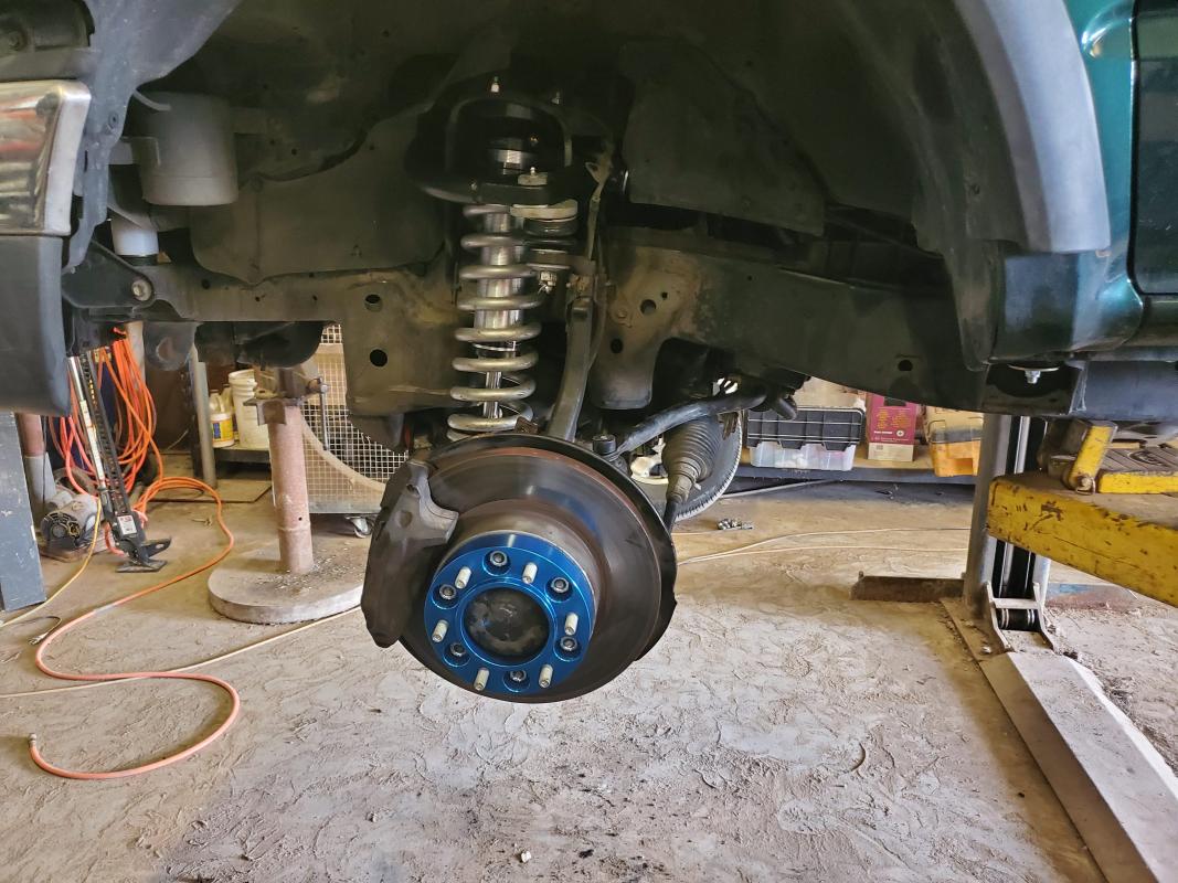

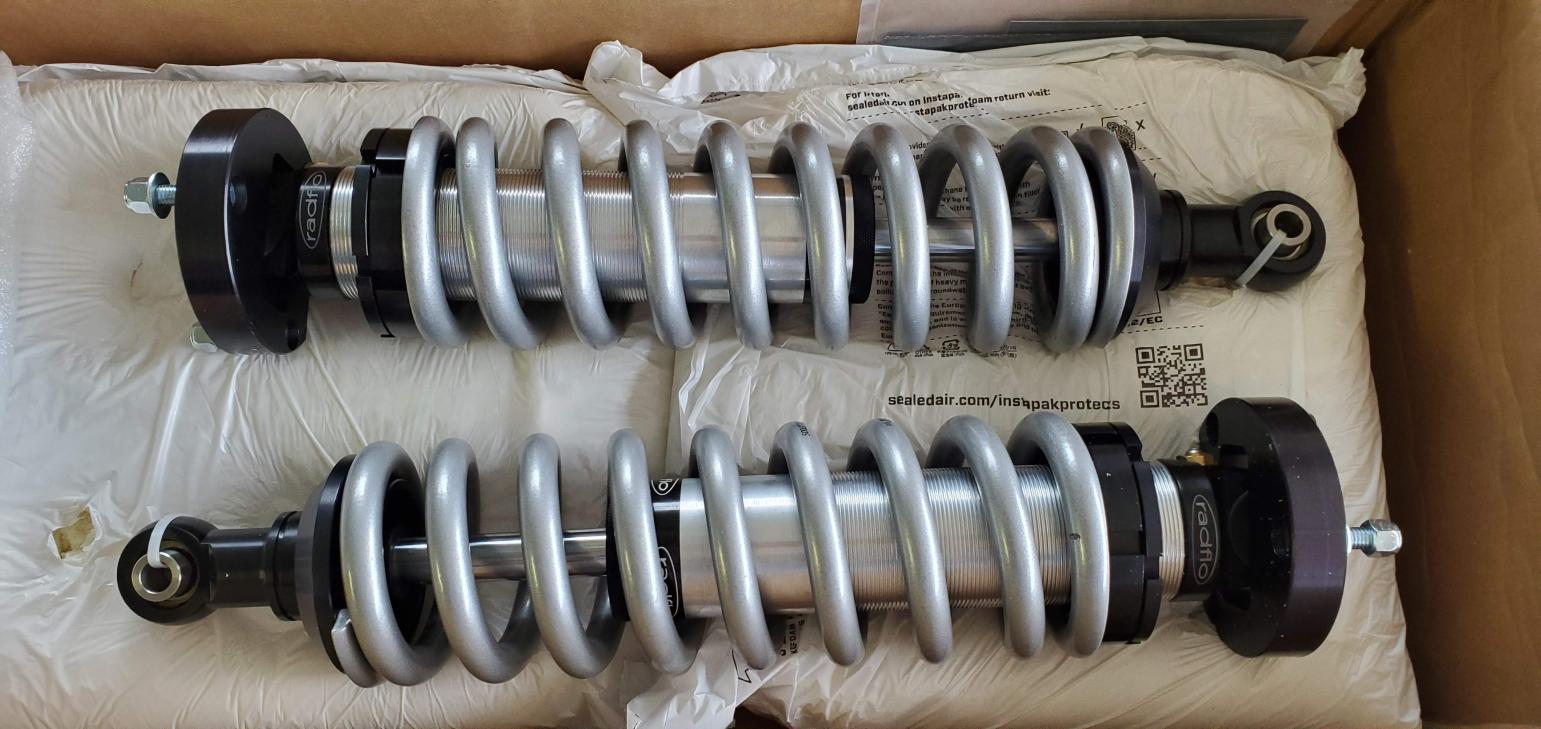

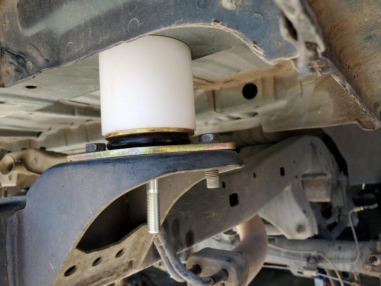

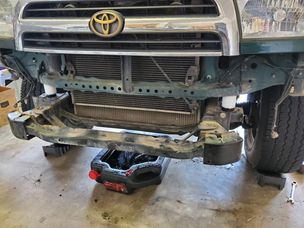

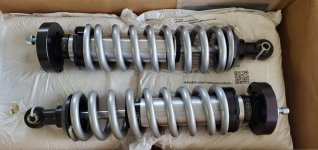

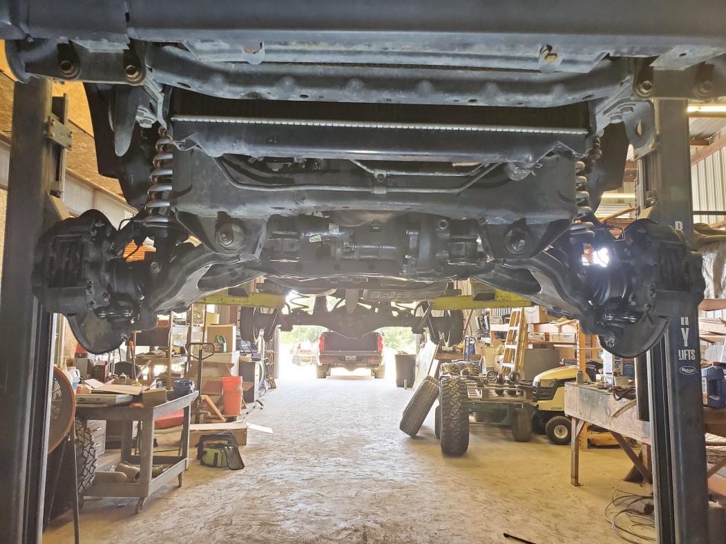

Finally it was time to put the lift on. I got the system1.2 with 2.5" long(er) travel radflo's. While I was in there, I wanted to change out all the other bushings and such so I added:
lower control arm bushings
new OEM lower ball joints
upper arms from SPC
new steering rack bushings from energy suspension
diff mount bushings from DuroBumps
I took the whole 3-day weekend over July 4th and got it all done thanks in large part to using my buddy's shop with two-post lift. I probably raised and lowered 20 times so it was VERY handy!

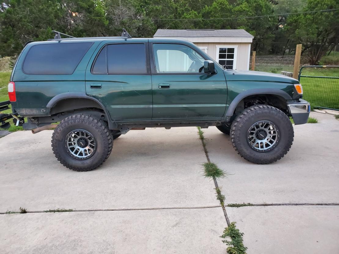

I started with the SPC arms in the C position and that rubbed badly, as you can see. After more tinkering, I set it all the way back at G as recommended in the SPC alignment thread : SPC UCA Alignment Sheets
and set my lower cam bolts to max caster to offset. Took it to Firestone for alignment and it drove great.
Maybe later I'll get those nice lower arms which move the ball joint forward 1" for more caster...

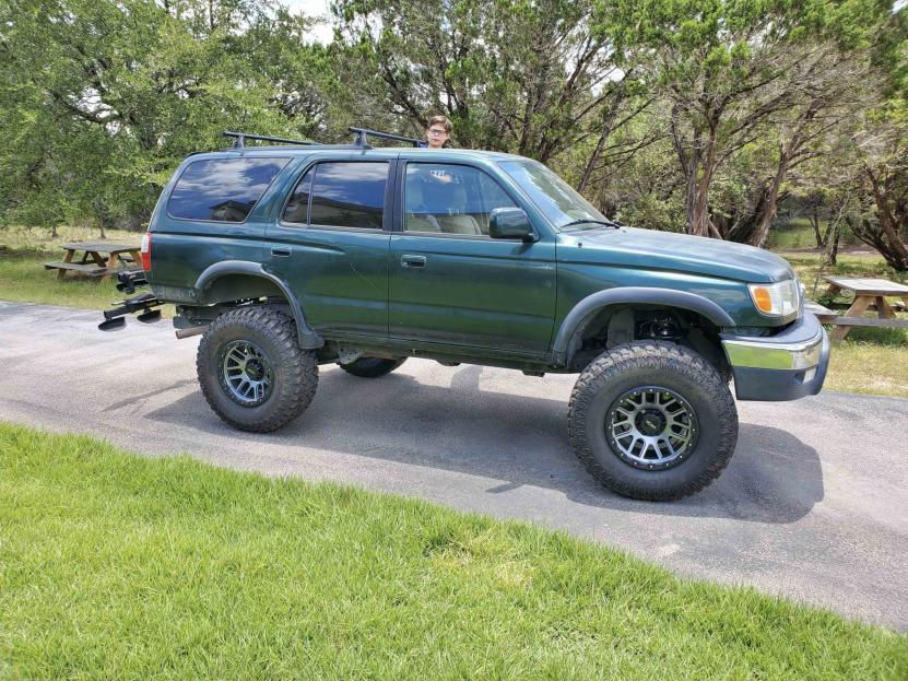

I took it wheeling a few times to a local place here in central texas called Hidden Falls. There's lots of easy-ish trails there and it's great for beginners. Everything was working fine...until it wasn't. See here:

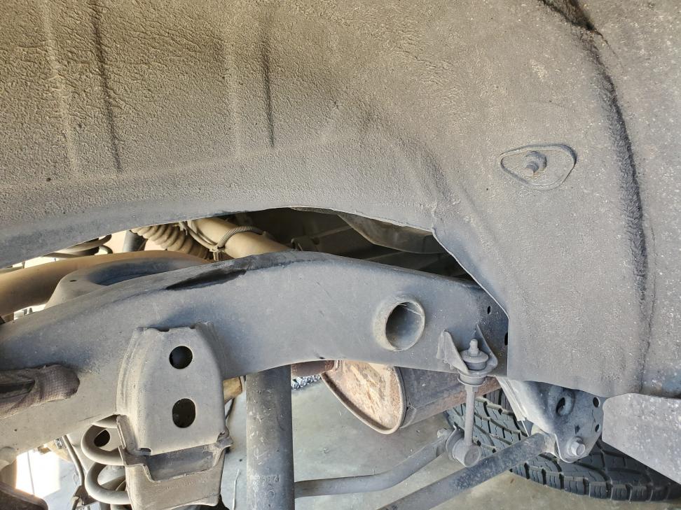

Coolant valve broke / engine overheat
basically the combo of 20 year old plastic, 1.5" body lift, and still some flex from off-roading caused the plastic nipple on the heater control valve to break and I didn't notice it in time. You can check the thread, but I added about a 1" drop down bracket to the heater control valve to keep the hoses from flexing the plastic nipples and eventually causing this valve to break like the original. I would highly recommend for anyone running a body lift to do this, even if you don't have a problem, as it's cheap and easy insurance.
Yea, yea, don't have a body lift and this won't be a problem. I definitely took the easy way out to try and not have a bunch of fender hacking to fit the 35's. Now I paid for it...

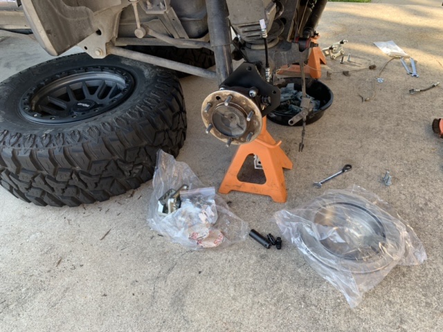

FINALLY, I had time to work on my runner again. This past week I replaced the rear axle seals, bearings, etc, with HUGE thanks to [MENTION=116195]weekendclimber[/MENTION] for the awesome press tool loaner. It turns out at some point, someone had cut off the retainer rings/ABS gear and there were nicks and cuts on the axle. I ended up filling them with JB weld and pressing the new retainers and ABS gear on while it was setting. At this point, if I have to do the seals again, I'm going with a new axle, what a pain!

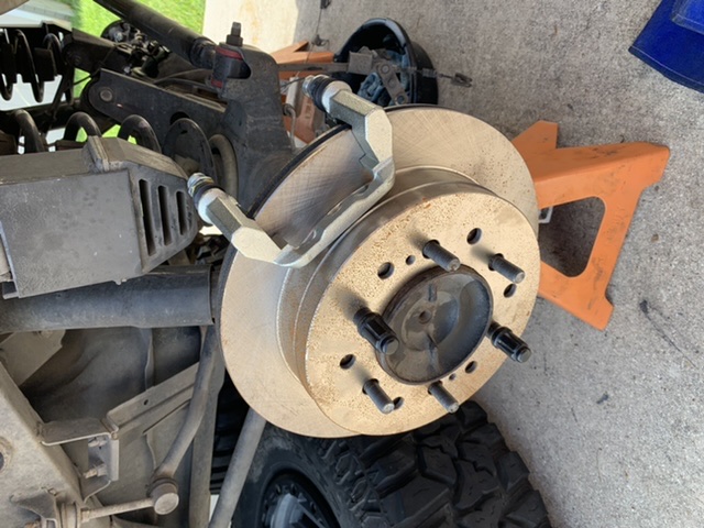

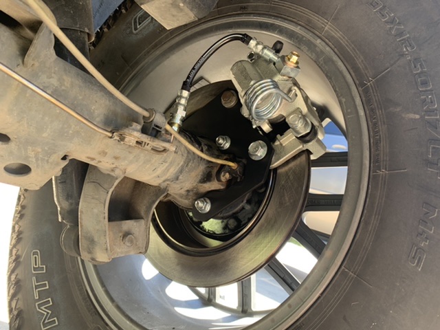

Also, I started the rear disk brake conversion. I have a bunch of 3/8" steel left over from my bumper work and will be making my own brackets using a plasma cutter (and drill press). For the conversion, I got all the parts from rock auto and ordered the e-brake and caliper flex hoses from [MENTION=118207]midcoma[/MENTION] . Here's the parts I used:
<HTML>
<table cellpadding = "5" cellspacing = "5"><tr><td> </td><th>Part Number</td><th>Part Type</td><th>Price EA</td><th>Core EA</td><th>Quantity</td><th>Total</td></tr>
<tr><td colspan="7">2003 TOYOTA 4RUNNER 4.7L V8</td></tr>
<tr><td>CENTRIC</td><td>12144128 (121.44128)</td><td>Rotor</td><td>$ 17.67</td><td>$ 0.00</td><td>2</td><td>$ 35.34</td></tr>
<tr><td colspan="7">2000 FORD MUSTANG 5.4L V8</td></tr>
<tr><td>ACDELCO</td><td>18K2410</td><td>Brake Bleeder</td><td>$ 2.86</td><td>$ 0.00</td><td>1</td><td>$ 2.86</td></tr>
<tr><td>BENDIX</td><td>SBC627A</td><td>Brake Pad</td><td>$ 17.28</td><td>$ 0.00</td><td>1</td><td>$ 17.28</td></tr>
<tr><td>POWER STOP</td><td>L4825A</td><td>Caliper</td><td>$ 54.79</td><td>$ 27.48</td><td>1</td><td>$ 82.27</td></tr>
<tr><td>POWER STOP</td><td>L4824A</td><td>Caliper</td><td>$ 54.79</td><td>$ 27.48</td><td>1</td><td>$ 82.27</td></tr>
<tr><td>Shipping</td><td colspan="5">Ground</td><td>$ 34.97</td></tr>
<tr><td>Tax</td><td colspan="5"> </td><td>$ 20.40</td></tr>
<tr><td>Order Total</td><td colspan="5"> </td><td>$ 275.39</td></tr></table></HTML>
the bleeders were just in case and are cheap for a pack of 10 so why not. Pads are bendix organic and hopefully will be OK, I'm not looking to lock up the rear tires or anything. Looking forward to getting this all together, hopefully by next weekend, and get back out on the trails.

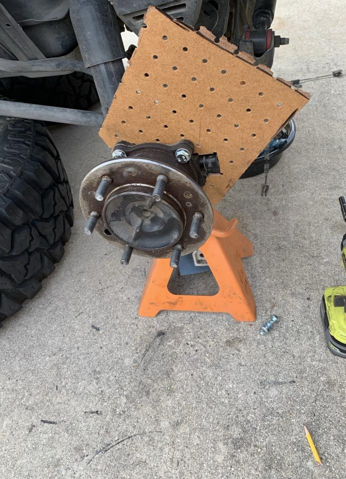

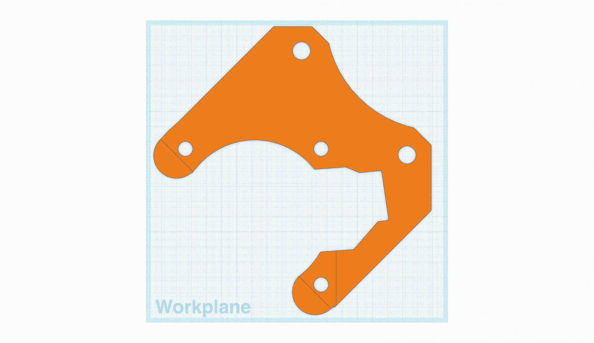

so that peg-board was a bad choice for template, too easy to break. Work was slow and it was very rainy here so I tried to create my own template on tinker cad. I wanted the calipers oriented around 45 degrees to make bleeding easy (in theory) rather than almost vertical as I have in the above picture. Here's what I drew up. For some reason, I couldn't upload the PNG format so compressed jpg it is for now. PM if anyone wants the original PNG, or SVG files for direct printing. I'm planning on cutting this out of sheet metal to test and adjust from there before plasma cutting out of 3/8" steel and figuring out the offsets needed for the spacers.

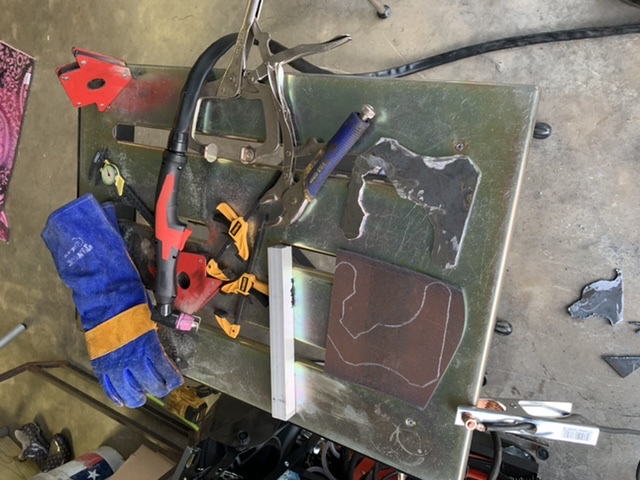

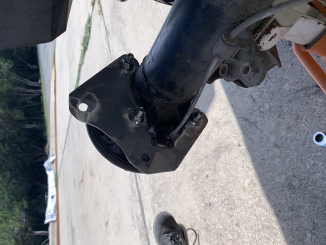

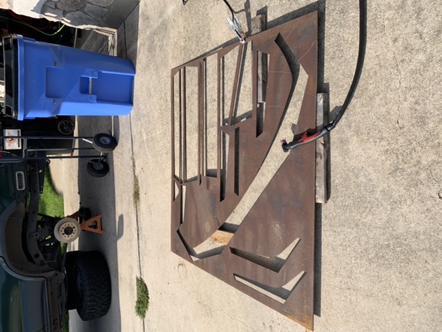

Getting closer on the brake caliper brackets. Today I printed the template and traced it onto thin sheet metal first and cut that out to test fit. You can see how the caliper bracket is sitting 2mm higher in the front than in the rear hence the pads are not straight on the rotor. I'll adjust by changing the drilled holes for the caliper bracket in the real adapter plates.
You can see I have *just* enough scrap steel for the brackets. Otherwise I got one cut today, plasma is messy on the opposite end of the cut and you have to grind off all the slag which takes a while and is my least favorite part of plasma cutting. Hopefully tomorrow I can get everything mounted up and maybe have time to bleed the brakes, add gear oil after the new seals, and give it a drive. E-brake will be installed later for sure.

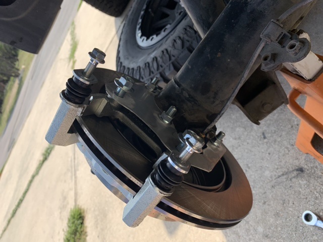

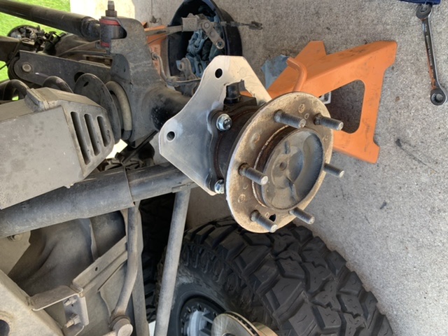

Finished the "real" brackets today and painted them. Unfortunately, I tried to adjust for the pads not being lined up and ended up having to drill out one of the caliper bolts a little extra to be able to thread the bolt in :frusty::doh: Hopefully not too big a deal as I see others have had to do this as well. We'll see how it holds up. I also didn't realize the calipers didn't come with banjo bolts so another trip to the parts store to get them and I think I'm all set now. Ran out of time to finish putting everything together today but hopefully I can finish and go for a test drive tomorrow. Then it's on to the e-brake setup, at least there, I was smarter and bought the kit from [MENTION=118207]midcoma[/MENTION] ...

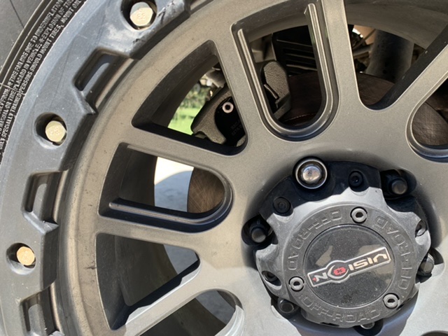

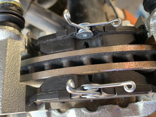

I got so excited putting it all together last night I forgot to take pics. But the brakes are done and it stops well enough :frog:
I'm going to drive it a bit to let the brakes settle in before bleeding again. The pedal isn't terrible but it's not great either. It's not diving in the front under breaking so I'd call that good (enough). Personally, I despise drum brakes and do not enjoy working on them, so to me, this is an improvement. I would not recommend doing this for any other reason than ease of future maintenance and only if you don't know how or like working on drum brakes. The drum brakes on our cars are plenty sufficient for the car.
Anyway, a few pics of the finished work and onto the e-brakes...
