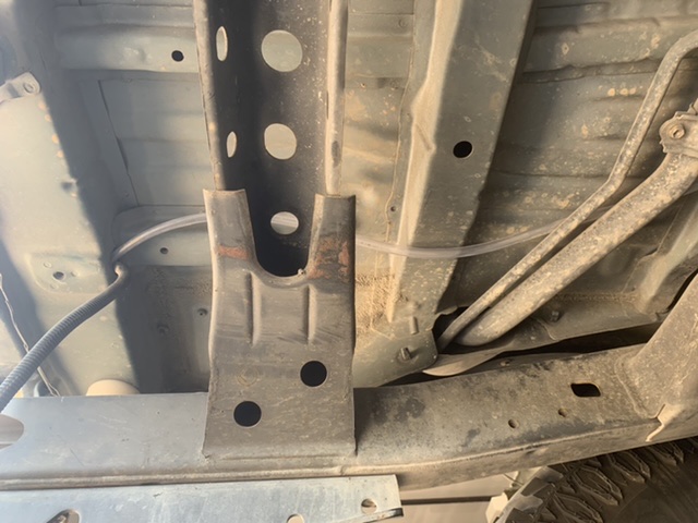

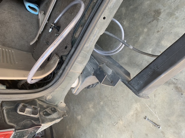

Got the extended breather done but I picked a different spot to extend the tube up into. Since I removed my spare in prep for the f150 gas tank anyway, I had plenty of space in the back and chose to push the tube up into the driver quarter panel, pushing through the factory gromit for the trailer wiring.

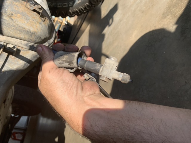

Also started the e-brake using the kit from midcoma. See last picture, what are others doing with thhe axle end?.I can't seem to get the block that pivots I'm the OEM cable off. Should I cut the cable up higher?

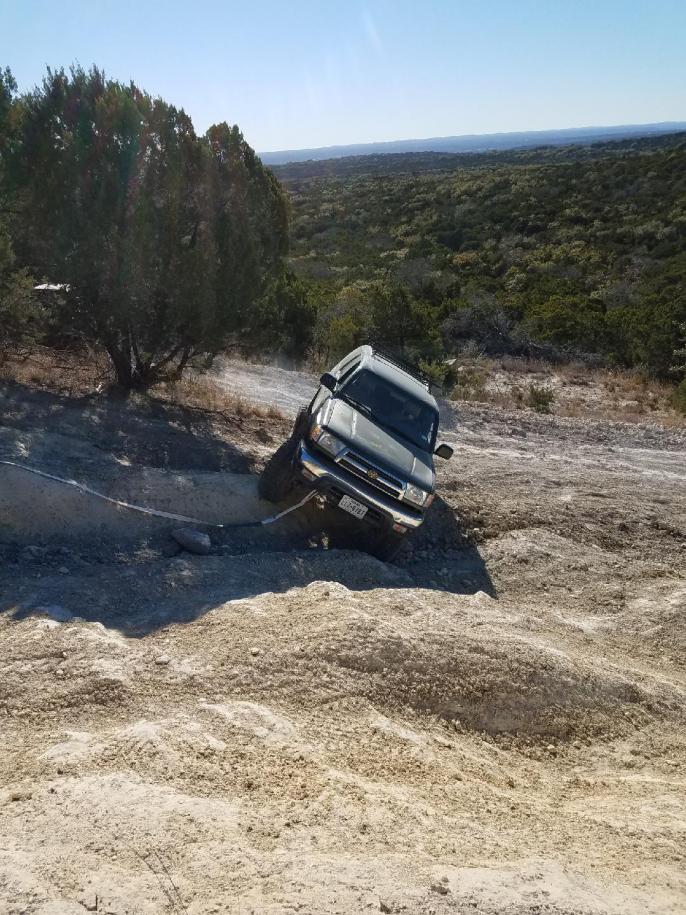

Well, I got a little crooked today and definitely broke something backing off this fun looking angle. It almost feels like a chipped ring gear tooth as the clunk is cyclical but I can still move under power forward and reverse. Nothing looks broken from the outside or underneath but the clunking makes me want to come back in the morning with a trailer. Anyone broke a tooth before and can describe what it sounds like or feels like?

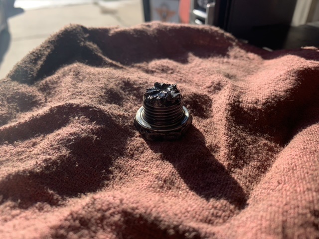

Drained the rear differential fluid and confirmed. All sorts of metal goodies on the he plug. Time to upgrade...

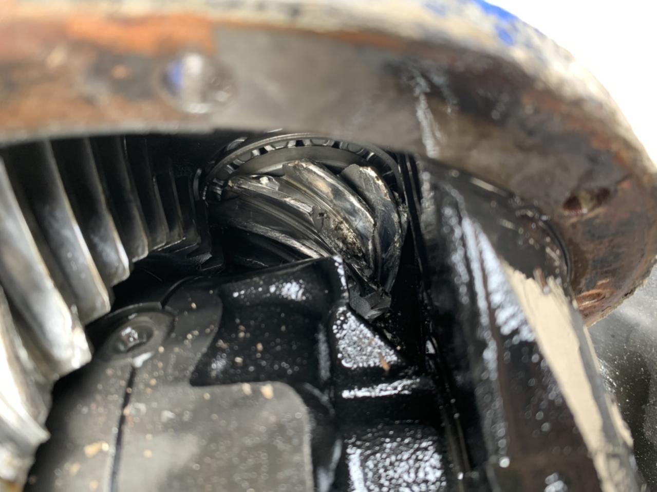

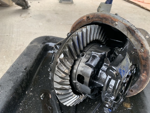

Confirmed the damage today, 3 ring teeth and one pinion tooth sheered clean off. I'm looking at upgrades, looks like Toyota has a 4.56 ratio with e-locker possible. Has anyone been able to locate a 4.56 axle or even just the differential? I'd get the front to match as well of course. Unfortunately all the salvage yards near me have the diffs already taken out of all 4runners and tacos or they were 3.9 ratio rather than the 4.1 to match my front.
