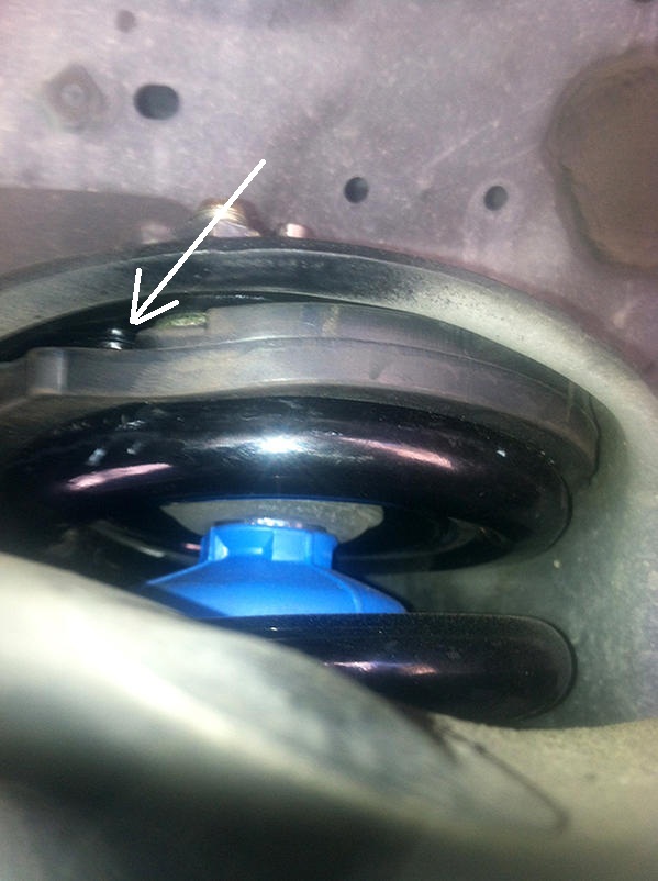

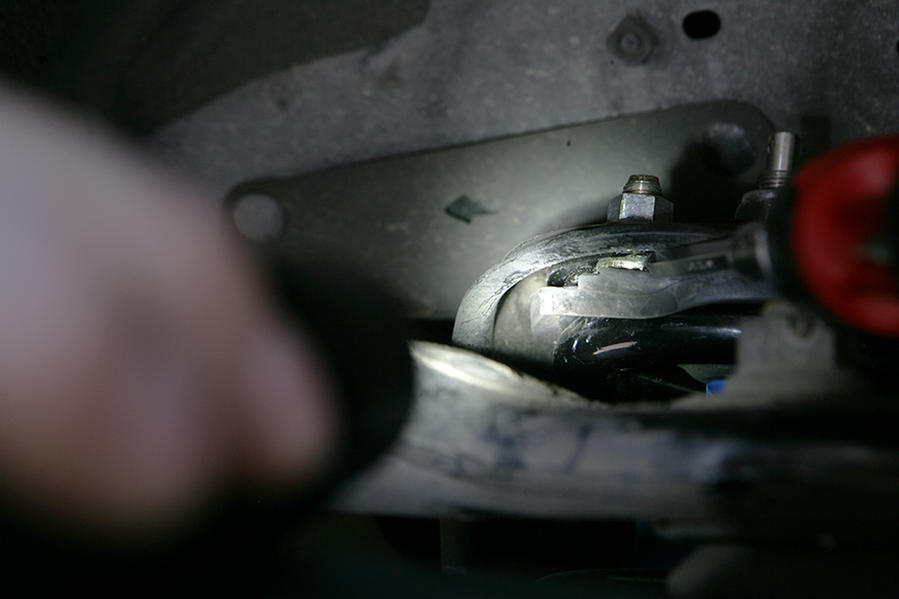

This is what A.Wilson was talking about . . .
There shouldnt be any metal between the rubber top plate and the mounting spot on the a arm. The rubber top plate should be pressed against it. I dont know what the metal piece is, but it shouldnt be there.

I took a closer look at the area you specified with the arrow. Kinda difficult to tell even with a flash light and screwdriver I'm afraid. It look's to be a reflection from the camera flash. I don't see any metal nuts etc, but I do see some raised bumps that would also catch reflection from the flash. I just took the truck on the freeway and it's kinda scary and unpredictable at the moment a sort of Noah's arch if you get my drift. In any event, I think the first step is to put the OEM top plates back on and then remeasure and test drive. I also know that the HD struts are slightly longer than the stock struts and on the box it says 0 - 1" lift. Maybe if I reinstall the OEM front springs with the new Billys it will give me the same lift as the back, although I'm guessing not?

I'd take those fronts apart again, reflection or not, it appears "something is in there under the strut tower which would indeed cause a nose high effect. The studs for the top plate do appear to be all the way through by looking at the number of threads showing but the top plate itself should be sitting much flatter in the tower.
Also, the front struts have a very slight curve to the lower mount. If they happen to be on backwards, that would also push the front end up slightly.
Can you take a picture of the lower strut mount and also a better picture of the spring perch? Specifically where the spring stops in the perch? I'm betting this is an east fix. And I wouldn't recommend you go with any spacers at all if you want the truck to feel more predictable. You certainly don't need them to clear the tires you'll be running.

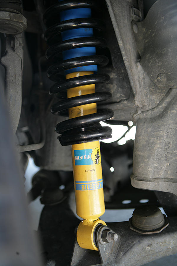

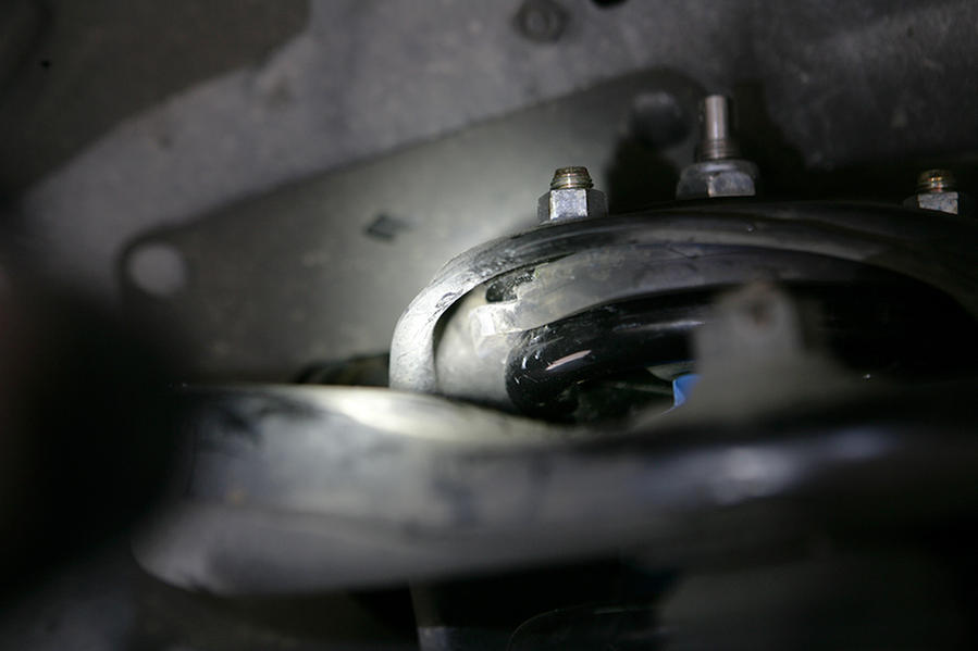

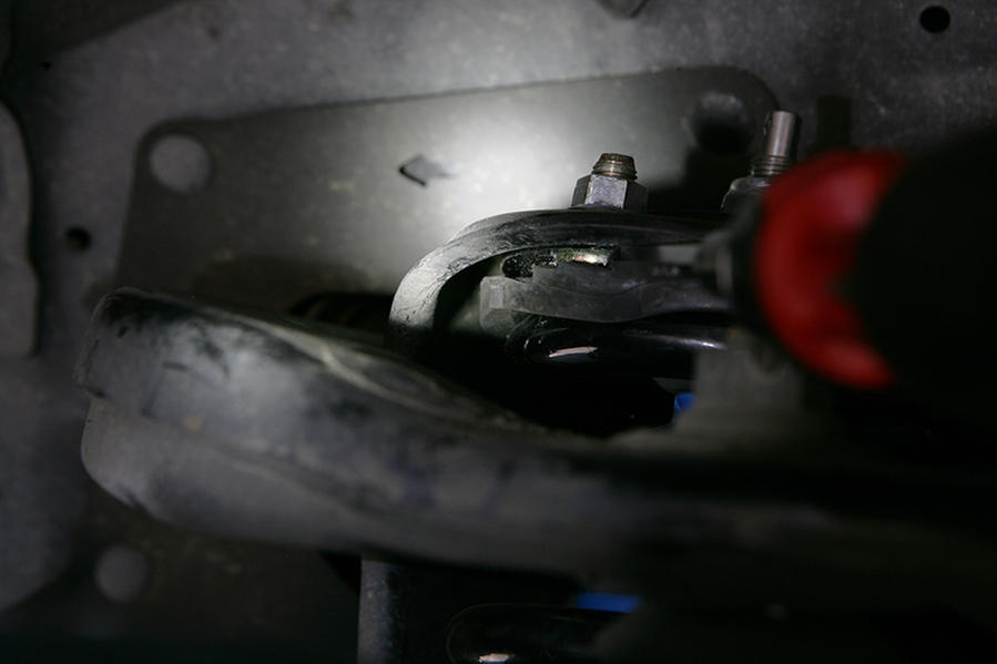

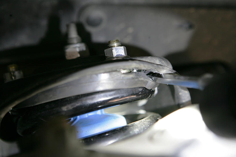

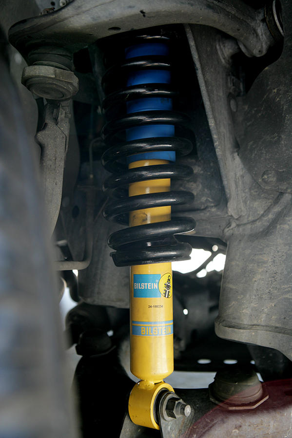

I appreciate the feed back, time to get serious and break out my work camera for some clear shots - more soon.
strut images
More images as requested. Let me know your thoughts.

Hmm, looks okay in those pics. Springs are seated properly. Hard to tell but looks like the shocks are oriented correctly.
