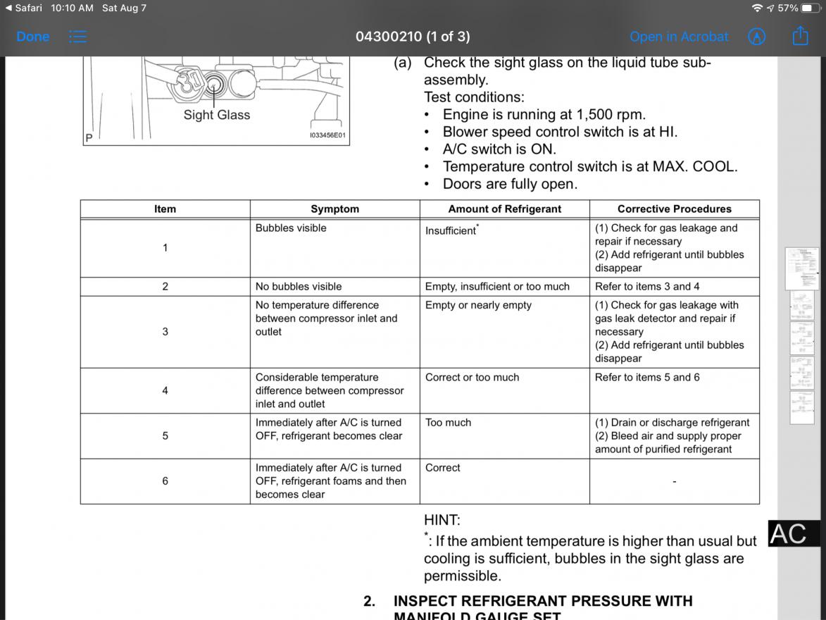

Use the sight glass.
How? Sure would be nice if you explained yourself. :)
You can add too much or too little and still not run right. The sight glass gives you the correct volume after putting in the weight prescribed by the FSM. Which is where you can find this page. You want #6
