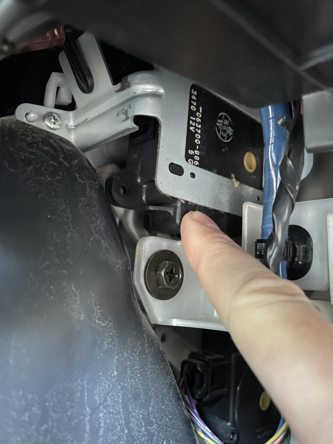

This^^^!!! It’s actually even simpler than that, if you are getting clicking behind your glove box from your ac blend door actuator servo, try this 2 minute free and tool-less fix before you take anything apart or start ordering new servos:
Just remove the glovebox and push your finger against the visible corner of the black servo to the left of the cabin air filter door. Just give it a little tap! I had my car on with the servo clicking and as I pushed on that corner the clicking stopped and suddenly switching between defrost and face and feet became smooth and quiet. It’s worth a try if you have been wanting to fix this.
