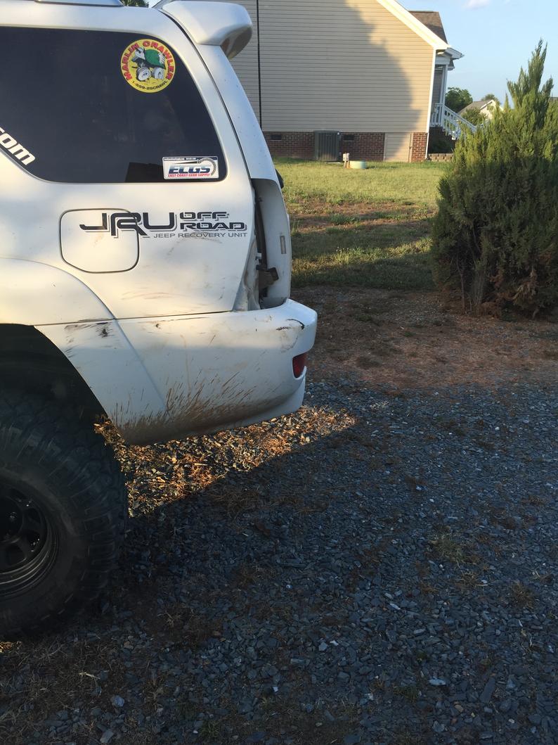

Took the 4runner out wheeling this past weekend on a camping trip with the wife and some friends. Didn't manage to get many pics without boddy and lisa there :noidea: Lost the driver side tail light... again... (3rd time) to another tree lol! In other news I have two passenger side spare depo black bezel tail lights. If anyone needs one..
just spend the afternoon reading through your build and i gotta say, nice work! i have been starting to cruse the 4th gen section recently as i just bought a GX a couple months ago and am going to start slowly modding it. i am interested in your take on the radflos and the 650 coils... any issues ect? keep up the good work man!
Thanks, I've injoyed the radflos and 650 coils really well. They definitely soak up the harsh bouncing from the boulders Uhwaries trails offer so much of. It's a toss up. I think I would be happy with the 700lb coils as well. . Sorry to get back to this so late I haven't really kept up with this thread in a while.

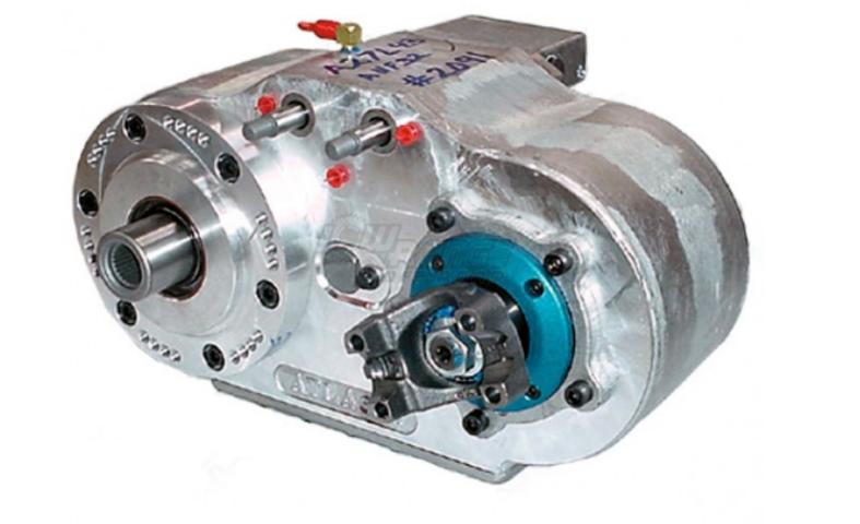

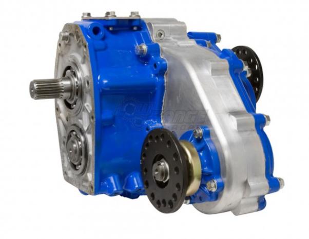

planning to source a T-case w/ actuator through a pull a part location. Seeing prices at 600-750. I'm interested in manual t-case options though. Wouldn't mind just having 2wd at times in the V8. Problem is I'm unsure of what Christmas tree light effects this might have on the Gauge cluster. Anyone have any input on aftermarket T-cases? I've seen a couple here an there, modded on the 4th gens but finding detailed info on the them is nearly impossible.
Well from what I can gather, switching to a manual t-case in the v8 is actually simple.. Go figure, for once having the V8 is a plus..
so if you have a V6 you have the front axle with The ADD, disconnects the front axle and then has the TC computer lock the center diff to allow 2wd. If you swapped to a manual t-case in this situation you would have to install a switch that would allow you to manually activate the ADD. forcing you to come to a stop to switch into 4wd. (the ECU clocks the rpm of everything allowing this shift on the fly with the electronic t-cases)
With the V8 having the awd setup, adding the manual t-case just takes away the all wheel drive torsen ability. You either get 2wd (100% rear) or 4wd (50% front/rear) . I've seen some negetive takes on this with driving in ice or snow. But come on..
Soooooo
That leaves me with two choices.
Good ol Marlin/inchworm "lefty"
or the Tried and true, awesome yet expensive Atlas
Pricing a brand new t-case from toyota with actuator installed is roughly $2k
lefty with adaptor plate ready to bolt on roughly $2500
Atlas with adaptor plates plus fab work: $3500+
Doing some more research before I drop the hammer but I'm leaning on the lefty, as its pretty much bolt on ready. The atlas would require some cross member fab and an extra thousand bucks. but hey WWAD right!?!?
Either way this lines me up perfectly for SAS down the road :banana::banana:
