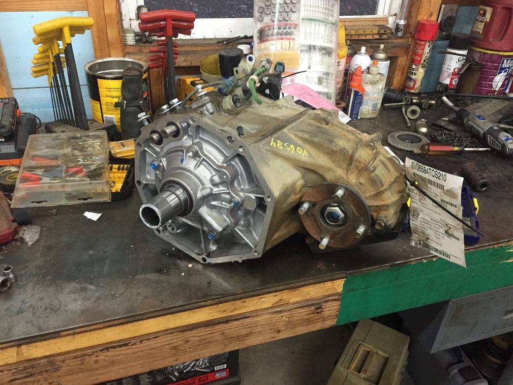

well the tcase I found on ebay for 275 was a bust, they wanted almost the same price for the shipping.
Got on Car-parts.com and found one for 325, 91 miles away. emailed about a quote and found they have free shipping plus its LKQ rated. Also switched up to one thats pre-new 4runner era so it definitely has the worm gear (07 fj).
Waitin on them to send me some pictures of the case before I pull the trigger but I dont expect any issues.
I've felt like a kid on christmas getting all this worked out, and its just a simple tcase kind of funny.

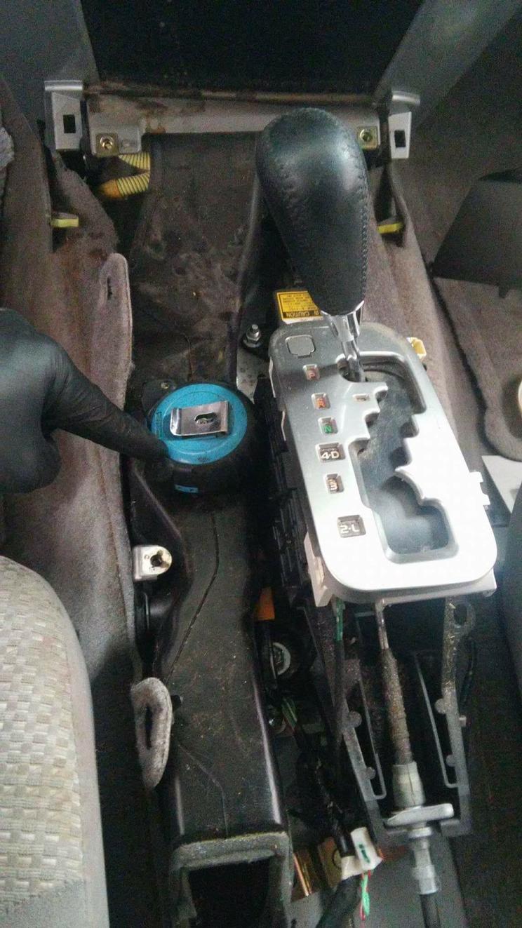

For people who are also looking into this mod or want to see where the levers would go. The blue tape measure is sitting on top of the AC duct to the rear.
Does that only supply the vents in the middle console into the back, or does it also supply the air coming under the seats for peoples toes?
Ah the first obstacle, thats a bummer. That would be the duct that feeds the back side of the console. Wonder if others have just 86'd it or what.

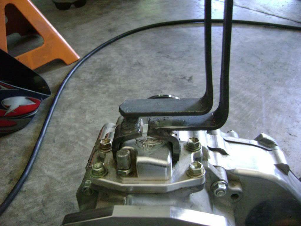

We are planning on doing something like this. Above the lever boot you won't see that the levers have been modified. I think this plus notching the AC duct will fix the problem. My small kids like the rear AC.
I was hoping there might be enough rough to notch it an maybe just restrict a little flow. Looking Crozhawks build, in the pics with his levers installed it doesnt look like he put the duct back in.
If notching didn't work you could possibly transition from the front end of the duct, into hoses. Rout the hoses around the shifters, then transistion them back into the rear section to mate back with the console properly.
the sticks we got, will they be able to be bent into place or are we looking at cutting an welding?
Idk it's all just theories right now. Wyatt says rear AC is lost on the ones he has swapped. That's why I'm hoping one of us figures out a solution. If not I'm sure the half doors I'm dreaming of doing this winter will keep the kids cool.
