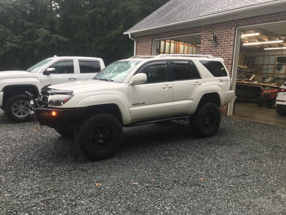

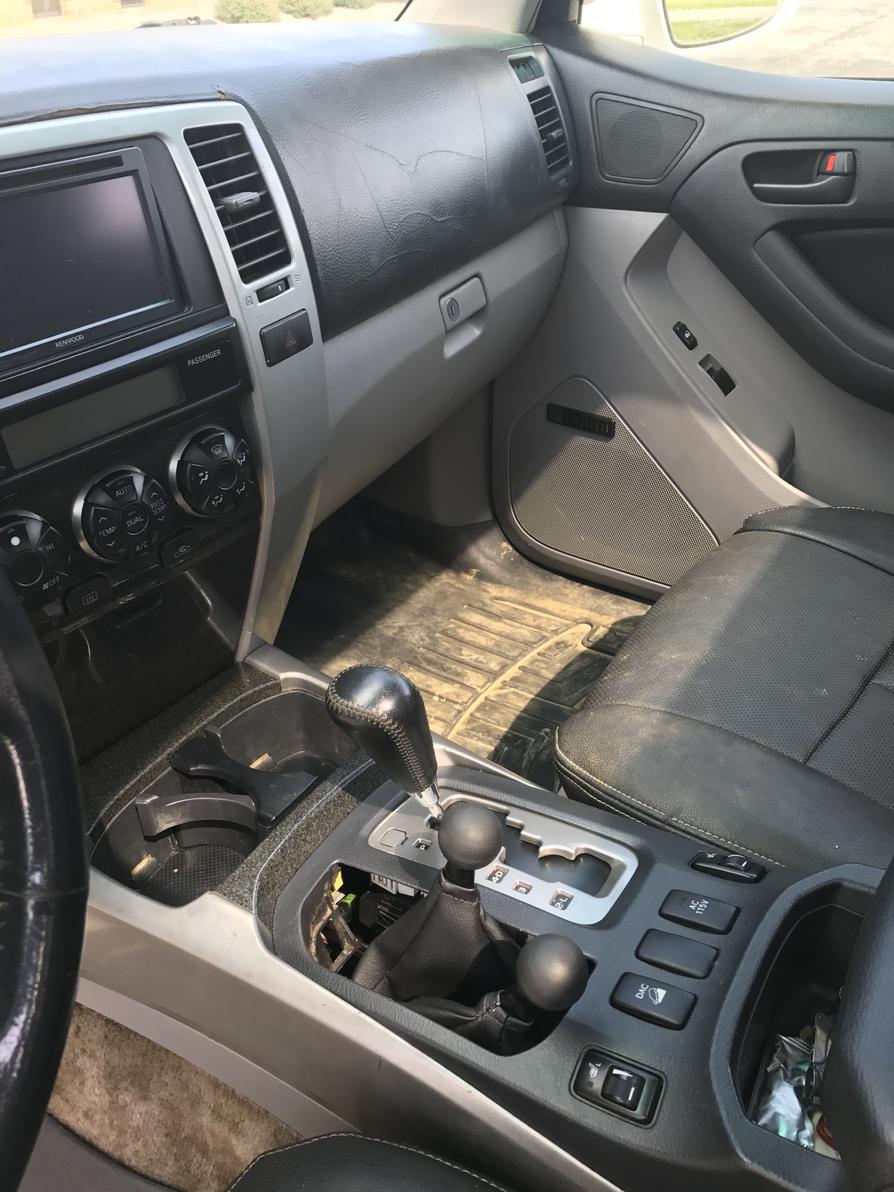

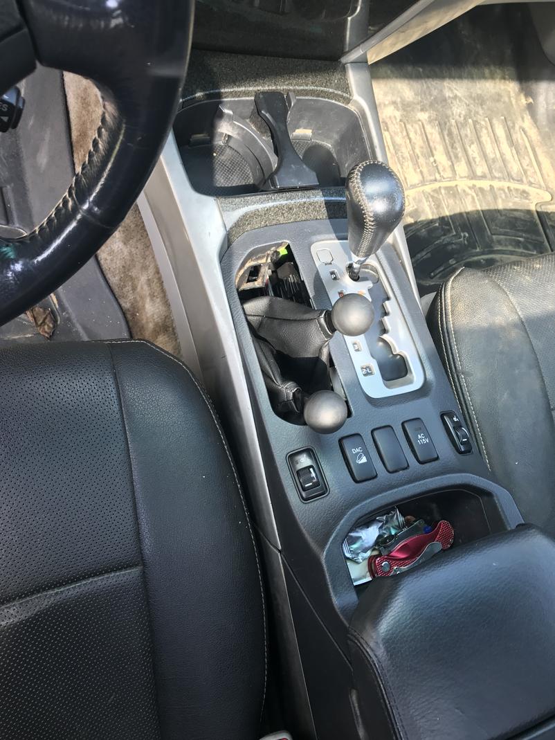

Just an update on the Fj T-case swap.
Its Awesome!!!!!!!!!!!!!
Absolutely love having 2wd. Turning under acceleration, Turning radius, and all around drive-ability much better in 2wd.
A buddy of mine just picked up a new 3d printer, planning to look into creating a trim piece to fit in place around the leather boot. Been Going through Cleaning this thing up from all the off-roading its done the past couple years. Seats and carpet scrubbing to come for certain. I've also had a dash on order from toyota since August so maybe in the next few months I'll see that to!
Its been exciting to get back on the road with this thing. I finally figured out what my major vibration in the front end was. My black rock d-window wheel center caps are not in tolerance to create a hub centric mate between the wheel and the hub. Also removing the steering spacer installed during the body lift, tightened up my steering. Starting to feel like a new ride all over again!
I've still got to do something about the 650lb coils in the front end. I really really want to put a solid axle in. I can't seem to push myself past the point of reading/researching about it to actually start doing it. Probably just going to fall back on ordering new radflos with 700lb coils. The dream is still there though.

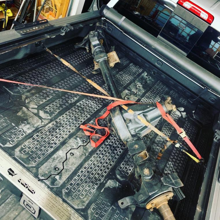

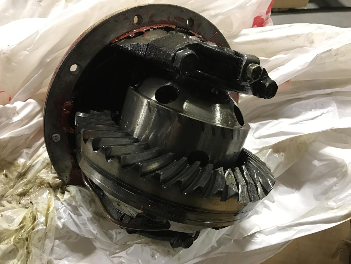

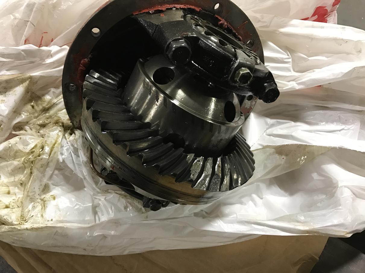

apparently I was due for a new set of gear teeth? I don't drive the 4r much anymore these days on the road and wanted to get back into daily driving it here and there. Went to get an inspection friday and had this happen on the way out of the neighborhood. I don't even remember giving it that much hell the last time I went off-road. I'm thinking a rush install or something. Fortunaty I purchased through eastcoastgearsupply.com and they still have it under warranty until next October! shipping it off to get repaired/replaced this week. Check out the pinion teeth marks on the carrier!
Dang dude, that's crazy! My 4.56's (w/Truetrac) did the exact same thing to me last year. I even had the same thought that I haven't put even put any strain on them to warrant breakage. A call to ECGS had them out and fixed up under warranty at no cost.
well at least I'm not the only one. Taking this axle apart is getting old though lol

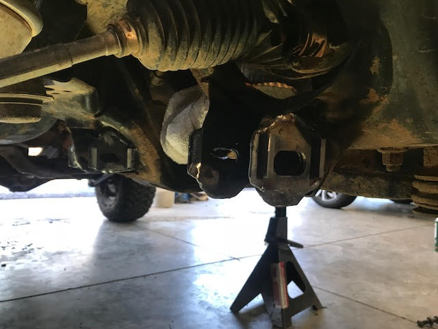

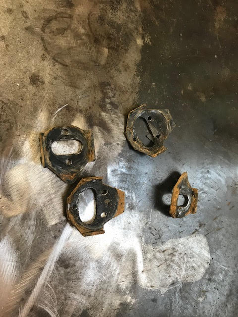

started with the alignment gusset plates,
Need to change out the Inner tie rod links and refresh the CV axle boots/grease. Maybe time for some new wheels.
Also had the luxury of helping bobby install his Total chaos long travel and got to trade him my 650 radflos for his 700lb radlfo's so I finally have the right spring rate up front!

Glad to see you got the Cam gussets so quick and already installed!
Hope the 700 lbs coils hit the spot for you my man :biggrin1:

There is no center diff locker in an fj tcase, when in 4wd it’s always true 50/50 split with the fi tcase. The factory Torsen 3 tcase allowed what they refer to as “all wheel drive” letting the power split up to 30/70 between front and rear. “Torque sensing” is where it’s name came from. Supposedly sends power to the axle that needs it most (or the one with the least traction) thus requiring a locking feature for true 4wd capacities.
Yes one shifter is hi/neutral/lo one shifter is 2wd 4wd.
When the fj tcase is in 2wd the driven planetary gear on the front drive output gear set free spins the 2wd/4wd shift fork moves this planetary gear in and out of engagement when you select the different modes.
When that planetary gear is not engaged the front drive shaft can spin freely however it wants to. Same as the left and right side CV axles spin with the tires independently from each other separated by an open carrier in the front differential.
Adding the ADD feature found in the V6 models of these trucks and Tacoma’s allows you to also disconnect the passenger side axle from the front differential. This prevents the combination of both front axles turning the driveshaft which in turn free spools the transfer case chain and gearsets unnecessarily as mentioned in the comment before yours on this thread.

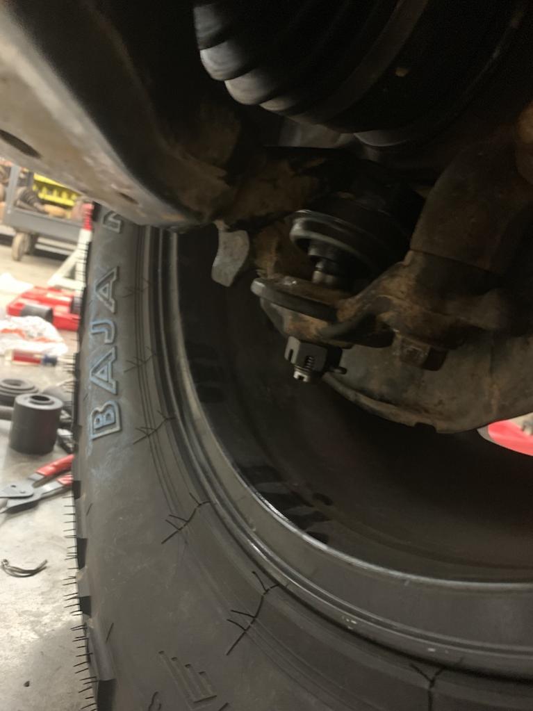

Found these newish moog ball joint designs. the boot redesign attracted me as that's what seems to keep tearing up on the factory style BJ boots. As well They're greesable, pointing the zerk at a 45 toward the front actually making it accessible.
