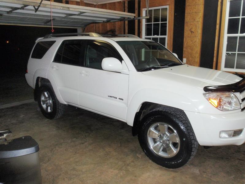

These first shots were the earliest photo's i could drag up. These shots were taken after i replaced the radial tires with cooper A/T's and installed the front bug sheild, as well as liners. So not fresh from the lot but as close as i could get lol.
View attachment 65342 View attachment 65343
View attachment 65341 View attachment 65344
View attachment 65345 View attachment 65346
This is how she sits now:
View attachment 94951[/QUOTE
