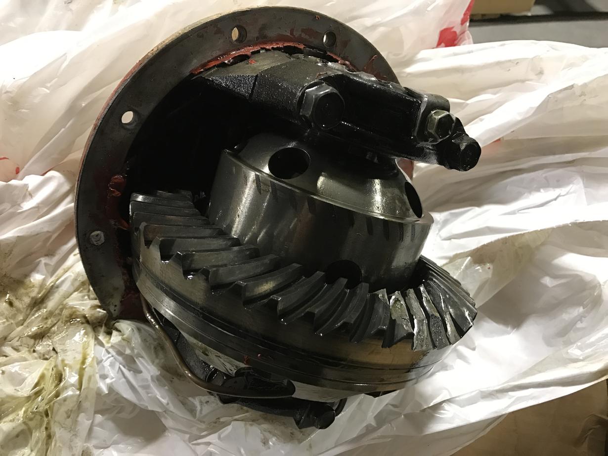

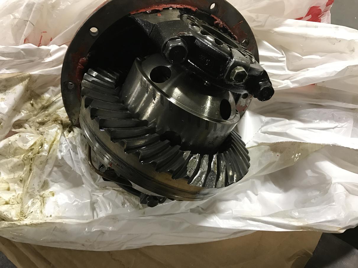

apparently I was due for a new set of gear teeth? I don't drive the 4r much anymore these days on the road and wanted to get back into daily driving it here and there. Went to get an inspection friday and had this happen on the way out of the neighborhood. I don't even remember giving it that much hell the last time I went off-road. I'm thinking a rush install or something. Fortunaty I purchased through eastcoastgearsupply.com and they still have it under warranty until next October! shipping it off to get repaired/replaced this week. Check out the pinion teeth marks on the carrier!
