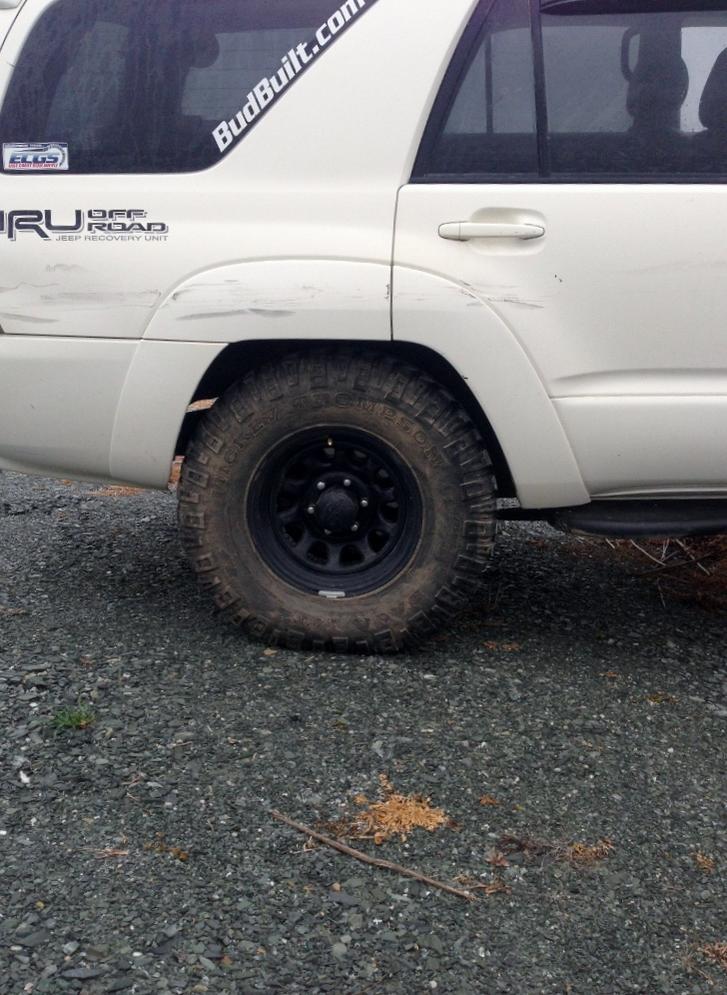

New rubber on the way.. stuck with the MTZ's 305/70R16 E load. Should have them on by wed. or Thursday woot woot!

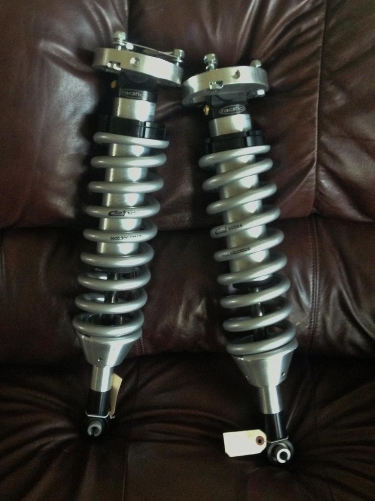

hopefully I'll get a chance to get them installed this week
Nice, Are those the 2.5's? how much thread is exposed? I have about 1/4" on mine and it netted 3.5" plus lift for me. put those babies on all ready!
:reddance:
seems to be about an inch or better worth of thread exposed, came like that out of the box. I'll just have to put them on an see where it sits then adjust it.
Mine are the 700lbs coils that's why. Mine say not to go beyond an inch of exposed thread and that's with the weight of bumper/winch added. Yours have the 650 lbs coil weight so that changes the height a little with the exposed thread. It should tell you the max exposed thread in the paperwork or directions, lol.
evidently toytec doesn't pass info along with there radflo's like that it only had warranty info nothing about install proceedures or anything of that sort. I would have to contact radflo and get that info.

Did you order from Toytec specifying the OW values ?
The amount of thread cranked down will be double the height gained, thus if you crank 1/4" you will have 1/2" of lift gained. Also, the drivers side should be 2/16-3/16 more thread showing then the passenger side to account for the lean. At least that has been my experiance,

When I recieved them they had well over an inch of exposed thread. After install it set me just a bit higher than I was with the OME struts. I didnt adjust them any I'll need to crank on them and even them out side to side. I have a diff drop installed so I can go a little higher than the standard 3" max over stock and still maintain good CV angles.

Yeah I'll get to the joy of adjusting them tomorrow afternoon after my tires get installed, then it's off to the alignment shop to get everything dialed in again. oh and I'll have to repeat the process once I add the bumper in a few weeks lol

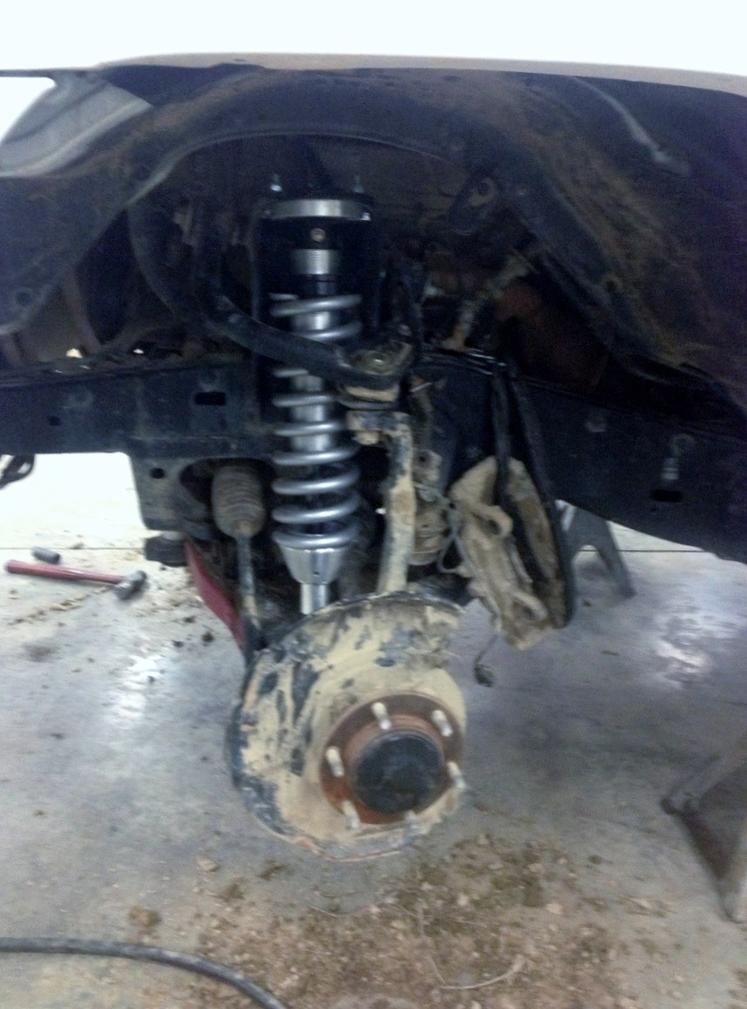

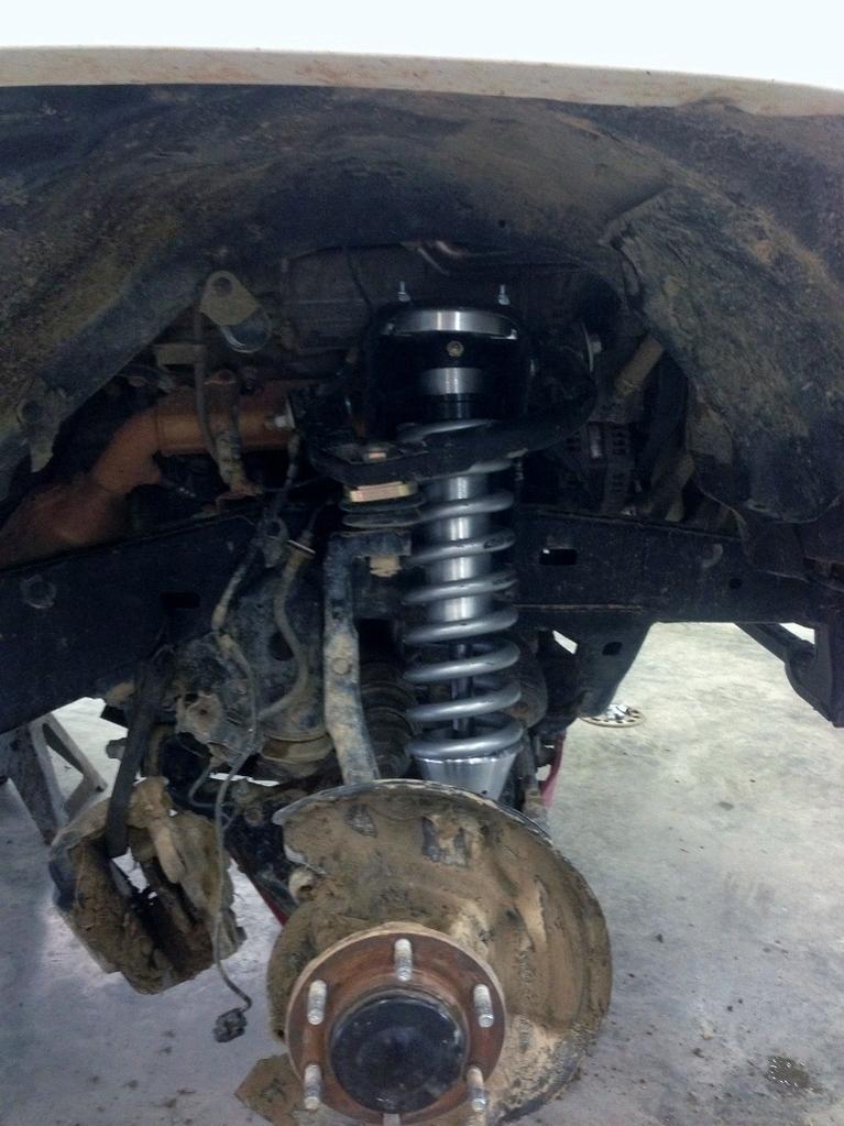

Radflo suspension complete!

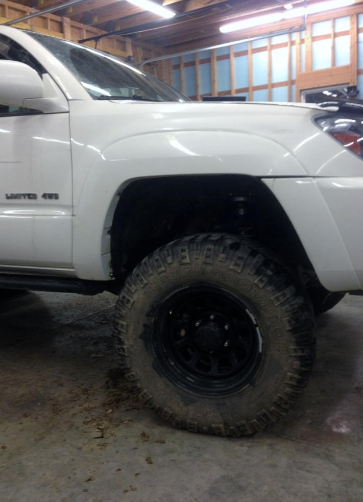

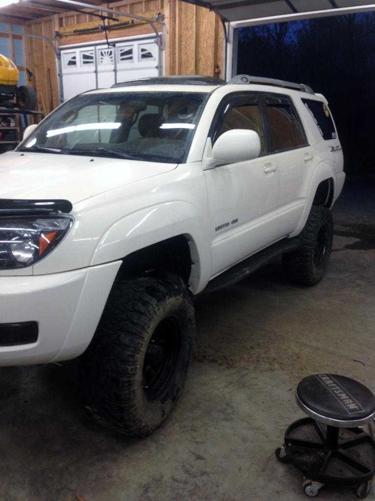

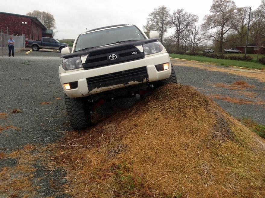

Got everything installed last night. It only took about an hour per side then a extra hour to clean up the shop and put the tools away not to bad at all. without adjustments just installing them the way they came from toytec my fender hieght from ground is 39 3/8" driver 39 1/2" passenger. (also running a 1.25 inch BL and sitting on bald tires so I should see 40-41 inches of finder height from ground after everything is dialed in.)

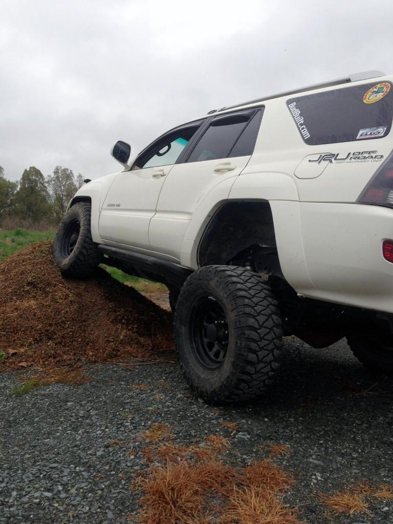

Of course I had to test out the flex a bit. lol
