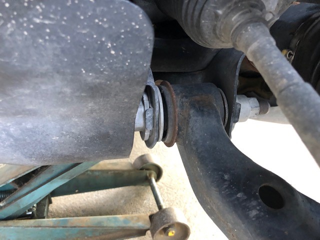

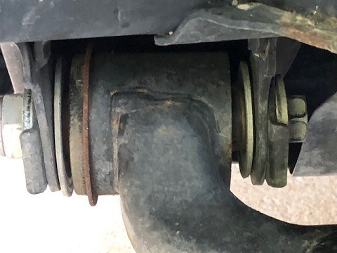

check your LCA bushings. ive had issues with pulling right under accel and pulling left under hard decel since installing a lift on my limited. have had numerous alignments, both from dealer and a good shop from a tech who is a member here, so its not that. i've also nitced that its pretty easy to knock my car out of alignment too. I think the UCA bushings are the culprith as mine have significant lateral play when turning lock to lock at a standstill. I occasionally get a pop noise under load when turning sharply at low speed too. Getting them looked at by the dealer over the weekend to see if i can get the LCAs covered under warranty. If not, ill prob be ordering a set of dirt king LCAs. hoping that helps solve my steering wobble/vibration too.

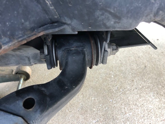

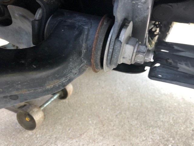

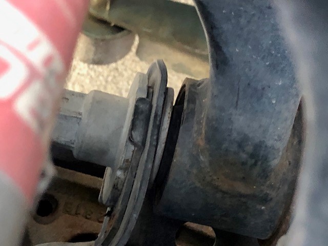

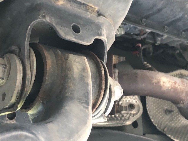

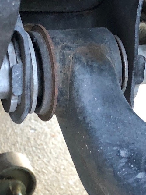

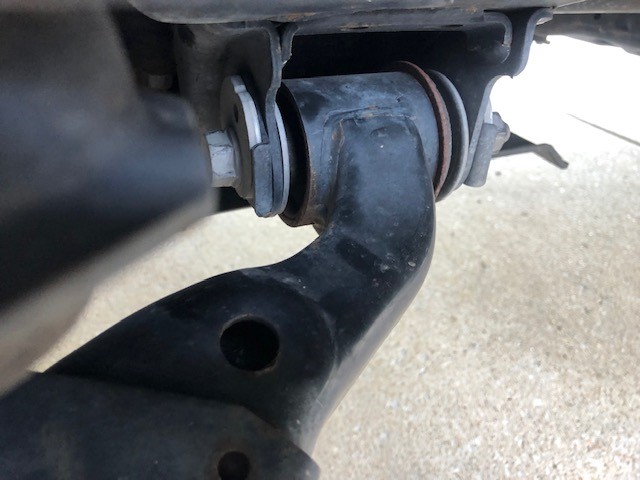

So do these look ok? Seemed to have some play if manipulated with pry bar.
those look worse than mine. have someone turn your wheel lock to lock to see how much they move. my guess based on those pics is that you need new LCAs
