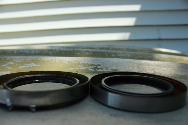

Friday88, the photo is the updated seal on the right, old one on the left, see how the new design put the lip of the seal further in which makes it ride on the bevel of the retainer ?
Flipping the retainer eliminates the bevel and gives the seal more surface area to ride on. Page 1 of the thread shows it pretty well.

Got it. I actually bought that kit, then sent it back after seeing the seals, because they were not the improved design. But they might work with the retainers in the original position. I didn't measure them, but I think they are a hybrid between the original geometry and the new Toyota geometry.
It's not worse than original, it's actually better, because it is more compliant. But, it does require flipping/repositioning the retainer to put the sealing lip in the right location. So it's better from the standpoint of performance, but "worse" from the standpoint that it requires more labor compared to just replacing the seal with an original design. It's a tradeoff :).

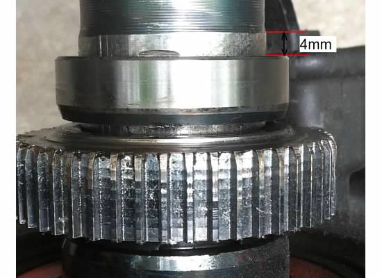

I actually did the Dr Coffee method and I'm good but it seems to me that you just have a little more "margin of error" when you flip the retainer.
Friday, if you do the grease test and it ends up in the middle of the retainer, you should be good no matter which way you put the retainer. Am I missing something here?

There is only one sealing edge in the seal and as long as this edge is on or near the center of the retainer you should be good.
Because if you put the retainer in the same position as the old one and either don't compensate for the new seal design by either flipping the retainer or moving the retainer inboard a little, it could leak.

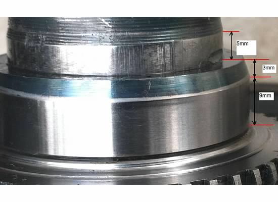

If you would have told them to flip the inner retainer and have it with 5mm of polished axle showing above the retainer, which is the OEM position, you would have been golden Pony Boy.

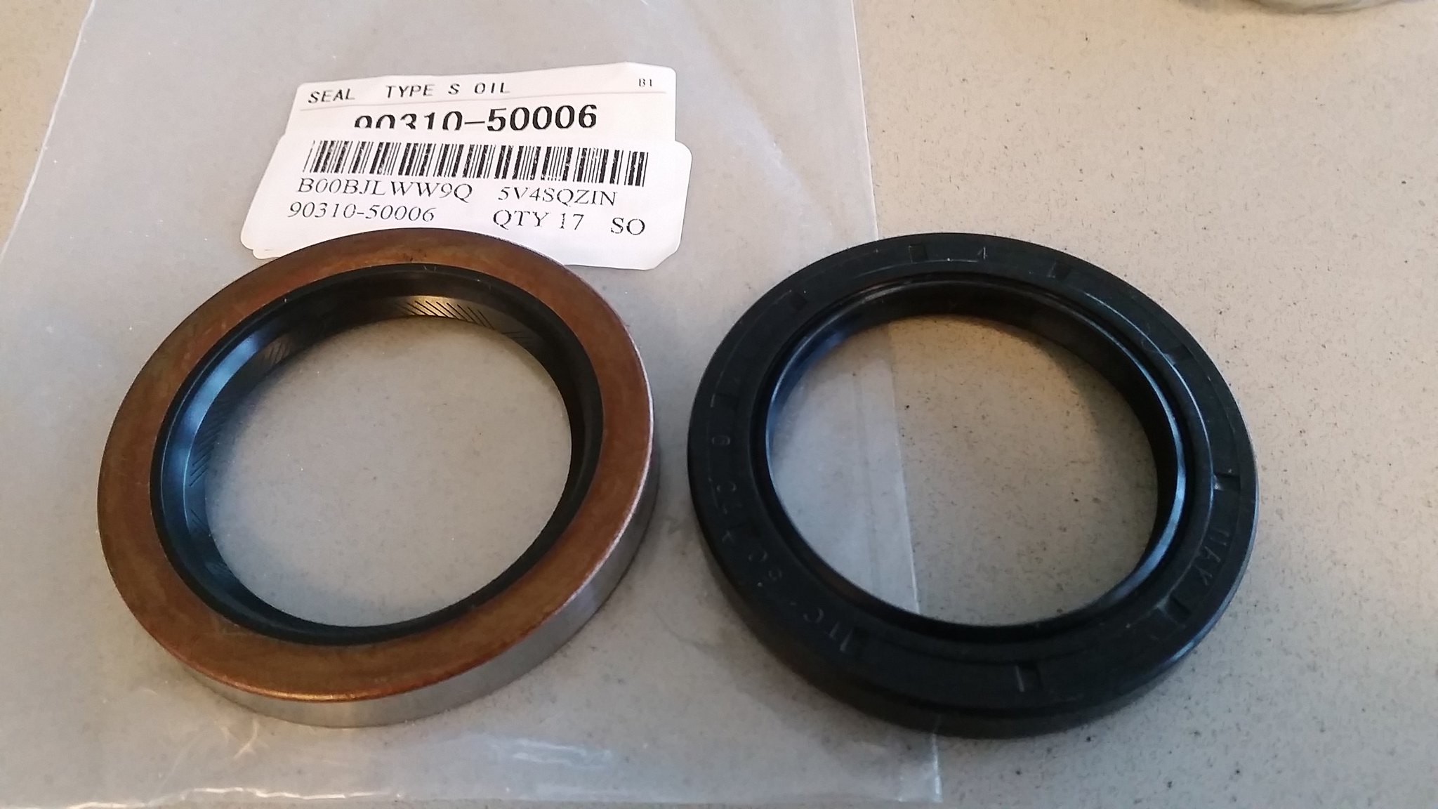

This?
https://www.amazon.com/National-196...99:toyota:4runner&keywords=national+seal+1960
I have had good luck with National seals in the past and would use them on the 4runner if they are the original design.
You know pages 1-3 are very informative. 4runner4leon you could not BE more wrong. I started with National brand and Timken aftemarket seal and the seal was nowhere near the retainer shoulder. I love debating with jamokes who cant get their fingers dirty, take the problems to boneheaded mechanics and wouldnt know how to use a ruler, never mind a dial caliper. The aftermarket seals are made in china and are not made to the correct specs. Watch the frigin video I posted. It doesnt require you to read at all.
And once again the most defensive posters cant be bothered to pull the abs sensor to confirm if its leaking. They just ride the keyboard and whip it like a $2 mule. Friday, you are just one of the many uninformed blowhard know-nothings who hijack threads and bluster without having a clue. Clearly you love your mechanic. Time will tell. But we already know you wont come back and admit you were wrong. Dudes like you never do. This thread is littered with the likes of you.
And yes most repair shops are doing it wrong. They press the retainer down too far and use cheap seals. Its months later when the gear oil hits the brakes and then the response is the axle is bent. Look across the web. You wont find this info anywhere else. Its not common knowledge.

Ha, you beat me to it. I just recalled that it was 1960. That's the one!

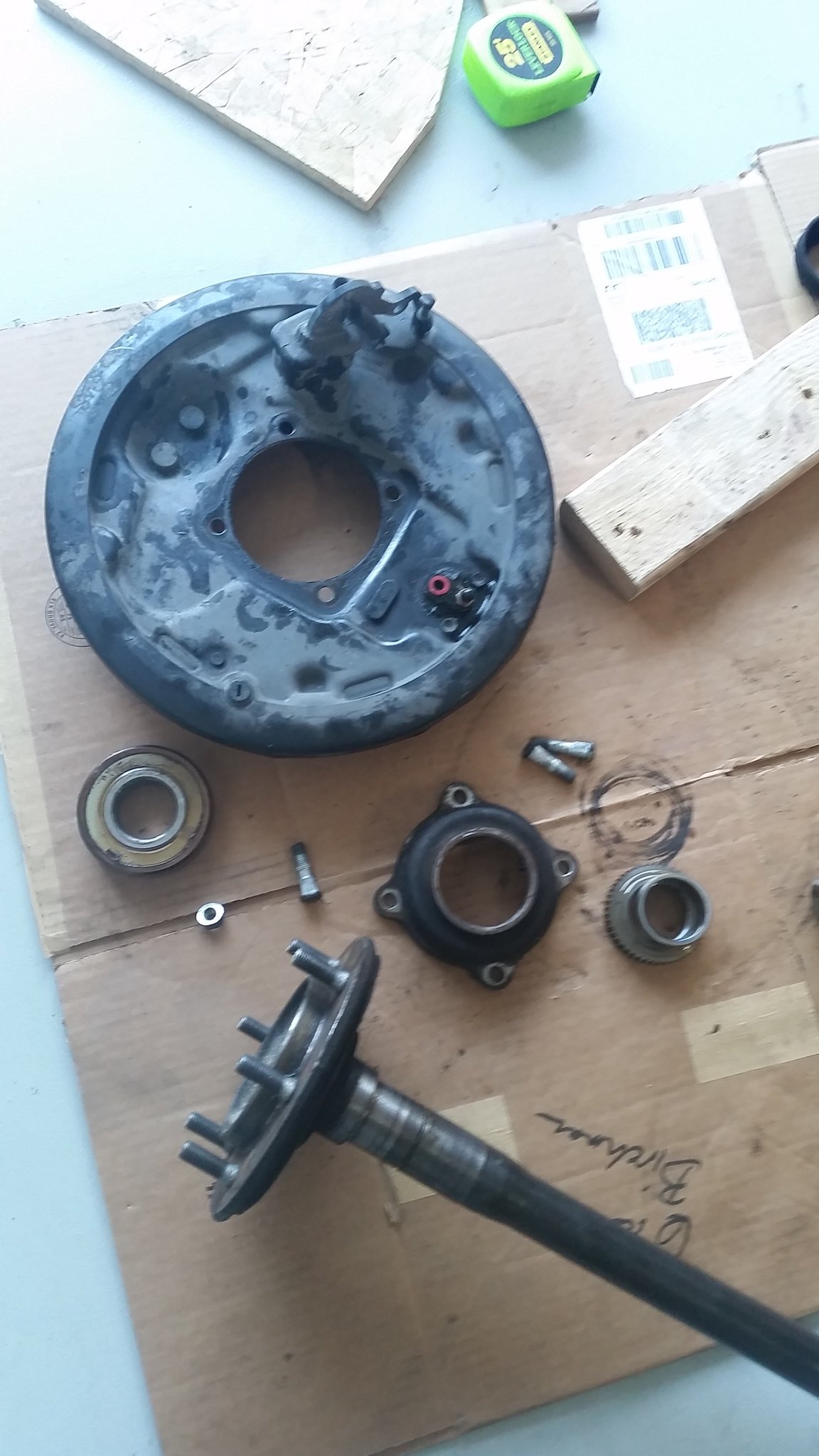

I got my fingers dirty enough:
What seal is that on the right?
