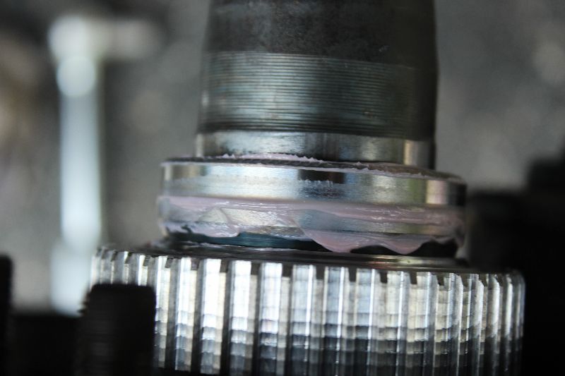

I’m here to see if my grease test is a pass or a fail before completing the mission.
Thinking she could take another millimeter, but not sure.
Also, wondering if the outer seal (black) should be exposed this much.
Can’t remember if it was that way before...
...Thanks!
The retainer needs to be pressed on further. The seal lip is riding closer to back near the bevel. If you press the retainer on until you have 5mm of polished axle showing, the seal lip will be riding close to dead center on the 10mm polished retainer shoulder. To measure the distance while your doing the press work, release the bottle jack a liltle and then have a friend lift up the assembly while you get a 5mm allen wrench above the retainer to do a quick measurement. If it's not far enough, press it down a little further. You can do varying degrees of adjustment with the press depending on how much you move the jack handle. For a very small movement, lift the jack handle only a little before bringing it back down. By doing small movements and rechecking the distance over and over, you'll have a very good chance getting it perfect.
The dust seal looks correct. You're good.
Thank you Tim. I understand the FSM states 5mm and some posts suggest 3mm of polished axle showing. Perhaps that’s why the grease test is the gold standard.
My ‘press’ is an old steel tube over the axle shaft so I will incrementally tap on that retainer again and run one more grease test before torquing down.

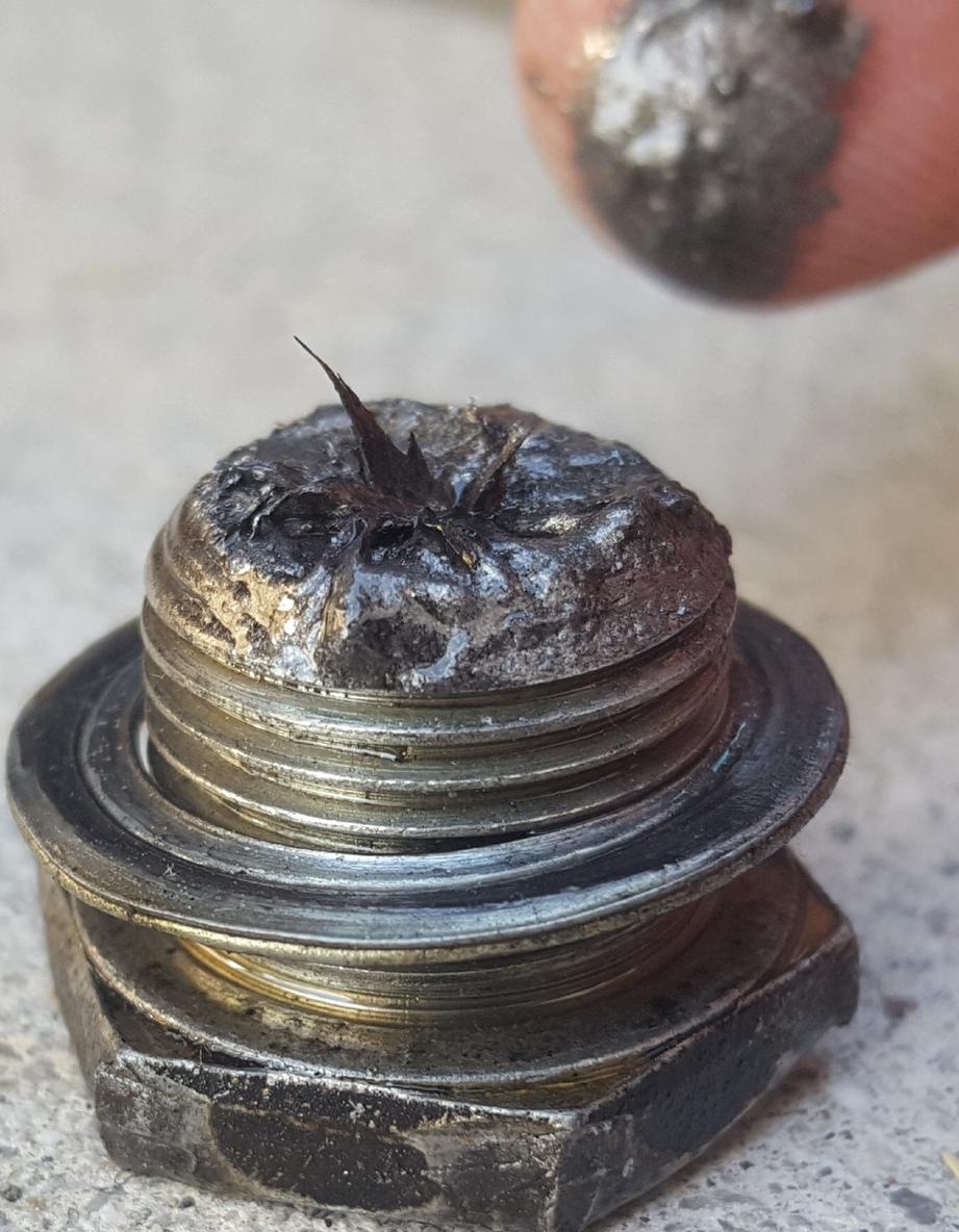

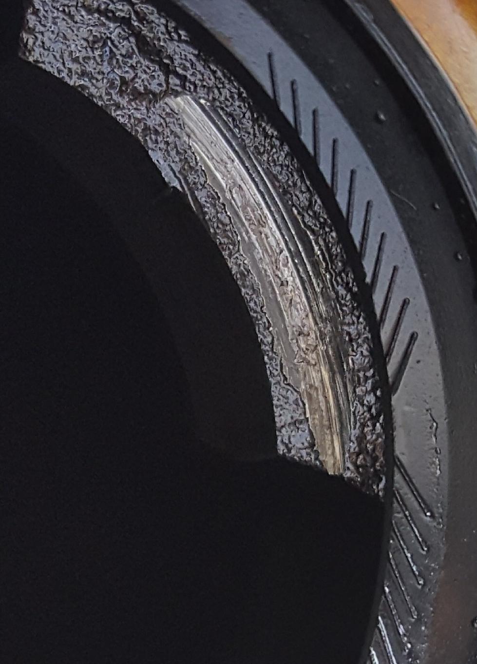

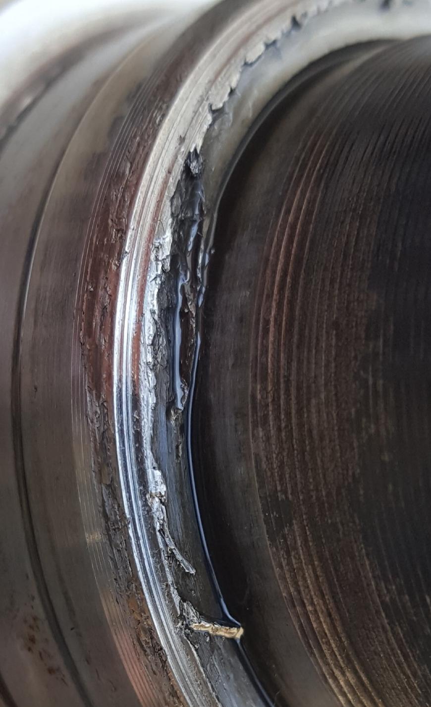

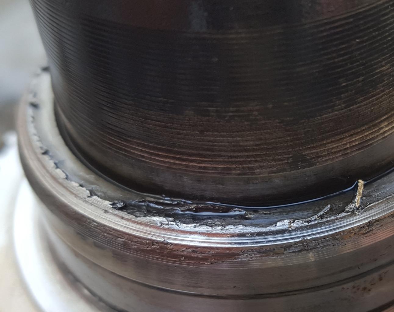

Mine has an awful grinding noise in addition to the leak and I can see where the retainer appears to rub on the axle housing. When I checked the bearing(trying to wobble the tire when in the air) I really didn't feel any movement or thrust. My retainer shows about 4.1mm of axle and is rubbing. Is it possible it isn't on far enough or the bearing moves a lot more under load ? If I flip the retainer it is really going to rub as it doesn't have the taper that matches the axle housing so I'm hoping it is bearing movement. Waiting for new OEM bearings.
Also it appears the diff breather was plugged and the whole unit was entombed in dried oil mud, which may have caused the seal to squirt. When I drained the diff oil (160K miles, not sure if PO ever did) the plug looked like it had grease on it. Is that normal ? The oil wasn't too bad looking.
Based off where your inner retainer is sitting on the axle, for it to be hitting in the inside of the axle housing, it must be bearing play allowing that to happen.
As for your differential drain plug, the gunk you see is metal debris the magnet has collected from your differential. The differential drain plug is magnetized for that reason.

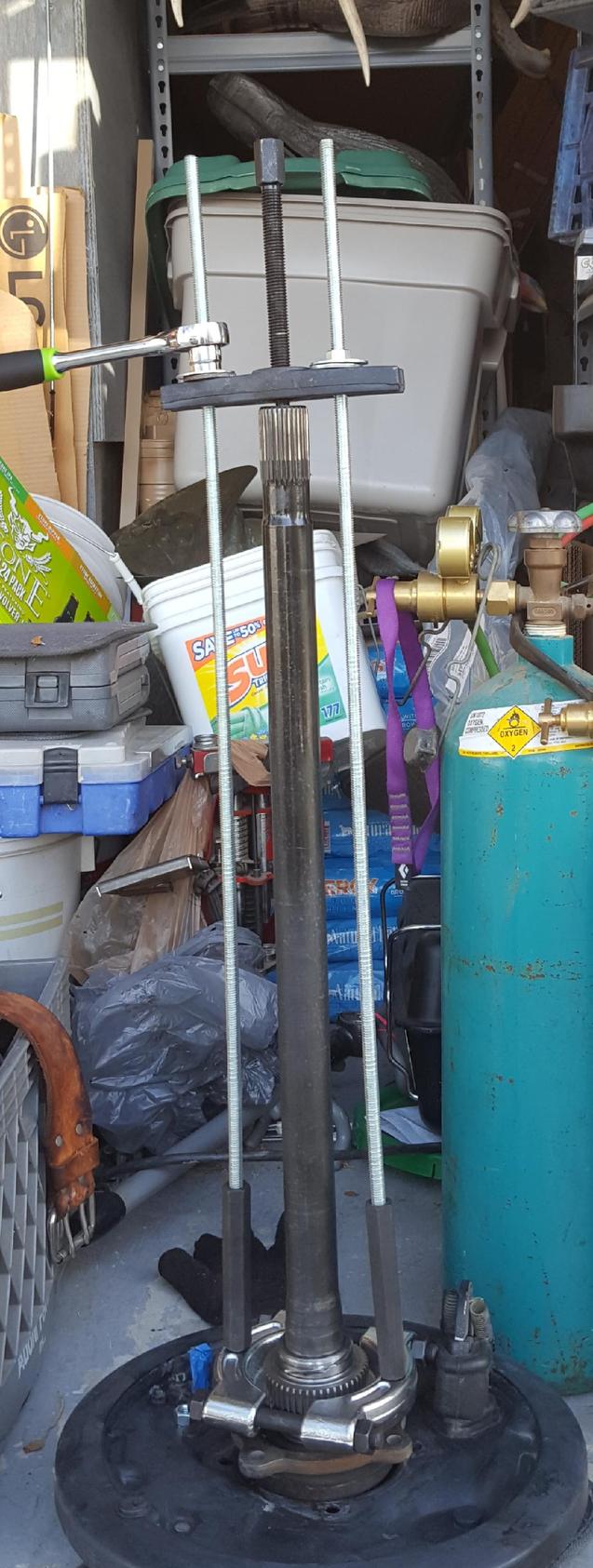

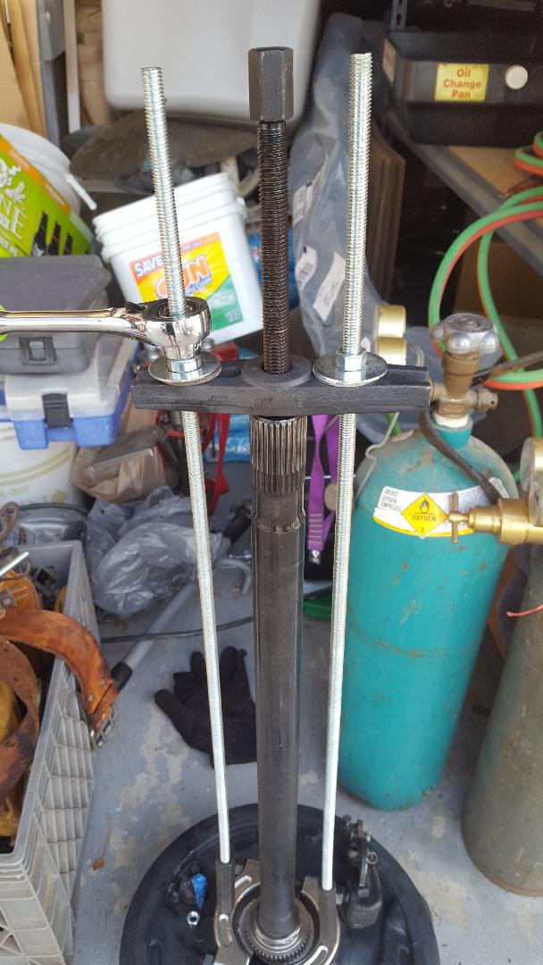

My neighbor has a press but he's out of town so I figured out a way to get started. Had to realign it 2x but it got the retainer & gear off !

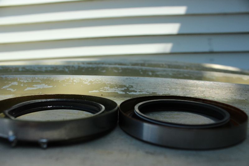

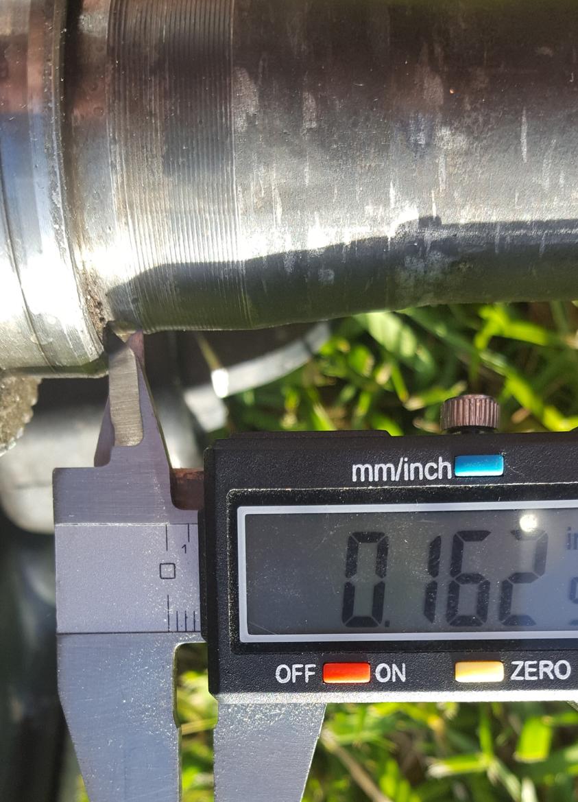

I finally finished up my rear axle bearing repair this weekend.
after reviewing all the details in this thread I have to say, Dr. Coffee's solution to the new seal design definitely has merit.
I had the machine shop move my retainer outboard by 1 mm (or roughly .160 because my shop guy "don't work in friggin mm!" -:biggrin2:)
It put my seal right about center on the retainer.
I'm happy to say after about 75 miles or so shes still dry!
Plus, no more grinding sounds! :party:
He did mess up a bit on the position of the ABS rotor but it doesn't seem to have presented a problem... so far

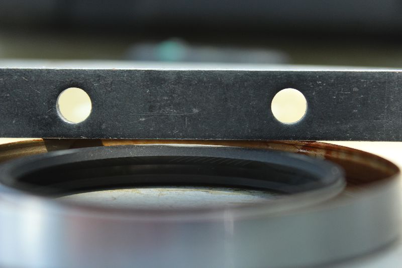

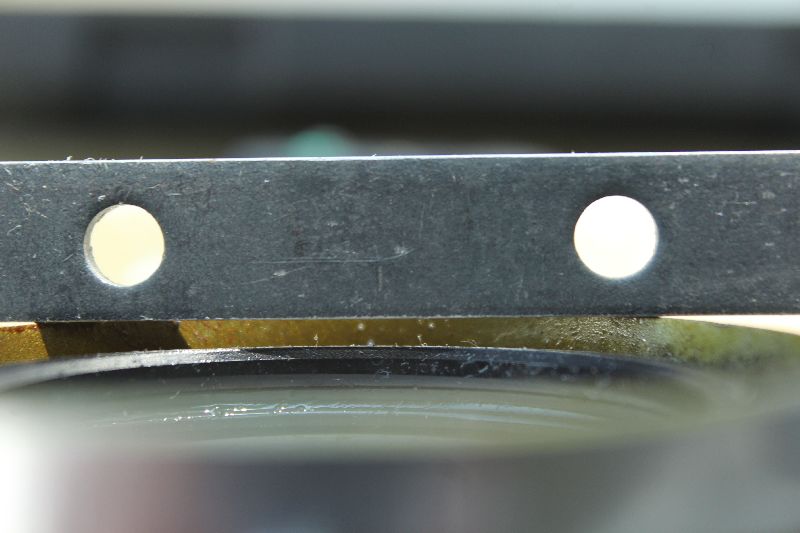

I included some shots of the seals side by side old (left) new (right)
The position of the rubber seal in relation to the back side of the metal casing - using a straight edge across the back of the case.
Retainer grease test.

I did do the grease test, and the seal seems to side in the center of the retainer, on both axles. Everything is back together now, so I guess I'll see if starts leaking again...

So what you saw on the grease test was the outer dust lip of the seal. But had you read the thread, you would have realized that. After all these pages of info you deferred to the guy who has been doing it wrong along. Did you expect him to say he has F'd more trucks than he can recall? Maybe If I charged $750 to read this thread you would have made a better choice.
