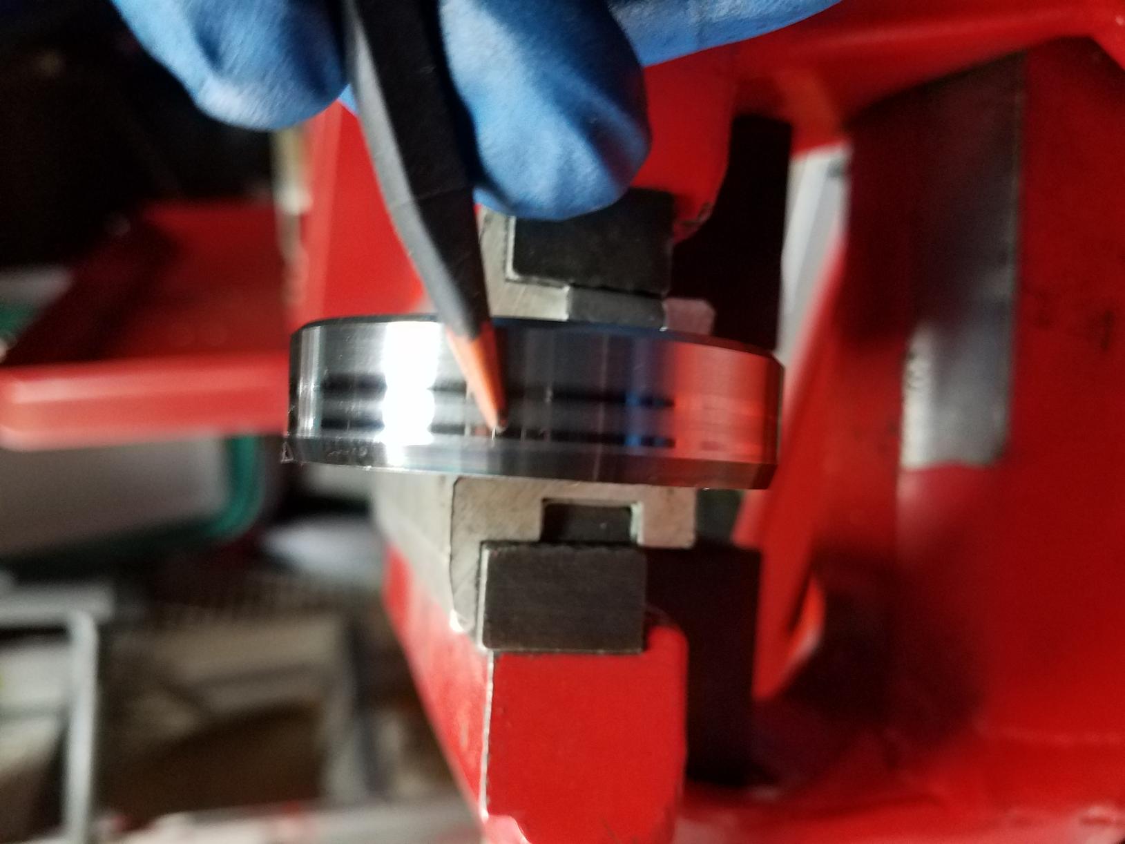

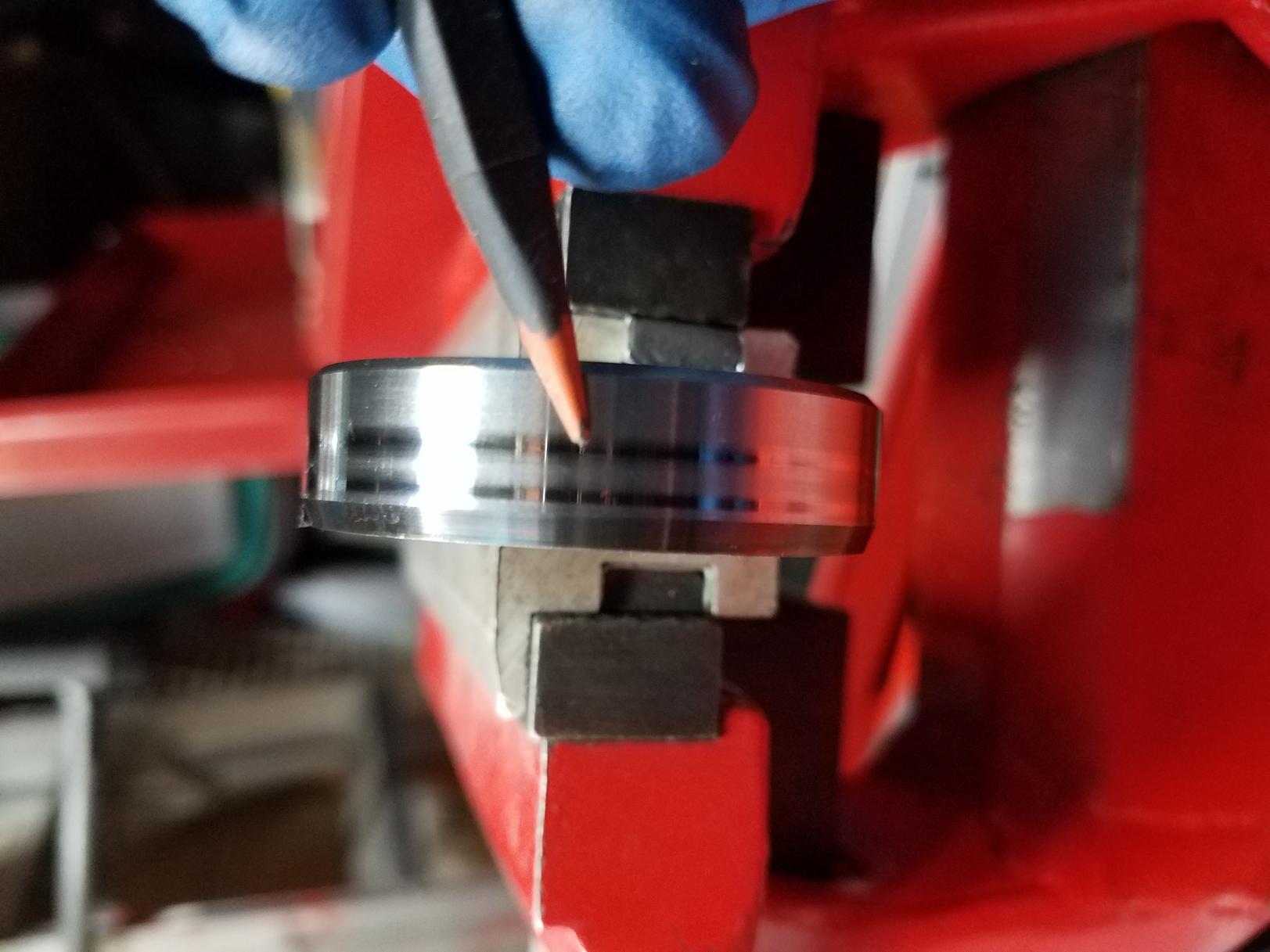

The pictures below show where the new seal design will ride on the inner retainer if somebody blindly follows the FSM. The middle witness mark is from the original seal from the factory. The witness mark close to the bevel is from the new design. With a little axle play from a worn out bearing, that seal is going to ride on the bevel and fail. Ideally, you want the seal to be riding closer to the middle of the polished shoulder. Whether you keep the retainer in the original orientation and move it in closer (3mm of polished axle showing) or you flip the orientation and keep it in the original spot on the axle (5mm of polished axle showing) you need to address the inner retainer due to the new seal design. With a new bearing, the seal riding close to the bevel will last for a quite a while before axle play from a worn bearing will cause it to fail. With the seal riding near the center of the retainer, it's going to allow for lots of axle movement and will thus last longer before the seal eventually fails from the strain of the axle movement.
Anyway, that's my two cents.

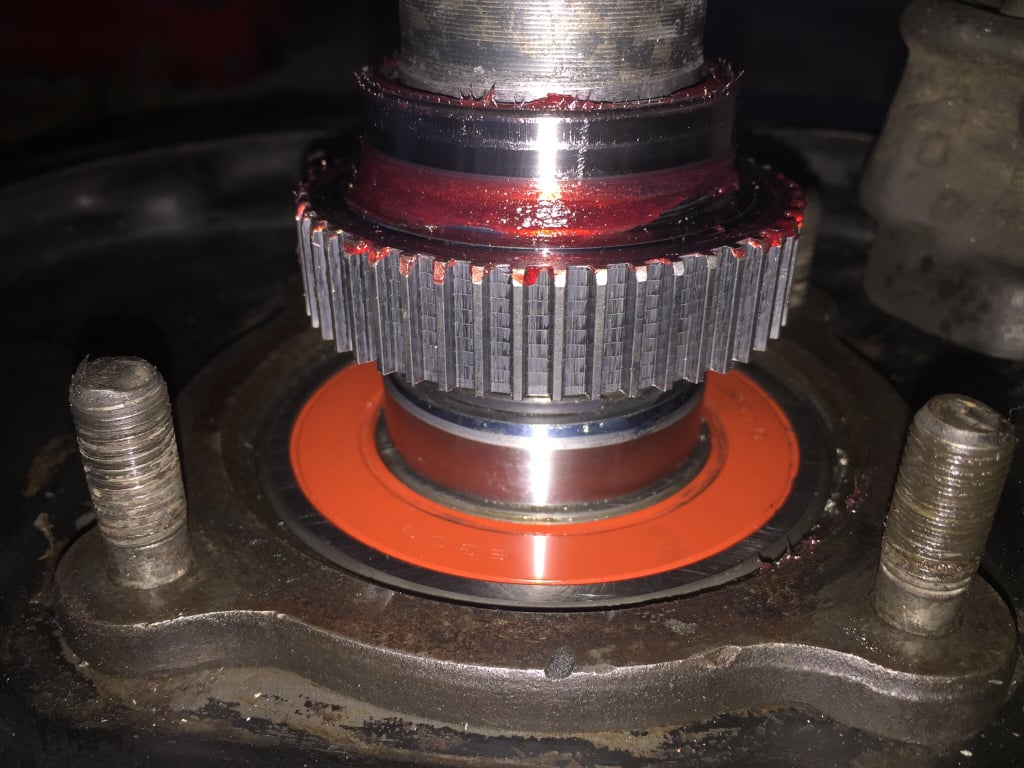

I'll share what I did for locating the tone rings, it's super easy to do. I fully inserted the axle shafts back into the housing, inserted a black Sharpie into the hole for the ABS sensor and rotated the axle shaft. This left a tell-tale mark for the location of the tone ring. From there, I used a tape measure and got that distance from the back side of the drive flange to the black Sharpie line.
Using that measurement, I pressed on the tone ring until the center of the ring hit that measurement. This put the tone ring dead center inside of the bore for the ABS sensor. Maybe this level of precision isn't really necessary, but it made my OCD happy and it just looked good- like I had half of an idea of what I was doing.

What if you did not flip the cup and set it 5mm ?
The stock location for the retainer is 5mm of polished axle showing above the retainer. With it in that location with the new seal design, your seal lip will be riding fairly close to the non-polished bevel. The picture below show a witness mark where the original seal was riding and where the newly designed seal rides when the position of the inner retainer goes unchanged. If you flip the retainer, you can keep the retainer in the same position on the axle and have the seal lip riding near the center of the polished shoulder because you gain back the 2mm seal lip difference between the old and new seal design because you don't first have to push past the bevel which is around 2mm wide. Hope that makes sense.

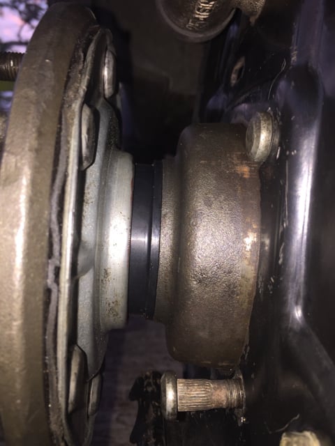

I’m here to see if my grease test is a pass or a fail before completing the mission.
Thinking she could take another millimeter, but not sure.
Also, wondering if the outer seal (black) should be exposed this much.
Can’t remember if it was that way before...
...Thanks!

The retainer needs to be pressed on further. The seal lip is riding closer to back near the bevel. If you press the retainer on until you have 5mm of polished axle showing, the seal lip will be riding close to dead center on the 10mm polished retainer shoulder. To measure the distance while your doing the press work, release the bottle jack a liltle and then have a friend lift up the assembly while you get a 5mm allen wrench above the retainer to do a quick measurement. If it's not far enough, press it down a little further. You can do varying degrees of adjustment with the press depending on how much you move the jack handle. For a very small movement, lift the jack handle only a little before bringing it back down. By doing small movements and rechecking the distance over and over, you'll have a very good chance getting it perfect.
