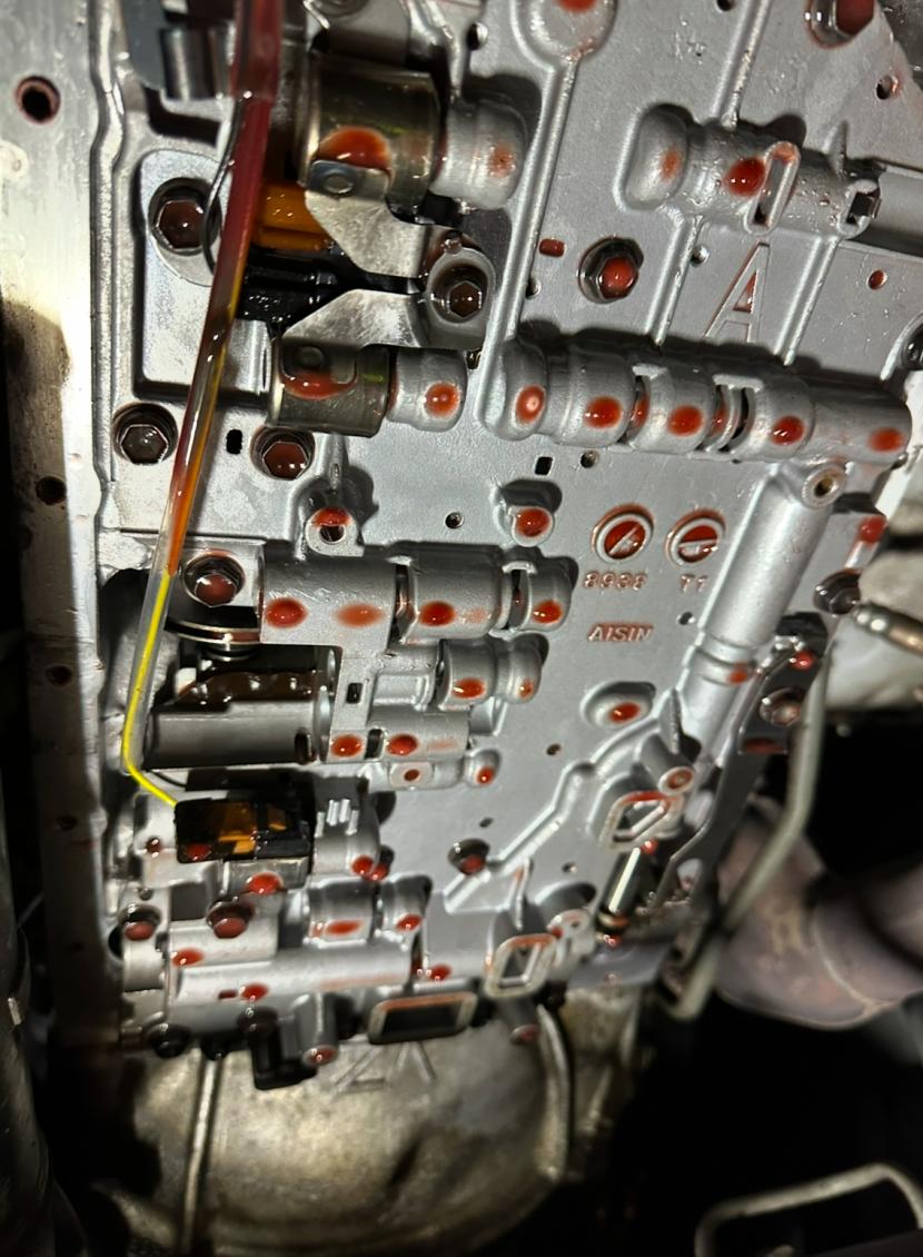

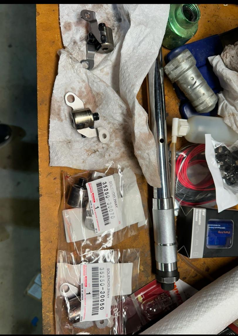

The parts came in and looked identical to the two solenoids that were installed on the valve body already…the brackets that attach them are different from one another so it made sense. So after replacing them 2 days ago, I got a new shift solenoid error (P0758) for solenoid B. This turned out to be an issue with the solenoid harness (see below) so the verdict is still out if the two PNs above will still work in a 2000. I called my local Toyota parts department and the said the two shift solenoids are identical, and provided the part numbers :

He said they are identical in terms of the bracket orientation, one is Denso and one is Aisin. Maybe the newer solenoids are different than the original in the picture below and just attach using different bolts on the valve body and I’m overthinking this. It’s just odd they use the same part number when they physically look so different.
I’m just looking for some help here, has anyone replaced these on a 2000 and can verify either sets of part numbers above? I’ll attach a photo from my shop showing the two solenoids I purchased and how the brackets are different. The original OEM A solenoid (in my case I tried using 35250-30050) the brackets are on each side of the solenoid in an east and west direction. The B solenoid (to the right of the A solenoid on the valve body, I purchased/tried using 35250-30070) has brackets in a north and south configuration. I’m struggling how Toyota can say they are the exact same part number when the original solenoids that are coming out are physically different in how they attach. Thanks for any help or guidance! Sorry for the long post, it’s my first time trying
FINAL UPDATE:
Merry Christmas! Wanted to confirm that 30050 and 30070 do in fact work for teg 2000 SR5, 4WD after all. Put in the new solenoid harness last night and went for a test drive today after sealing everything up. That’s good intel since they cost half as much as the later parts in this post. I bought two shift solenoids directly from Japan via EBay. Got 30050 and 30070 for 105 bucks shipping included. They did take two weeks to come in so if you are desperate you’ll pay more at the stealership!

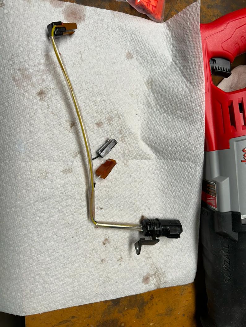

UPDATE:
Dropped the pan today and traced the solenoid harness wires…found the black wire for the B shift solenoid was broken! Looking to order a new solenoid harness. Does anyone know the part number for a 2000 SR5 with the A340F tranny?
UPDATE: A furious search through Yoshis parts seems to indicate 82125-60310 is the correct part number for what I would call the solenoid harness. I’ll call Toyota in the morning to confirm the P/N. This might help someone in the future who runs into a brittle solenoid harness :)
Toyota confirmed the PN. Will post pictures of the old one removed…

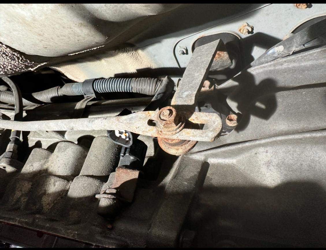

Pictures of Solenoid Harness Removal and Whatnot :)
Here are some pictures of the top of the harness just outside of the transmission where it plugs in…and a picture of the harness removed

Thank you very much for checking Brillo 76! I picked up the harness yesterday morning and did a double take on the final part number. I ordered the harness PN above but what came in was:
82125-30400
The parts manager shared his screen with me and said based on the manufacturer date of my VIN they recommended this harness vs the one listed above. What was interesting is the pins and wire color were the same, but the white wire which plugs into the first shift solenoids was about 3 inches longer than the original. I had to cut back some of the clear plastic outer sheeting to get enough length of for it to reach back to the #1 shift solenoid. I called a mechanic friend of mine and he said maybe Toyota just made the replacement harness with the extra length to work in several different applications. If I were rich I would order the first harness too just to give the forum two options. Appreciate everyone’s help and feedback!
