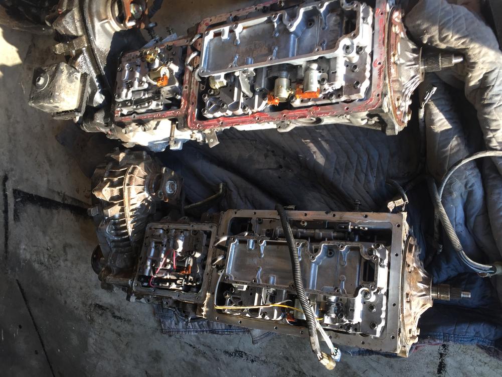

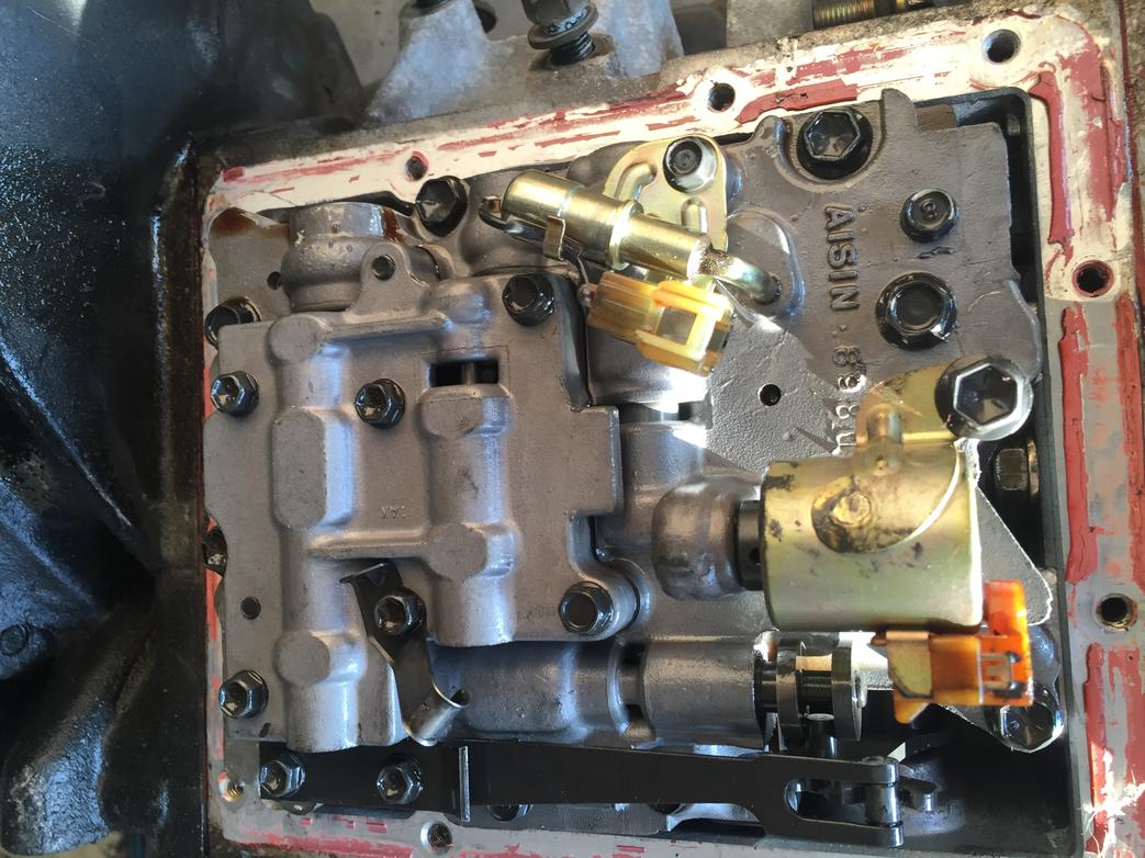

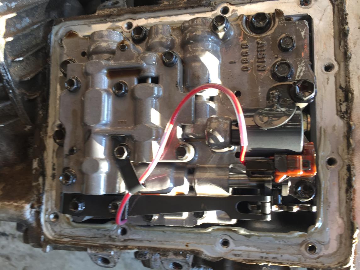

I've been searching everywhere trying to find answers. Pulled my transmission from my '86 4runner and had a donor to swap in. Wiring harness was different on donor so I was going to swap them. Found the donor has a 5th solenoid? The 3 in the transmission match up with wire colors and the 4th in the transfer matches with wire color (red) but the donor has a smaller solenoid with a blue wire. Does anyone know what this solenoid is used for.
It came out of a '88 with a v6 but don't know if it was swapped previously. It has the transfer case oil cooler and harmonic balancer on the transfer gear box. Anyone ever see this 5th solenoid. I'll try to load a pic.
trying to load pics

OK, smaller one in bottom pic is not a solenoid. It is either a fluid pressure sensor or a fluid temperature sensor. I am guessing pressure since there are 2 temp sensors accessible from the outside case.
I just swapped a transmission into my '87 Turbo. The donor vehicle was a 1993 V6 4Runner. I ran into the same thing. What I did was swap the valve body off of the 87 and put it into the 93 transfer case. I was not sure what the differences are.
Everything seems to be working just fine. I will say that the bolts are all different length, so keep an eye out on which hole they came out of.
