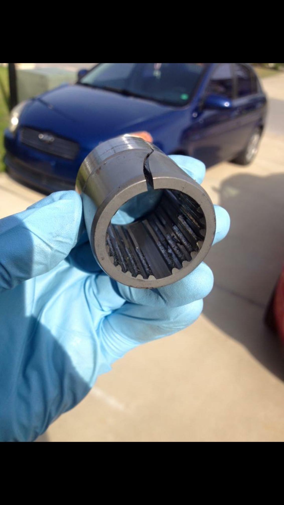

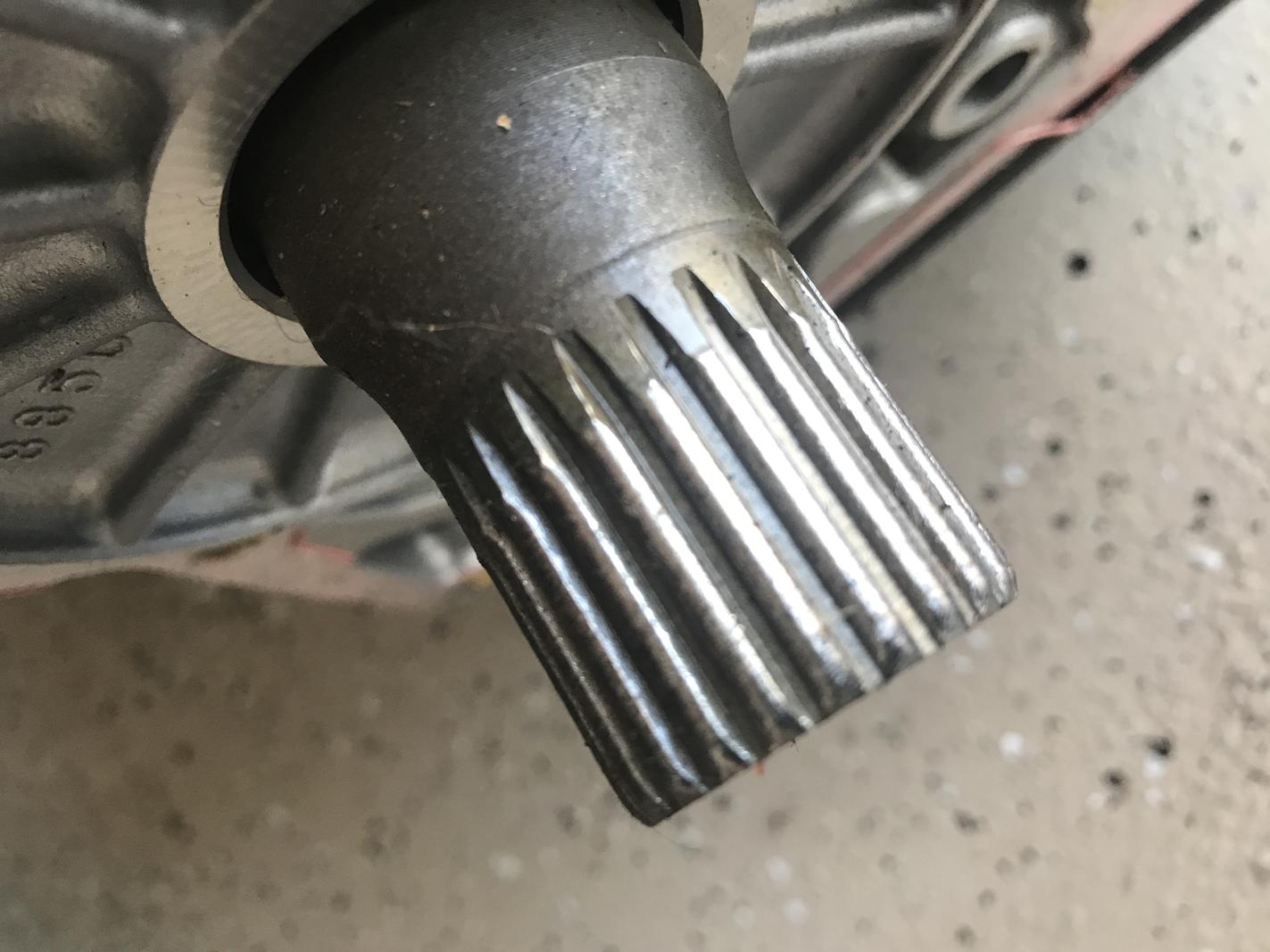

No offense taken to any of the comments, after all, it seems absurd, especially if you would not personally mess with such complicated systems like the engine and transmission. Two years ago, I hydrolocked my original engine and threw a connecting rod, while punching a whole in the engine block. I had to replace the engine myself, filled ATF per FSM in my original transmission, and everything was fine until a year later. In that year, I contributed the forward jerking to "driveshaft clunk," until one day, a clunk became a whirling noise and the 4Runner would not move forward. After removing my transmission, and upon closer examination, I realized that my "driveshaft clunk" was purely transmission related. One photo is of shaft spline coupling, connecting transmission shaft to transfer case, and the other photo is the worn shaft on my original transmission.
Upon installing the donor transmission, and filling ATF per FSM, the symptoms remained. A few weeks ago I decided to take the chance and add more ATF. If anything seemed weird, like CEL's and transmission lights in the cabin, or driving was off, I would have removed the extra ATF. Instead, it appears to have fixed my "driveshaft clunk." As hard as it is to say, I suspect the FSM is misleading, and would have the DIYer put too little ATF back into the transmission.
If you have messed with your ATF for whatever reason, remedied the "driveshaft clunk," and problems still exist, you might be suffering from low transmission fluid. I believe these photos are the result of low transmission fluid, which was initially mistaken as driveshaft clunk. One quart of fluid may have been the difference.

I assume it's worn because the spline coupling broke, so the transmission shaft spun in the coupling. That's the whirling without moving. I guess if it was slamming into gear then maybe the shock broke it. It can do that if it's low on fluid.

After breaking the first transmission, I was sure it was because I had missed a step in the procedures. Myself and two others followed the FSM to a T during the second transmission install, and I was quite disappointed when the symptoms remained. All I could think of was "I am going to need a third transmission in a year or less." Its a good feeling knowing, if I ever I have to slam on my brakes again, my transmission wont die. It's also nice thinking about it less and less after every day. Hopefully one day, I won't even consider it.

Any chance you can get me a part number for the spline coupling? I have one that looks just like yours and need one that doesn't!!
