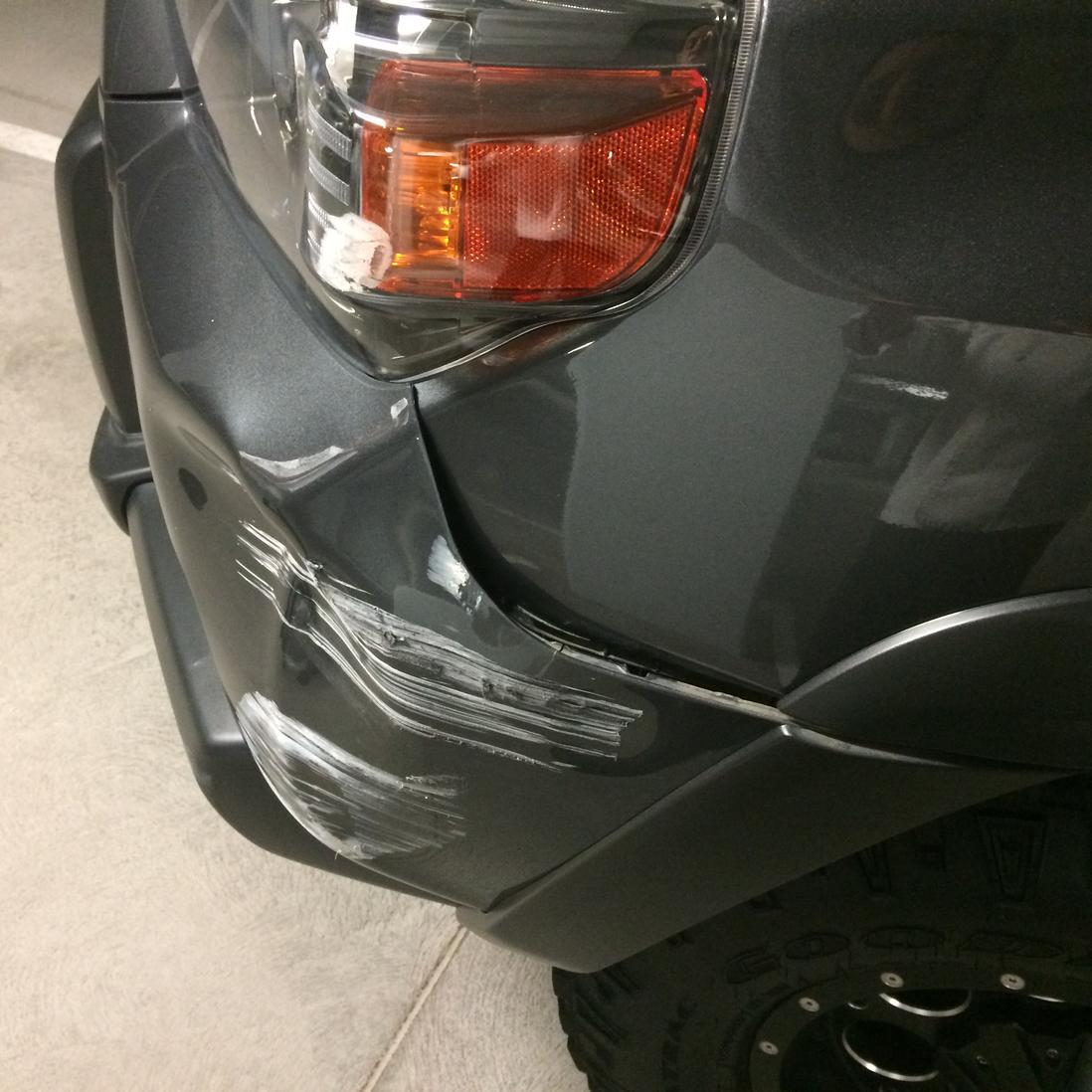

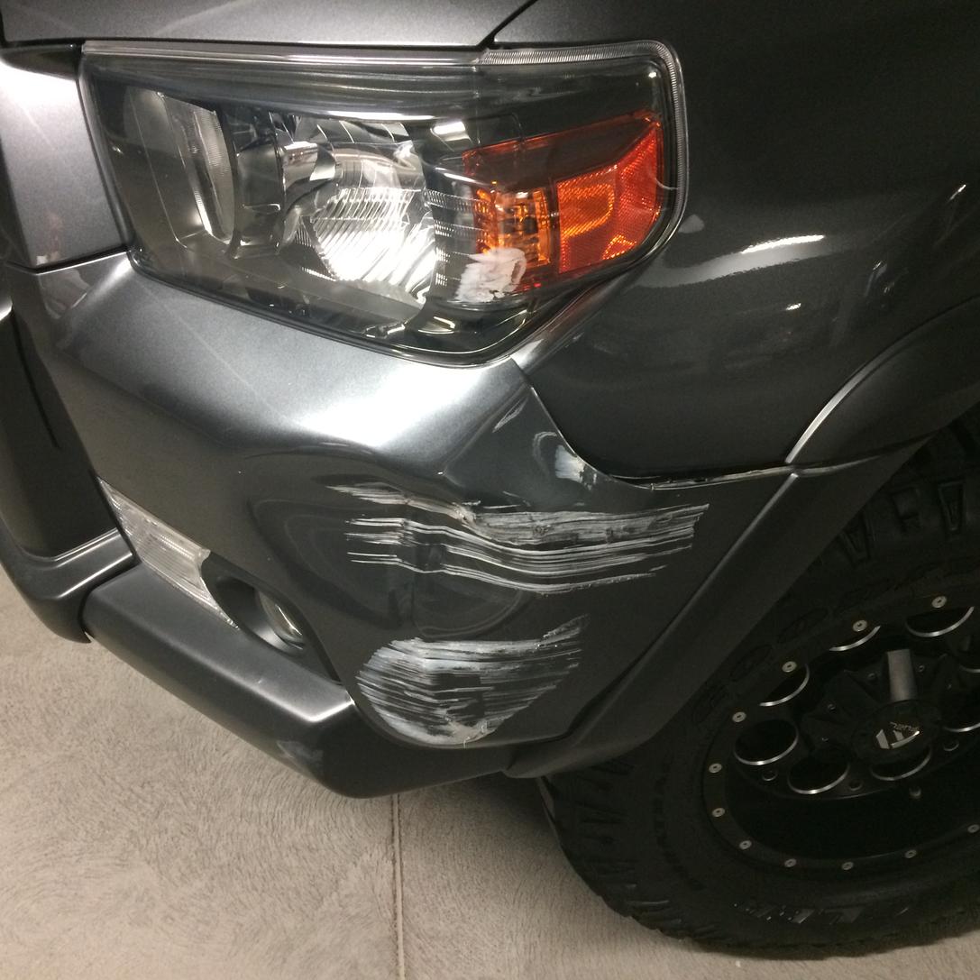

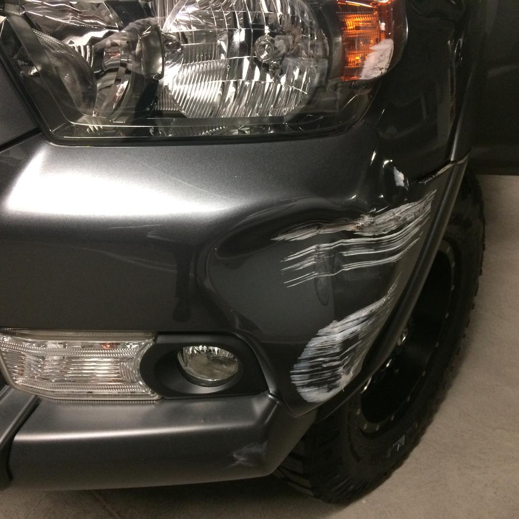

ok disaster may be a stretch but it still sucks. I tagged the brickwork outside my garage trying to pull in while distracted. So what are everyone's thoughts? New after market bumper or replace the stock bumper cover? Anyone have any idea how much replacing with OEM might be?

Few solutions:
1) Take advantage of the upcoming shrockworks group buy
2) Push it back out from the inside, buff it off OR plastic dip it
Bummer :(
BUMPER COVER - 2013 Toyota 4Runner (5211935910) - $175~$275 IIRC they come unpainted
HEADLAMP, LEFT - 2013 Toyota 4Runner (8117035530) - $185~$255
You are better off either pushing that out and accepting the visual scratches. Or for how much to remove that and install and paint a new one you should just get an aftermarket bumper.
Heat it up before you push it out, either a hairdryer or a heat gun, then it won't look so bad and you can take your time to consider your options.
Unfortunately a number of the clips holding the cover in place broke off. Fortunately the headlamp was undamaged and the paint will come off

Thanks for the info! Thankfully the headlamp is ok. I think I saw the color matched bumper cover for $800. I got a generic quote from a body shop of $1800. For that kind of money I think aftermarket is the way to go

In the mean-time I posted this one for someone else that scraped their rear fender getting into the garage, spray some carburetor cleaner on a rag and wipe it on the scraped on paint. It will come off right away. Then just use spray on wax or something to get the shine back on until you decide which way to go.

I would try popping out the dent using the heat gun mentioned above and do a quick spray coat as the quickest and cheapest option. If that doesn't work, go for a new aftermarket steel/aluminum bumper as it looks like you already have the upgraded suspension to support the extra weight.

This worked great! Thanks
