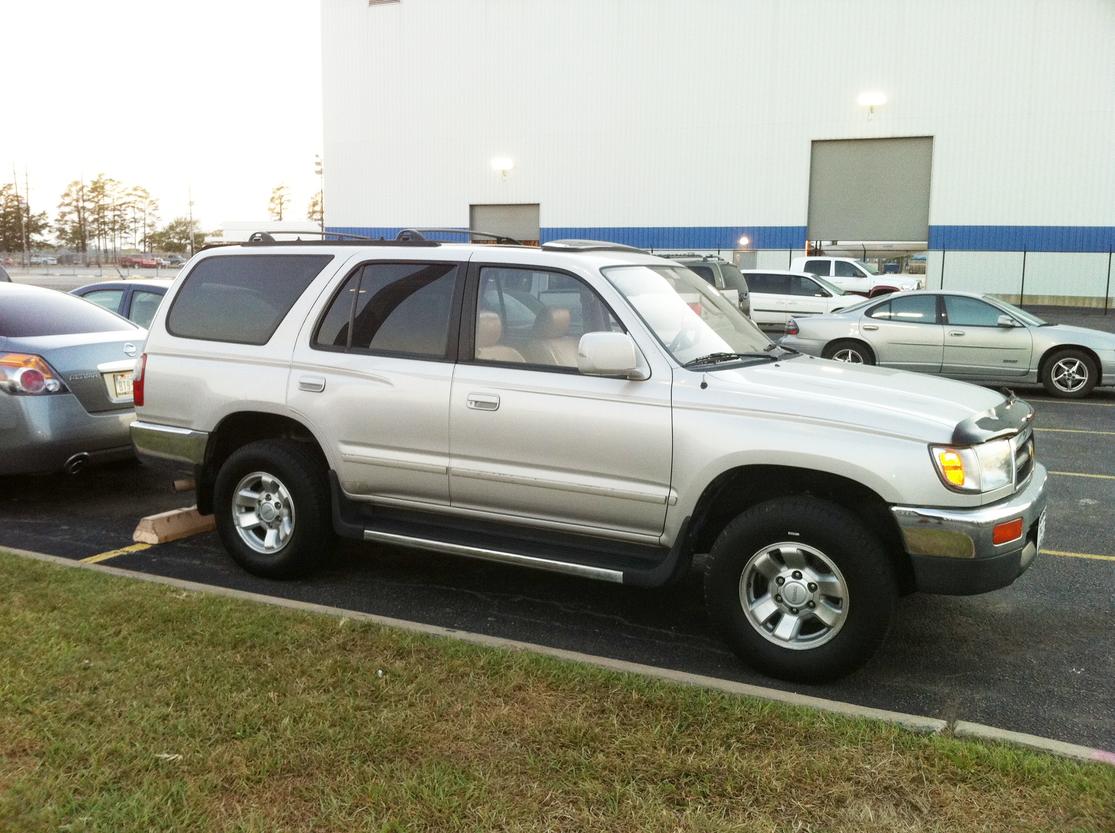

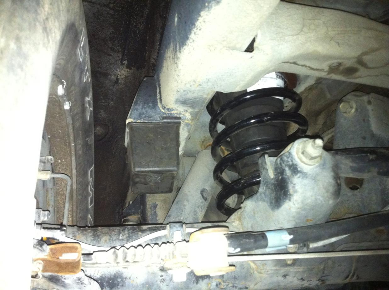

Pictures of my 4Runner & the NEW Upgrade parts installed by the Dealer today.:lol::drummer:
