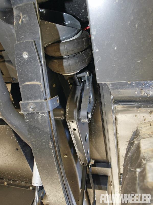

I figured this might be the best place to post this... I thought one of the various skilled fabricators might take a look at this and think *Hell, I can make that!* because I think there could be market in this crowd. After all, sag seems to plague our 4r's and many people run at least some extra weight on a regular basis over the rear axle.
Found this picture here: 1970 GMC Pickup: Fantastic Flatbed - Four Wheeler Magazine
Apparently the guy is getting 12" of travel out of a 4" airbag. I'm not sure that's even travel for the hardcore guys, but for the expedition wheelers and those who want to keep a set of softer springs it might be good stuff.
