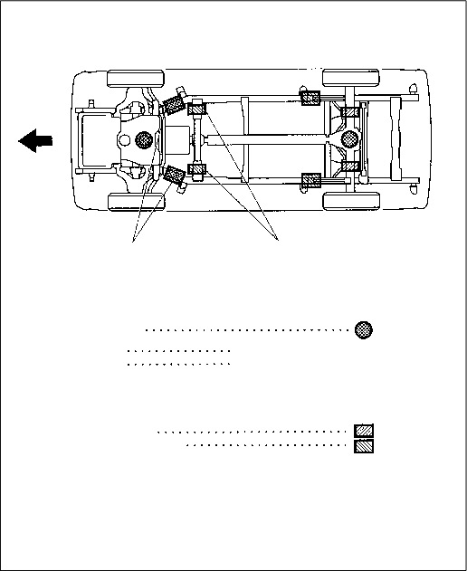

Thanks downpour 11 I have the Haynes manual here but it states many things to take off. Are there any specific lift spots on our 'runners or do I just have to find a nice solid, flat surface to lift from? Anyway, these coil springs are going in today...enough said. lol
Here's an attached pic from the FSM of the support locations (the shaded areas).
I haven't seen the instructions in the Haynes manual but it's as simple as my previous post. Especially since you're just replacing stock height springs. Easy as pie.
