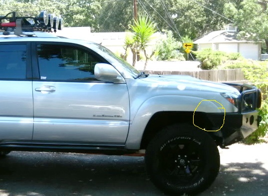

I don't agree that the 03-05 fits an aftermarket bumper better (with less gap). With the shrockworks, at least, you can choose how much gap you want when you are putting it on. The "gap" is to compensate for the body flex (considering the bumper is attached to the frame and flexes differently from the body). It is suggested to have a 0.5" minimum "gap" to compensate for this flex.

What I mean is, when you look at the side, The bumper looks like an extension of the fender lines. Theres no triangular gap. It looks like its designed for it(03-05). I haven't seen one close. Is it just me?
Ex. is the bumper in the josh truck.. you can't see a gap in the one that I circled?( compare to 06 installations)

Ok, now I understand what your saying, I thought you were talking about underneath the headlights more so.. but I could make mine sit tighter, maybe not that tight.
