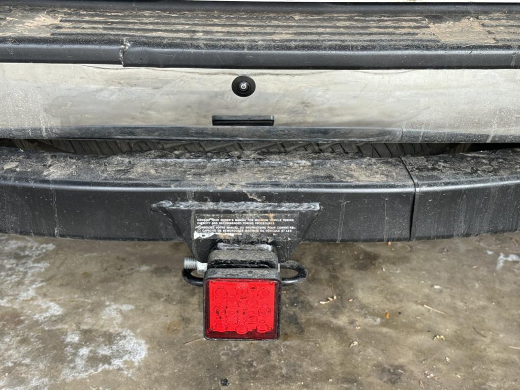

It comes with a hole saw and I installed in in the middle of the back bumper, flush mounted -
