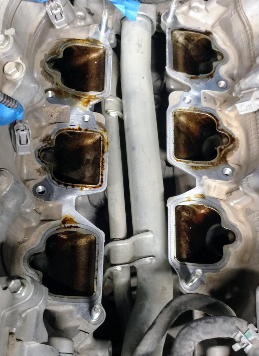

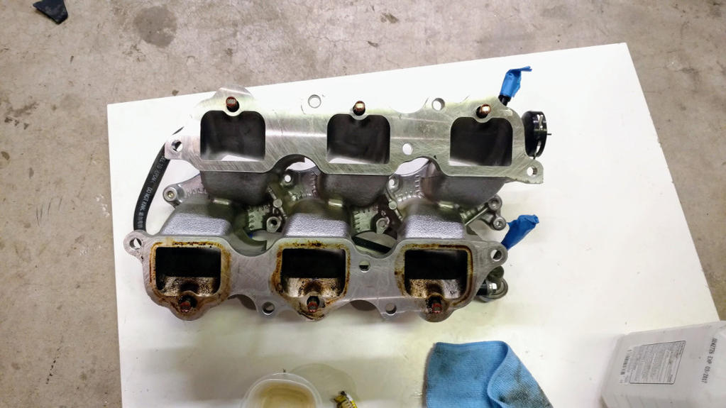

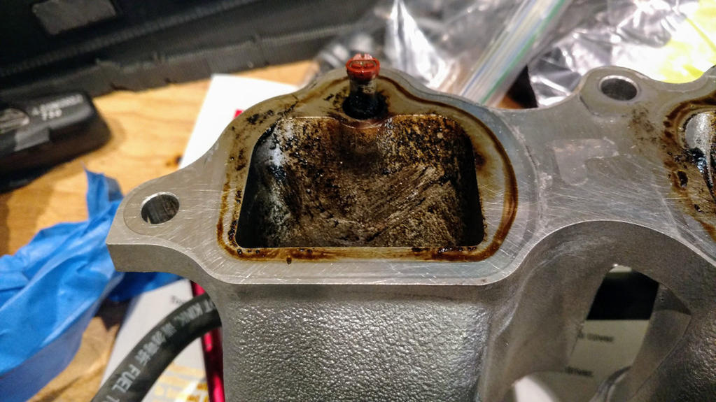

Here are some pictures of my 5th gen intake runners when I took my manifold off at about 70k (before I cleaned it). The truck had 45k on it when I got it and I put the catch can on at about 55k. It was pretty nasty and it appeared that most of the buildup was very old.
The ports after the injector were not bad and the chambers and pistons were nice and clean. But the intake runners were nasty. It cleaned up easy, but the consistency was like a partially dried glue.

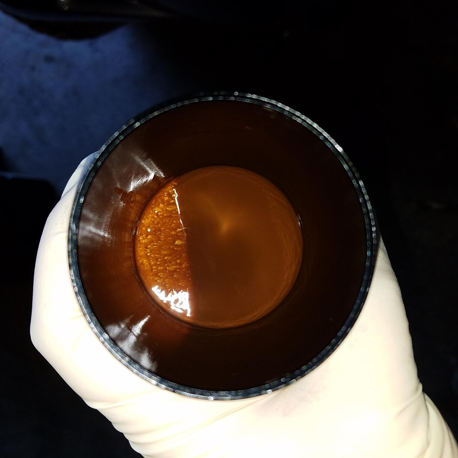

Did my normal 5000 mile oil change today and took a look inside the catch can. Not really sure how many miles are on it after install, maybe 2000 or so. Certainly doing it's job that's for sure. Majority of what was in there was water, likely condensation. Slight bit of oil, smelled like oil, glad to have kept this out of my engine.
