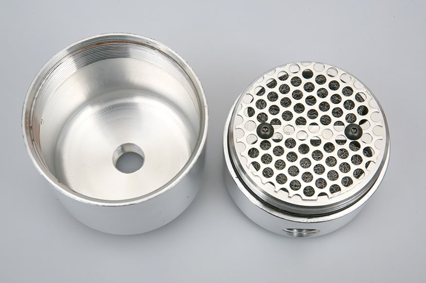

The can has encapsulated stainless steel mesh to capture the oil. The air has to travel through the mesh to go from inlet to outlet.. Then gravity lets the oil drip down through holes in a plate to the bottom of the can .

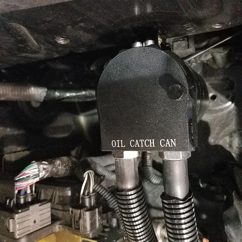

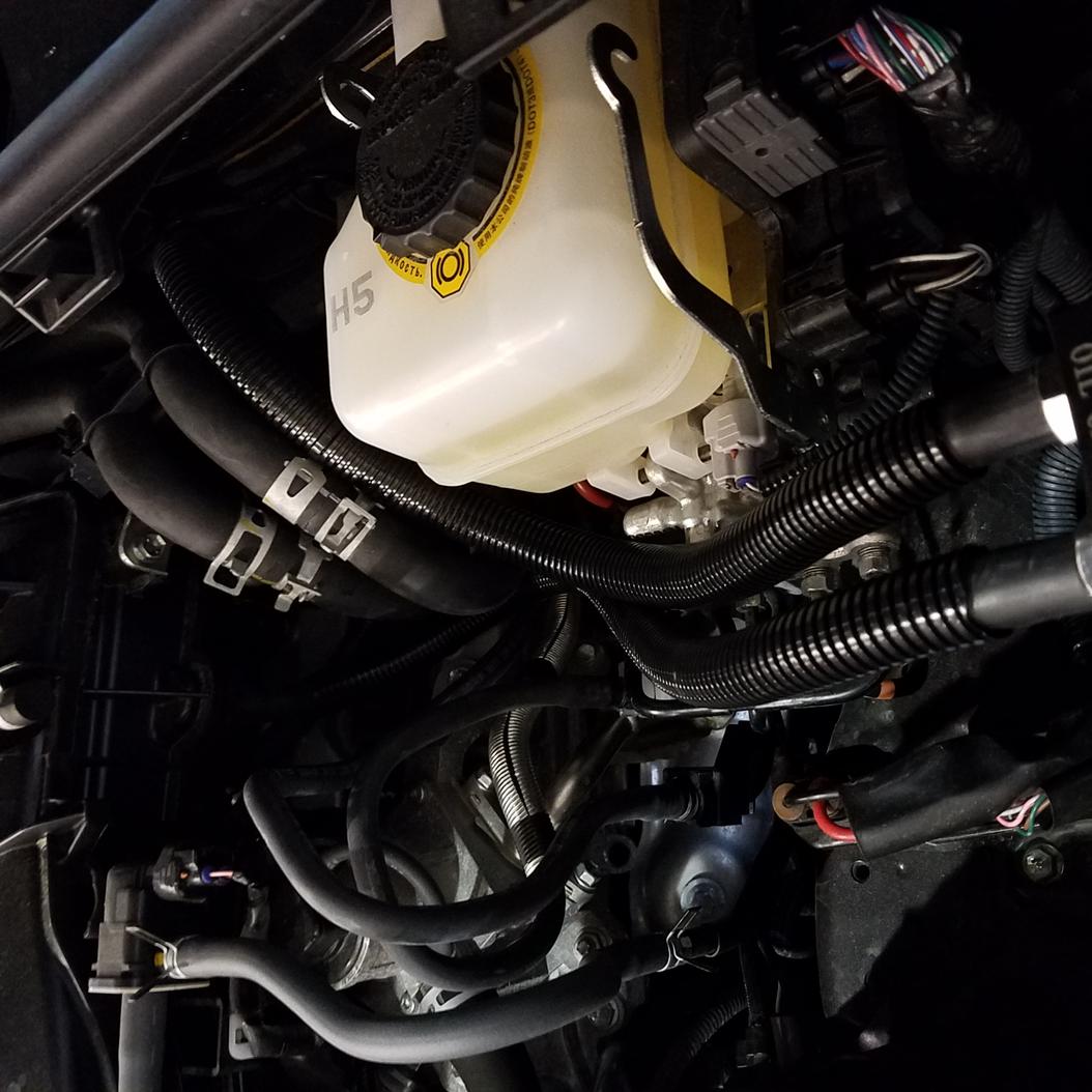

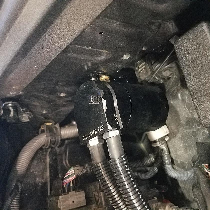

Install complete. Mounted the can on the driver side fender using one of the unused factory threaded holes. 3/8 vacuum hose from NAPA since the included hose was a joke and not vacuum hose. Put some loom on the hose to give it a factory look and will put clamps on the hose at the canister tomorrow. Forgot my clamp kit at home but really don't even need them, hoses fit snug.

I use the moroso can. There are many similar and they generally work the best. the picture shows how it is setup. There is a diverter in the middle which forces the air to go down and around. The mesh inside helps capture the oil and it drips down.....

It doesn't come with the breather even though it shows it as an option. I read the auction completely before buying it and it does say no breather is included. The top of the can is flat, not drilled or ported. Not finding oil in the can is more wishful thinking than anything lol. I do expect to find some but I don't expect to find much. Here's a picture of the can.
