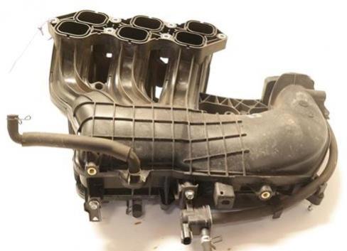

What inlet to use: upper or lower?
On intake manifold I see two inlets, one above another, lower, where hose from PCV valve terminated. I prefer to use upper one for oil can.
Upper inlet plugged, not sure both the same "internally".
Anyone knows are they the same? (sorry picture upside down)
Tnx.
Tnx.
You use the one that goes from the PCV valve to the intake manifold, this is the only way to do it. Go from the PCV valve into the catch can, out of the catch can into the intake manifold.
Your advise sound very authoritarian, that makes me even more to do opposite.
LOL do what you want. There is only one right way to do it, and that would be the way I explained it. Your truck though, have at it. Do you know what a catch can is for? It catches oil and water vapor that is vented out of the crank case. That vent is the PCV system which vents into the intake manifold for emissions reasons. The point is to put the catch can between the crank case and intake manifold so all that crap doesn't end up in the manifold and on your valves. What do I know though? :usa2:
