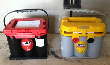

I ordered two new Optima for my setup
I replaced factory battery with a group 35 Optima,
Optima Batteries 8020-164 35 RedTop Starting Battery
Optima Batteries 8020-164 35 RedTop Starting Battery : Amazon.com : Automotive

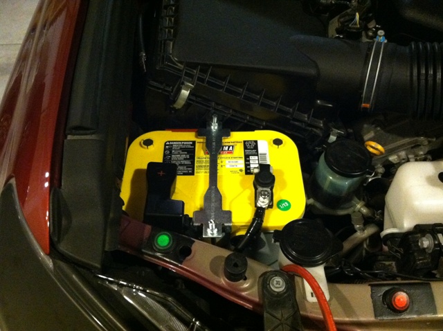

and the aux battery with a Group 34 Optima,
Optima 8014-045-FFP YellowTop Group 34/78 Deep Cycle Battery
The yellow top sits nice in tray with room to spare.
Optima 8014-045-FFP YellowTop Group 34/78 Deep Cycle Battery : Amazon.com : Automotive

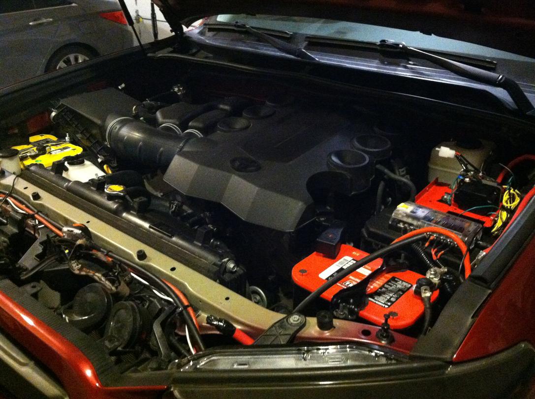

Well I finally got time to do my dual battery install. Thanks again to Shawn for organizing the buy on the ABR tray, great product, well thought out and good clear instructions, I think it is worth the $ for anyone considering getting one. I got these terminals and boots from Prime 4x4, they worked pretty nice. Military Battery Terminal and Boot Sets

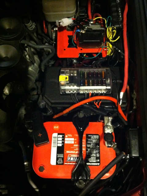

The installation of the IBS system went pretty smooth too, just lots of double checking on the wiring diagram and one trip to West Marine when I screwed up on one of the wiring terminals and needed another.
So on photo 3 and the bit of a rat's nest on the IBS wiring, anyone want to chime in on whether I should I jacket or tape those better? They are secure but seem to be hanging out there a bit? It is a little tight with the Warn controller there too. I think the main IBS relay is upside down but that worked better for the leads to the main and aux going in.
