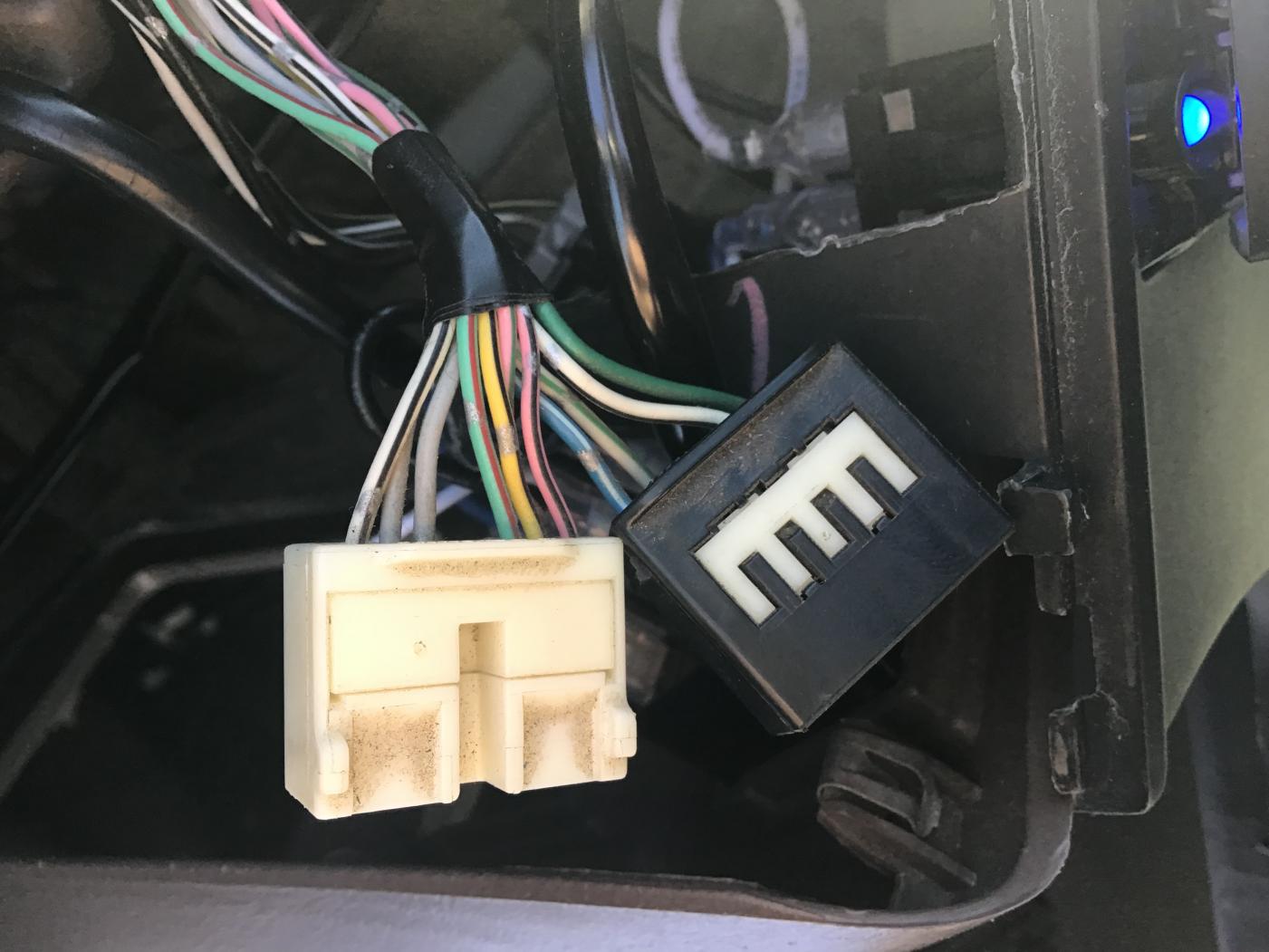

I'd like to revisit this, Sounds like this is a logical solution for those that have RR DIFF LOCK and all of the associated components in place and have grounded the Blue/red wire(diff lock anytime below 5mph in 4R's), I have 99 LTD with all of the above and would like the abs light to come on ideally, but I'm getting mixed feed back reading this thread, I would be ok with the results of what was originally posted but wanted to clear a few things up if someone can help.
The 99 4wheel drive control/RRDIFFLOCK is black plastic #89533-35070/#179600-0201
Questions
Does one TAP/splice into the Yellow/blue stripe#1 wire with a switch of choice that is grounded?.
Or Does one cut the Yellow/blue wire and connect the switch to the plug side/4WD/RRDIFFLOCK LOCK ECU and ground the other side of the switch of choice(Leaving the other cut end of Yellow/blue wire unattached)?.
Will my ABS light illuminate on the dash(good indication abs is non functional)?
Has anyone done this without a hiccup and a functionally disabled ABS, illuminated.
Hi! I don't see the blue and yellow wire. Witch one is-it?
Thanks!
