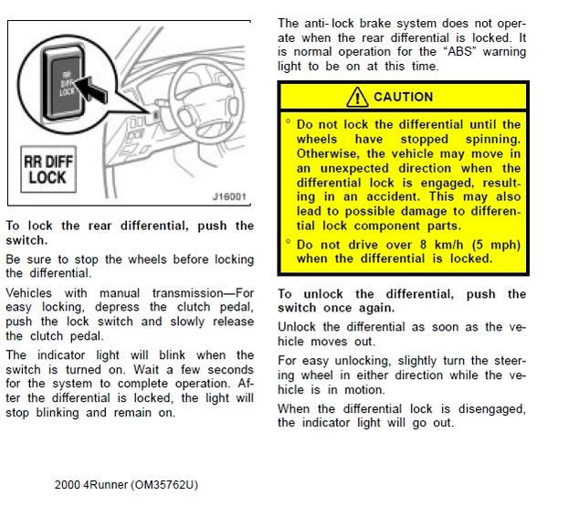

As for the mod, whats strange is that in mine the when I lock the diff, both the diff lock and ABS light illuminate.
You guys make me glad I tested mine before I bought it.
That is weird. The ABS light would signify a malfunction.
But it goes away when you unlock your diff. Does your ABS work normally when the diff is unlocked?
The ABS is shut off when locker is on. I wanna ditch my ABS all together. It sucks off road, and is a complete POS on ice. If I would get off my a$$ and get my hub swap done, so will the nasty ABS.
ABS light illuminates to signal that the system is not operating. Mine works as described in the owner manual, and yes, the ABS system functions as it should when unlocked. I'm not sure why your mod doesn't light the ABS light if it is disabled.

Interesting. I'm going to have to try to lock up the brakes to see if my ABS is disabled.

The ABS light does come on when you lock your diff normally, and ABS is disabled while locked.
You have to have the locker ECU to do this mod.
Apparently some non-locked vehicles have the locker ECU because they are pre-wired for it.
That's it. It sounds like Gerdo is pre-wired for a locker, so he was able to do it.

So your ABS light was on and the ABS system worked?
After doing the mod just as you described, only the RR Diff Lock light comes on. The ABS light does not and therefor the ABS is still active.
I really want to make this work before I start snow wheeling this year. I don't have a wiring diagram.
