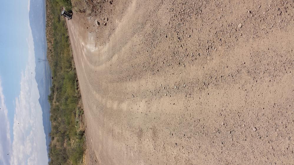

Sunday may 31st I was driving on a gravel road outside Tucson. I was driving careful maybe 27-30mph. Experienced a slight rear break out, controlled it. The road went down hill and veered right. I applied the brake to slow down( had already regained control) the moment I did, the abs kicked in and the truck shook like a paint shaker. I the truck didn't slow down, instead this caused the back to break free again, but worse. I down shifted to 2nd and kept on the brake, till I impacted the road bank mostly head on at approximately 22-25mph. The back came up, the road sloped, that and the not direct hit caused the truck to tumble. I rolled nearly end over end for about 20-30yards, before coming to rest on my driver door 180 degrees from original direction of travel. My truck is dead. I am sad. This is bull, it's meant to drive on dirt roads. Check the pictures and switch your abs off. I liked it for pavement, dirt is dangerous . Any ideas on contacting Toyota proper would be helpful y'all. So now I'm alive unhurt and driving a car. Urrrrrr to abs. Note the " chatter mark" from pulsing abs. 15 percent brakin power at most
