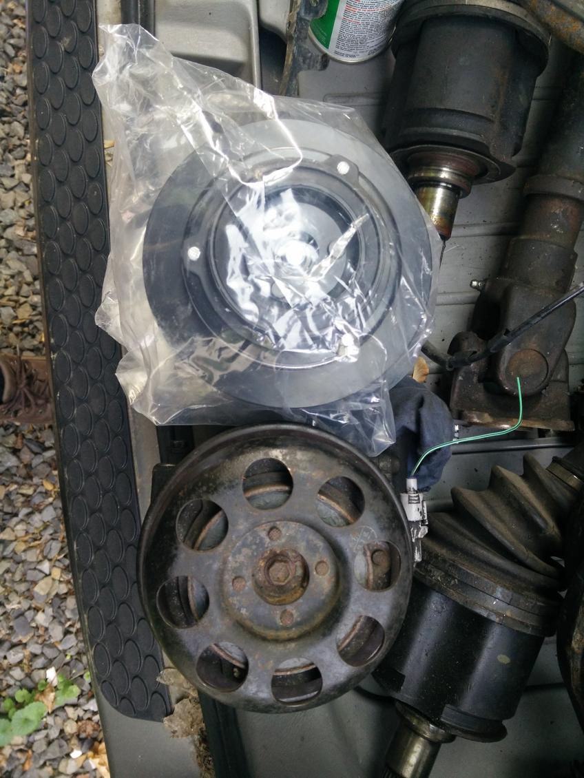

Well trying to replace my Ac compressor with one from advance auto, after I installed everything Ac belt wouldn't fit. Noticed actual Ac compressor pulley is larger then OEM pulley as anyone else had this issue dont want to order one from rockauto etc and have same issue.
99 3.4 manual 4wd

Hate to say it man but return that to AutoZone and order you the right Denso compressor from Amazon. I did a complete and total rebuild of my AC system on my 2000 T4R with Denso parts from Amazon and did not spend more than $195.71 on the Denso compressor and it was an EXACT fit. (Part#88310-35770-84)
