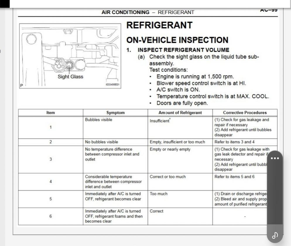

The sight glass diagnosis fsm
I used this chart and didn’t come up with anything. I took a few pictures and a video but can’t figure out how to post them. I was low on refrigerant again so I have a leak somewhere. Any suggestions on how to diagnose the leak? I use the AC Pro refrigerant to fill it up. Do they make one with dye to check for leaks? Is there a better solution?
