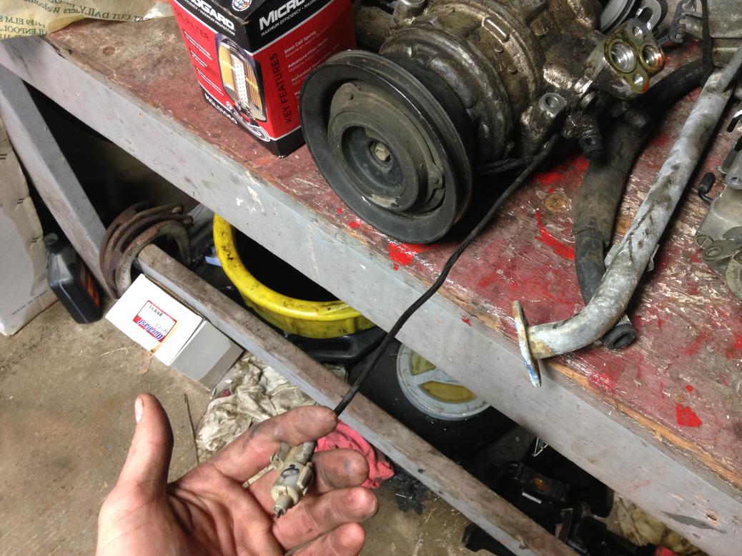

Rebuilding my engine and come across this...anyone know where this is supposed to go?

If you have a 22RE, the other end is a single wire coming from the main harness near the battery. Black with a blue tracer if I remember correctly--not 100% on that.
Probably broken, not cut. It is a frail, thin gauge piece of wire and easy to forget to disconnect when motor pulling.
Just looked in the manual for the wiring diagram, it says clutch is:
B-W(22R)
L-B (22RE/RTE)
I believe "L" is bLue, and B should be Black, so yes, it should be black with blue stripe!
Sorry, forgot to specify the engine. It's a 3VZE. Gonna run by salvage yard today and see if I can get another one to just splice in to my harness

I couldn't get the whole wire so I just cut the connections off and was going to get some new wire and basically make a new one but if you have the whole wire that'd be even better

Well after a closer look I may be able to just put a new connector on my harness wire pretty easy, but I'll let you know for sure. I appreciate it
