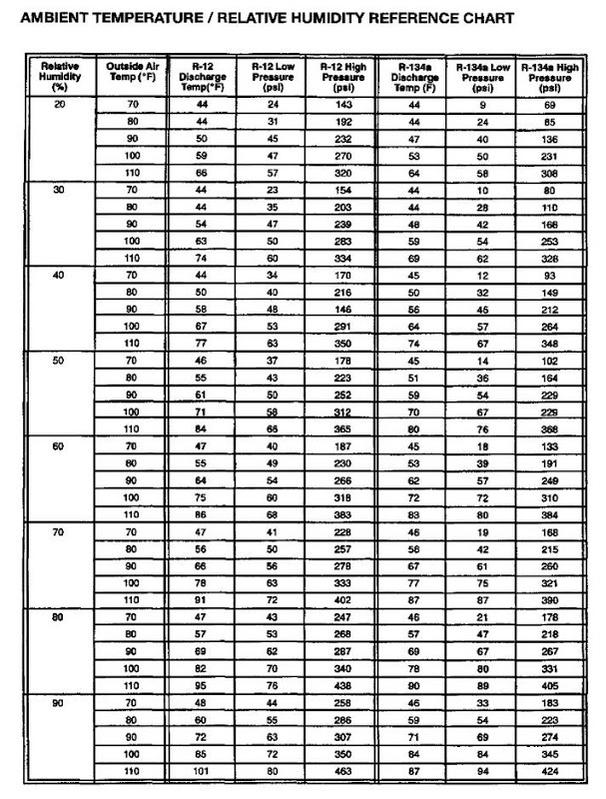

Hey guys was wondering if anyone has ice cold ac. I've read the 3rd gens are not known for great ac, had mine checked in spring. It was pressure tested and recharged . No leaks to be found. Anyway sometimes it doesn't seem that cold. Yesterday was pretty hot here in NJ and I felt the ac wasnt blowing cold. I did check it with temp gun and it's right in the low 40s. Can anyone chime in?

If its blowing in the low 40s thats about right I believe. Are you recirculating air or venting air?
I have the same problem with my black Town Car. My mechanic vacuum and charge. It work better. But he said that it could be the heater doesn't close all the way..
If I remember right it should be coming out of your vents about about 41-43 degrees. It works best if you are recirculating your air as well.
Low 40's is amazing, its working perfect. If your car it super hot it will just take a little bit. turn on recycle for max cooling.
Also when you first get in, roll down all you windows and let all that heat get out.
Low to mid 40s is typical for me as well when driving. Doesn't really matter what the outside air temp is, it stays the same whether it's 100 or 70. A/C always blows out around 43 or so...unless the truck isn't moving of course.

Wow. The exit temp is affected hugely by both humidity and ambient temp. To compare exit temps for the same truck between some guy in Arizona and another in NJ without stating these parameters specifically is really sort of silly. The attached chart gives pretty much the best an R-134a system can do at various temps and humidities, as well as the theoretical low and high side pressures.
My truck, with all original A/C, but periodic R-134a injections performs to this chart in this humid NJ summer. She cools just fine.
All that said, 40's sounds pretty good. At 80°F and 80% humidity (typical NJ summer day this year), nominal exit temp with R-134a is 57°F.
