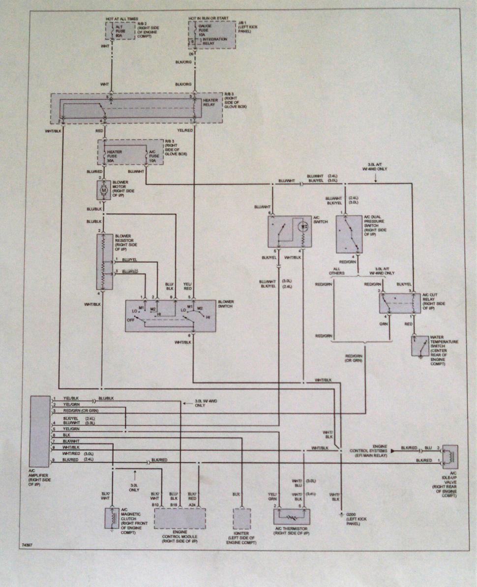

So yesterday I went to one of my dads friends shop who has a machine for 134a systems to get it charged up. The system passed the vacuum test and took 1.74lbs of refrigerant with no leaks. He has me start it up to kick on the compressor and nothing. The switch didnt even light up. He printed me out a wiring digram of the ac system to start checking stuff.
I've checked the fuses behind the glove box, and used a test light to check for power at the switch and nothing there. The blower works fine. I've read about jumping the magnetic clutch in order to get the refrigerant circulating due to one of the pressure switches not allowing the system to kick on like I should, and it sounds like it is not the best for the compressor.
So what I'm asking is if anyone has done/had something like this happen to them and if so did you get it working. I includes the wiring digram for others to maybe point out something else that I need to check.
