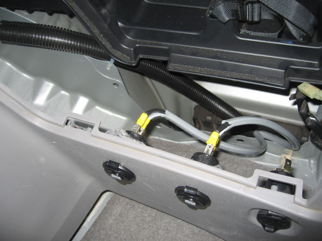

Added 12v adapter in back and front to Add a Circuit
I did something similiar.
1. Added 2 West Marine 12v adapter that are ALWAYS ON power to the rear, next to the one that is switched. Just like in the pic.
2. Ran the 14ga wire all the way to the left side fuse panel
3. Used a add a circuit to add the fusing for the run.
4. Added another 12v just below the ign. key about 8-9" or so.. looks real clean. The West marine adapters look great. This one is also always on .. too.
5. earlier i did the fuse block relay jumper
Pic. Showing the similiar extra 12v in right rear.
Pic. Constant power mod.... the best! i love it.
good luck, Mojav
