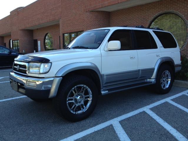

Pictures below

Very Nice. Love the white!
Welcome aboard & hope to see ya around town.
Just be diligent with the maintenance and it'll just keep on going.
