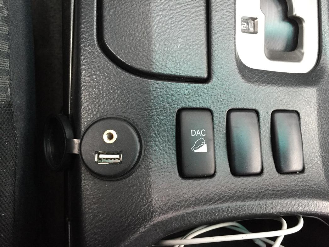

I don't have ass warmer :biggrin2:, so i got the USB mounted next to the DAC switch. This spot is very convenient to me since it is close to the flip out tray, where my phone is placed there
[/URL]~original[/IMG] all the time :cool:
Nice! I'll probably be using the same spot -- kind of wish it wasn't curved in that area, but oh well! I use the pocket as well to keep my phone in there.
