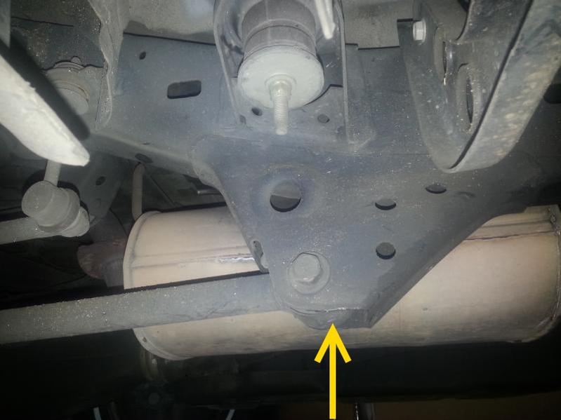

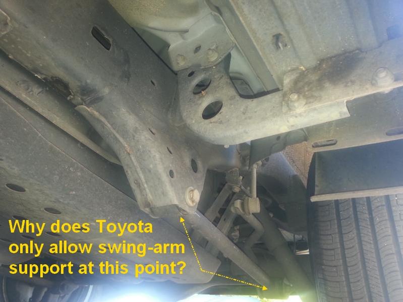

That point was not lost on me that the spot on the "thing" that is just in front of the rear wheels (see photo below on the SUV I was working on) is strong enough for a swing-arm lift, so why isn't it the right place for a jack stand?
Rather, that point is unstable when using a jack stand. The suspension arm moves relative to the frame, and when the suspension droops it can push the top of the jack stand forward and cause it to pop out of position. That's not a concern with a swing arm lift.
Oooooh. I see. I think ...
So what you're saying is that, for some jobs, that suspension point (what is it physically called?) can move whereas the axle won't move?
I'll stand by my original advice. Use the rear axle if you're changing tires or doing brakes, wheel bearings, etc.
I think the axle should be fine. It's just lower than the suspension "bulb" (what is it called) that I had used. But other than that, using the rear axle should be fine. I just didn't know it when I changed the four wheels and tires.
If you're working on the rear suspension you will have to support the vehicle by the frame. It's safe to do so as long as you make sure the support is secure and stable.
You said "frame" but here is a picture of the underside of the 4Runner I was working on, just in front of the rear tires.
Where is the "frame" in these two photos?

The frame is the two large box beams running front to back underneath the vehicle, plus the connecting crossmembers. The control arm bracket you show in your first picture is welded to the frame above it.
Generally the most solid place to lift or support the 4runner is any flat place under the frame. That control arm bracket is not so good because it's too easy for a jack or stand to slip off it. Just forward of that would be better.

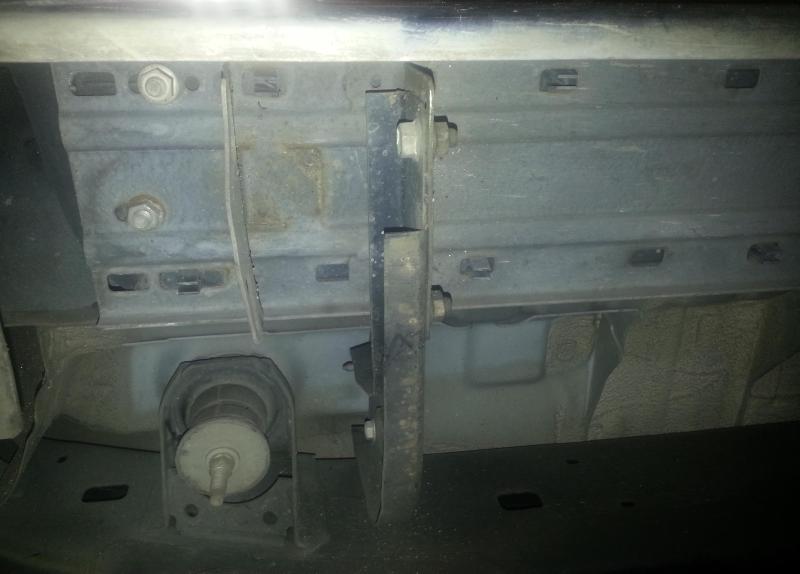

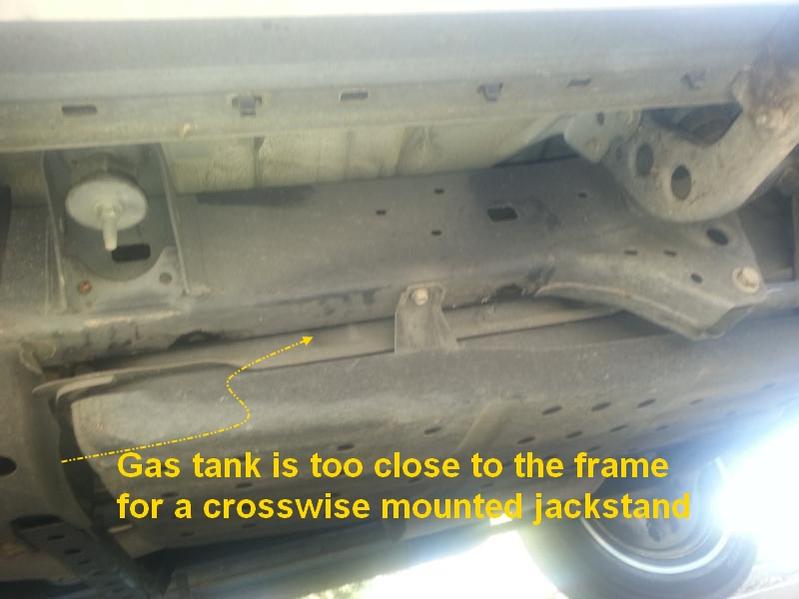

I guess my stumbling block in using the "rest" of the frame in front of the rear tire is that the gas tank proximity precludes putting the jack stands in the crosswise (perpendicular) position on that frame (for fear of puncturing the tank or denting the shield).
So it seems to me, intuitively, the jackstand head has to be placed in line (parallel) to the frame, which is, to me, a substandard position.
Which way (parallel or perpendicular to the frame) do you place your safety stands?
Except that the gas tank is in the way, is it not?
I guess for these two reasons, that Toyota decided NOT to allow jack stands in those two spots:
  1. The control-arm bracket is problematic
  2. The frame in front of the control-arm bracket is problematic
