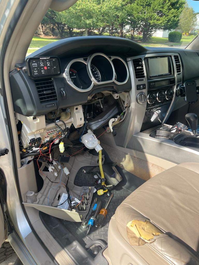

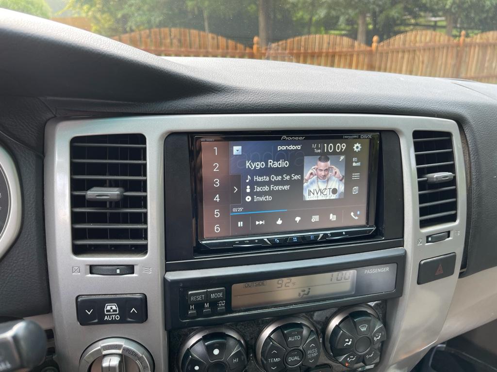

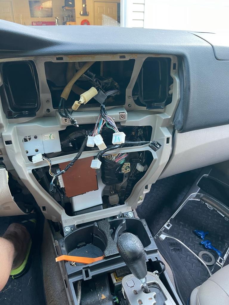

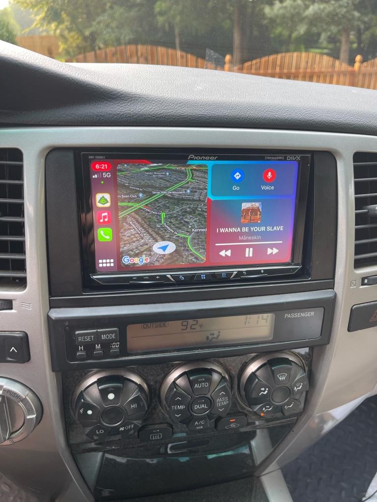

Went though the tedious process of wiring in a head unit I got from my buddy. Took a few more connectors and adapters but ended up working out great. I now have awesome sound, smart phone compatibility and cameras that I’m working on wiring in.
The goal is to have a front and rear camera,as well as 2 under the car in the case I don’t have a spotter.
Well, after hours of wiring and testing on the car I scrapped the idea of multiple cameras/undercar cameras, etc and just wired in 1 standard back up camera that I can call up on demand, not just in reverse. Too much wiring for the others for something I'll realistically probably never use.

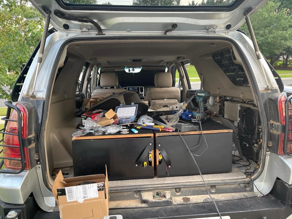

After I put in the new head unit I quickly found out how old and tired my factory JBL speakers were. The sub was blown, but the speakers were still hanging on a bit, however I decided that if I'm going to change one thing I may as well do it all. Well, $400 bucks later via Crutchfield and I have all 8 speakers/tweeters and the rear sub replaced. I elected to disconnect and scrap the dashboard speaker since my dash cover I got did not have provision for the speaker anyway.
The front and rear door speakers were an absolute breeze, the tweeters took a bit of clipping and soldering but were also quick. The rear sub was a bit of a pain with my drawer system needing to be unbolted so that I can pull the rear trim to access the sub. All in all, for about $700 bucks, my rig is now modernized with some amazing sound, apple car play and back up camera. Now.... what can I manage to dump some more money into next???

that should be all you need really... I fought it for a while before realizing i needed that conversion module for the JBL system. If you start with it on hand and just follow the instructions it's pretty straightforward. I didn't document exact wiring I did, but like I mentioned, once I found out I need that little black box to go in between the factory plugs and the new headunit everything powered right on and plays awesome. The Maestro also just follow instructions, you plug it into a laptop/pc and download the necessary firmware for the specific car, it then lets you configure the button controls to pass to the radio. I started thinking I didn't need it, but it has been super convenient to use the steering control with the new unit.
The sub was the hardest to replace just because I have a drawer system I didnt want to take out and you ahve to pull apart half of the back trim to get to it. The wiring that came with the kits from crutchfield pretty much plugged right into factory, took me like 2 hours to do all the speakers. There were 2 or 4 smaller speaker (in the way aback and the 2 dfront door ones I believe) that I had to solder a component onto that came with it, but it literally looks like the factory speaker you pull out so it's supper easy. A lot of this wont make sense now since I don't have pictures, but I promise once you start going its a very straightforward process if you've done any sort of wiring prior. The sound (for an almost 20 year old car) is phenomenal. I mean its not a lexus or a new bmw or anything, but its super crisp and plenty loud. If you are using android Auto or Apple Carplay, make sure you get an extended USB cable to run out from the back of the radio into a useful spot since all of the current car play and android auto is over a hard connection and not bluetooth. I'll say that playing sound over the cable via carplay is significantly nicer, more clear and loud than bluetooth, but both are good.

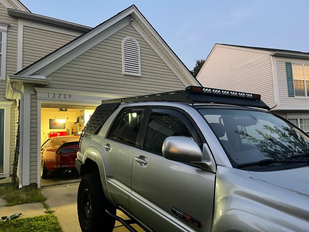

Missed taco Tuesday by a bit…, but the lighting at work this morning was awesome so here we are… no new updates that are major on the rig, so far so good, just needs to see more off-road time !

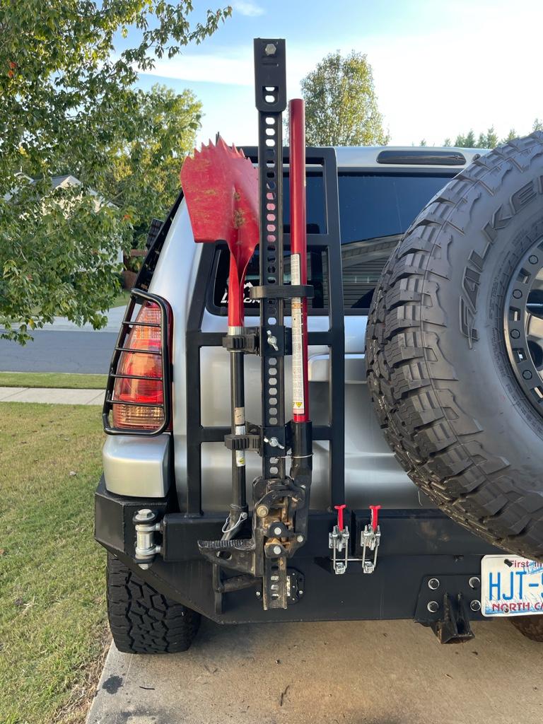

Found out that my genius idea of storing recovery gear in the pull out drawer system has a bit of a flaw… when you’re stuck facing 45degrees up and need to open the lift gate and then slide open the drawer it is less than ideal… so I am now evaluating my options lol. For overlanding it is probably more than OK since I don’t plan on being in a situation where I’d be stuck that way.. but for off-road trips it will probably be best to take out the bags of necessary gear and just leave on the floorboard in the rear for easier access..

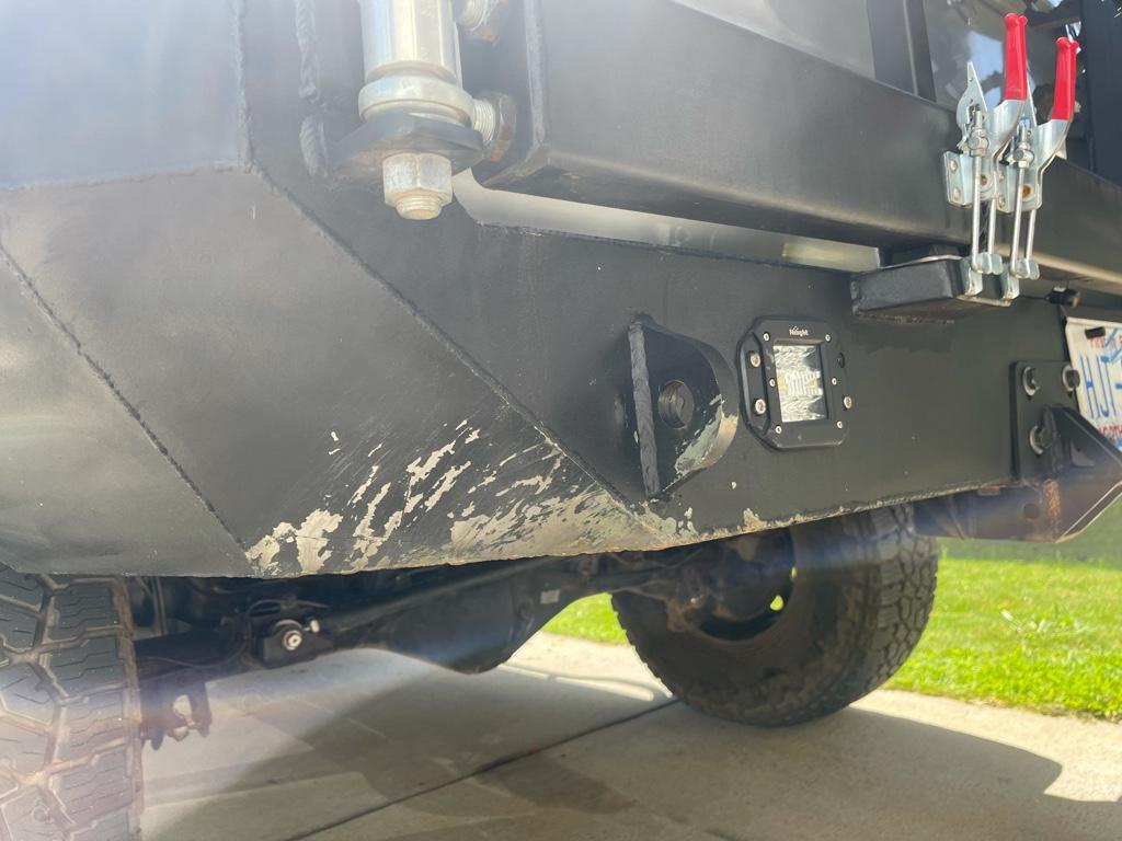

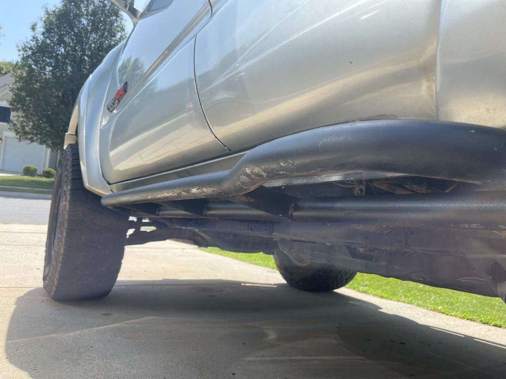

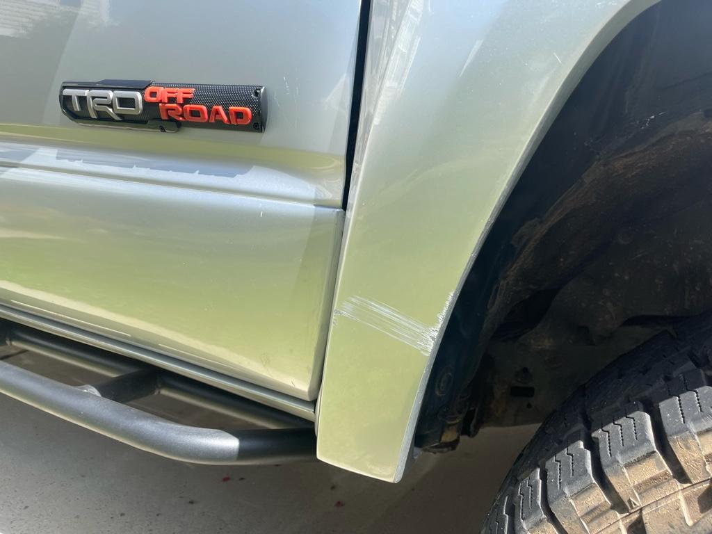

Got wedged on the rear bumper going up the ledge in Daniel, bounced the rock slider on the outer most point and bent it up to where my rear door would hit it, scuffed up both fenders (luckily no cracks lol) and my front bumper, took chunks out of my wheels, etc, but overall nothing that some spray paint didn’t take care of :)

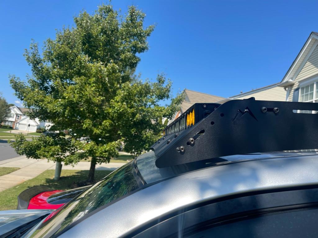

I also ditched my personal roof rack design I was working on (started a new job and don’t have time to keep tinkering with design changes) so I picked up a local Marlin roof rack side rails and used my cross bars and fairing, much sturdier than mine, I love it.

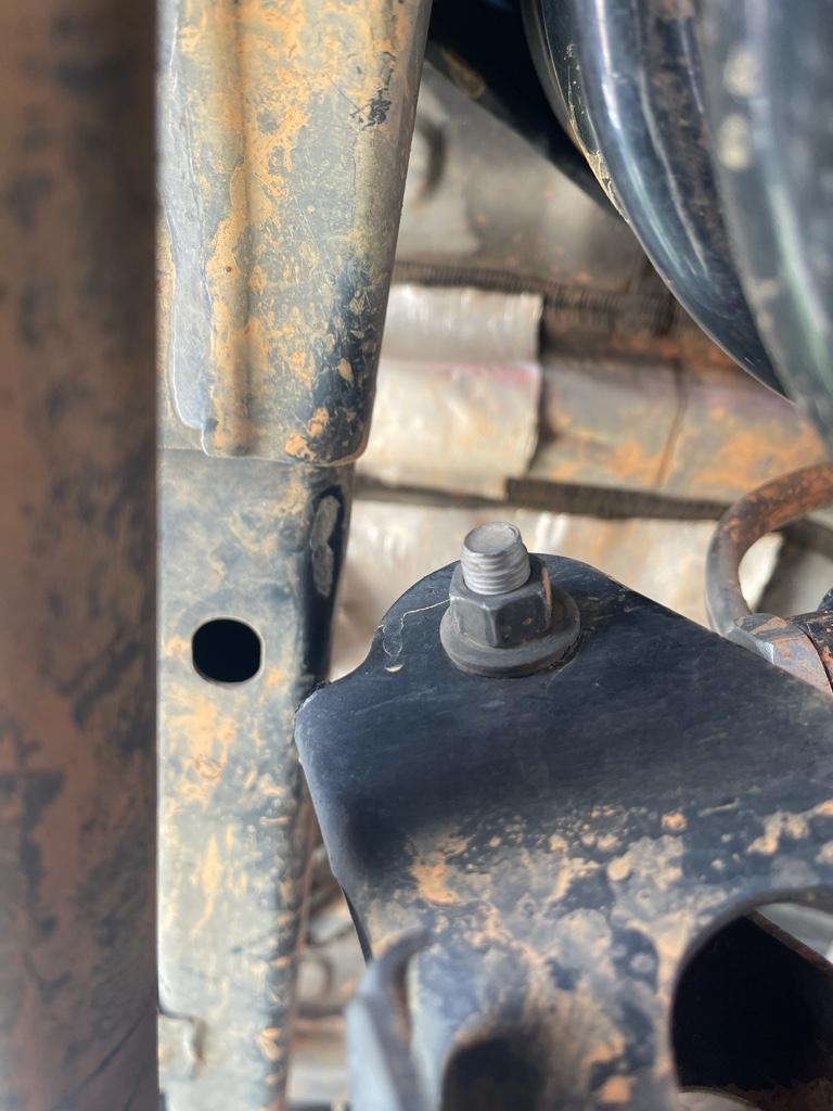

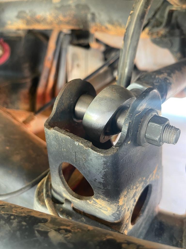

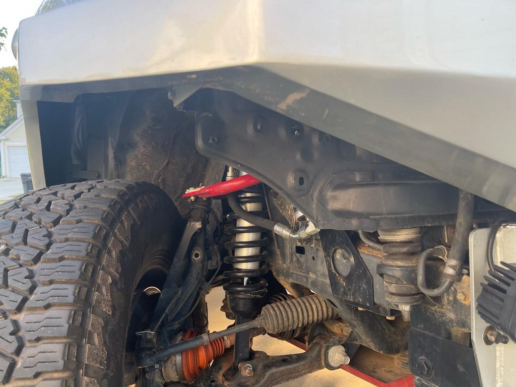

Found the source of my bottoming out thud when going over large drops/bumps.. the passenger side upper link pick up is hitting the cross member above that holds the pan hard tie in .. strange .. this member is asymmetric and lower in the passenger side so the other side rims fine.. now that I know what’s going on I feel good, but may end up notching the member to make clearance later.. any other 4th gen guys seeing this ?? I feel like I had this same sound when I was almost stock with minor lift and factory links..
Also installed an attic cargo storage I pieced together from Amazon. Net, 4 upgraded D rings and 2 36 inch bungee cords for added weight capacity, 10 minute install, mounted right behind the handles and rear storage hooks with factory bolts and all. Should make some good storage space up top for soft thing like blankets, covers, pillows , etc. not bad for 28 bucks and 10 minutes of work.

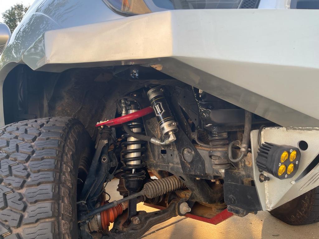

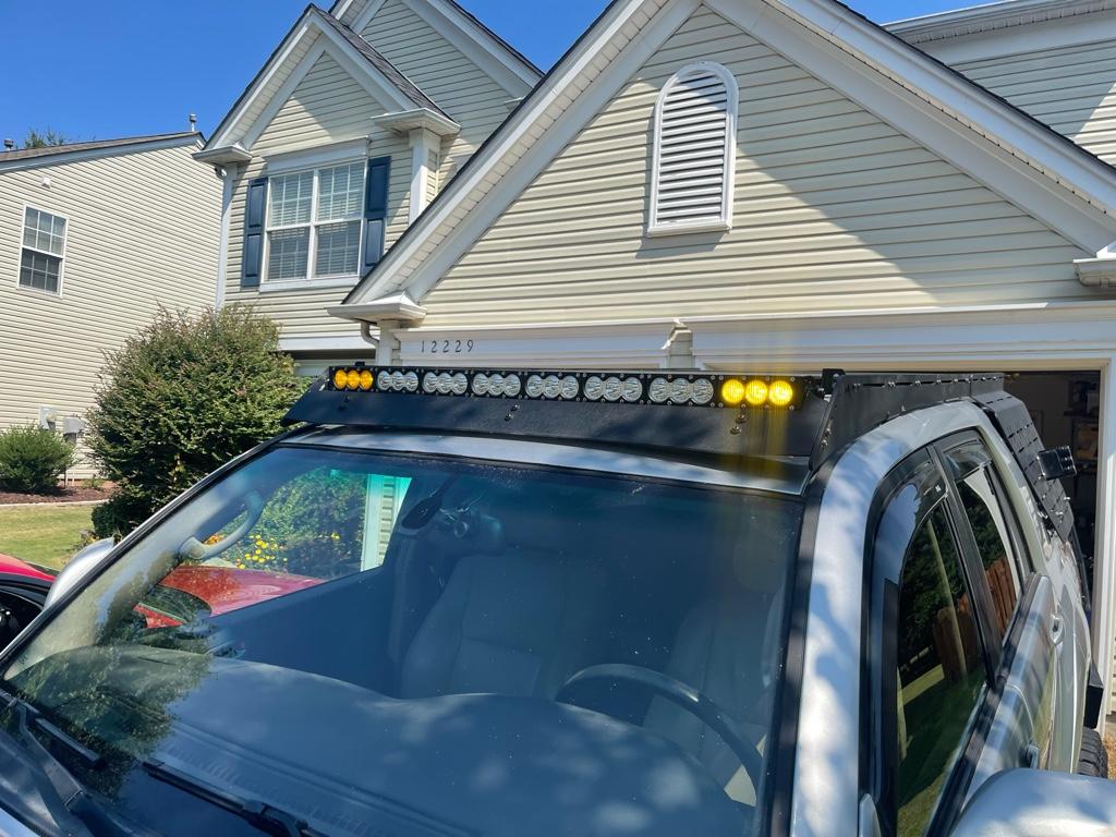

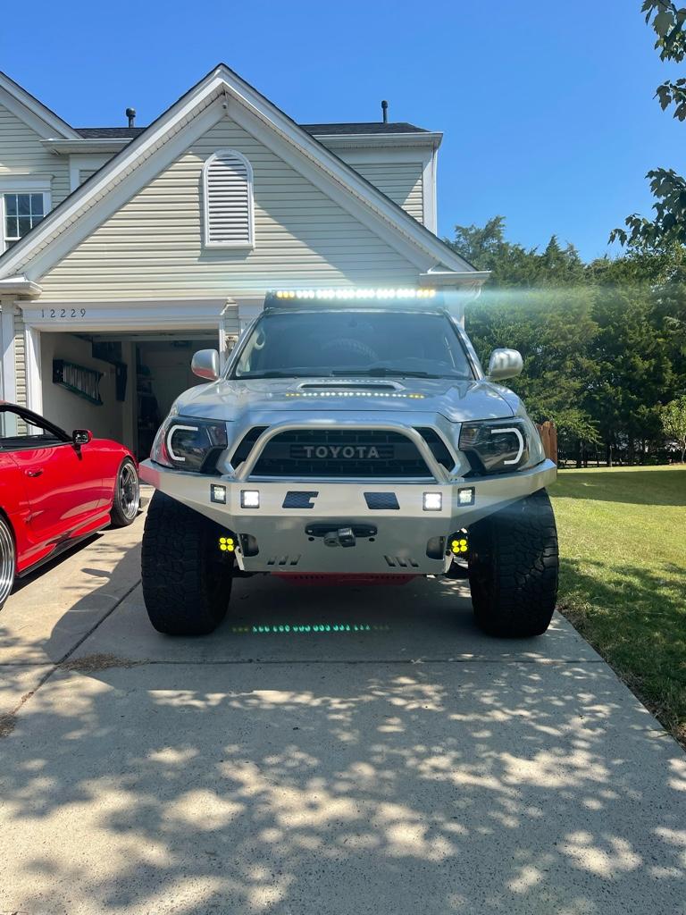

Also lowered the front fairing a bit and dropped the light bar to be more flush, love how it all fitted together.

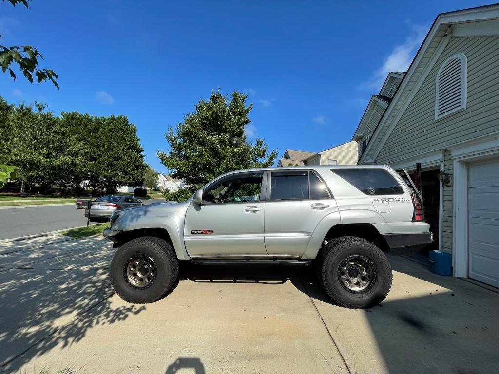

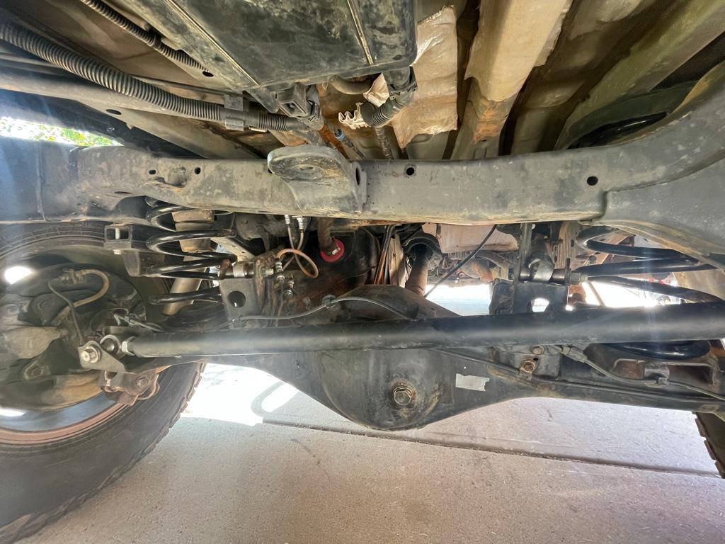

Seems like I got the rear interference issue sorted out, i think I had the upper links adjusted way too far out. Reduced it some and hit a few large speed bump without any contact yet, the next trail ride will be the real test.

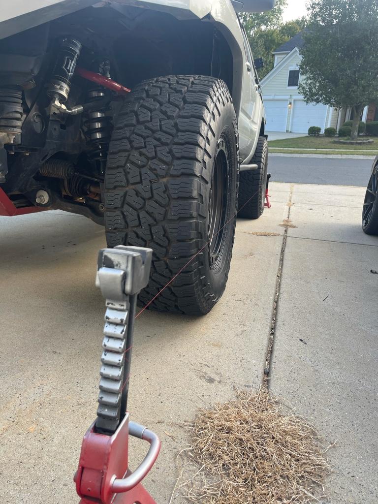

Over the last 2 days i have been REALLY throwing around the idea of fitting 37's on the car (mainly because I get bored very quickly, but also because I believe with a bit of modification I shouldn't have any issues) but after long searching of various routes (including going with a larger FJ 6" lift, going through various long travel options, etc I decided all my parts are still too new and not even close to used to justify diving into a change that big.. I don't want to run 37's just to run them if they are going to limit up-travel, turning radius, etc... if I ever run them, it would more than likely need to be accompanied by some variation of a long travel set up, both front and rear... so I guess 37's it is for now..

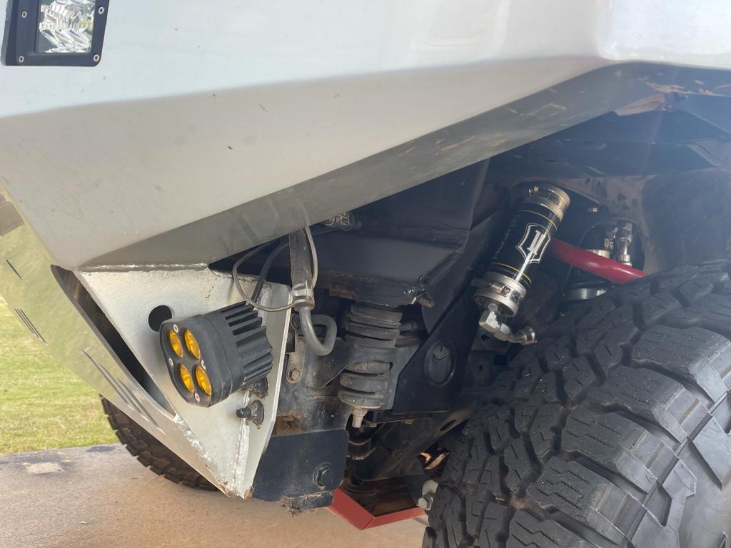

With that said, I found areas of interference that I've been hearing on trails.. looks like my very bottom corner of the pinch weld was still making contact at 50% turn so I took out my handy grinder and hammer and went to town making more clearance on the inner fenders. I broke the hammer... so i'll have to finish up tomorrow lol. After I'm done with it, I believe that there will be 0 point of contact from the tire at any angle or height, time will tell.
I also believe that me installing the 1" spacer somehow got rid of the tire rubbing the frame rail issue.. I don't see any paint-rub off at all anymore from the last time I coated it.. I'll have to do some more flex testing and verifying next time I'm out on the trails.

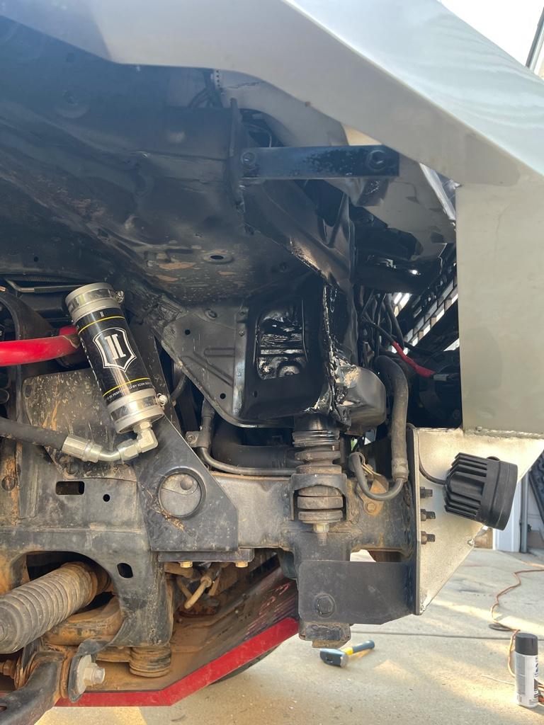

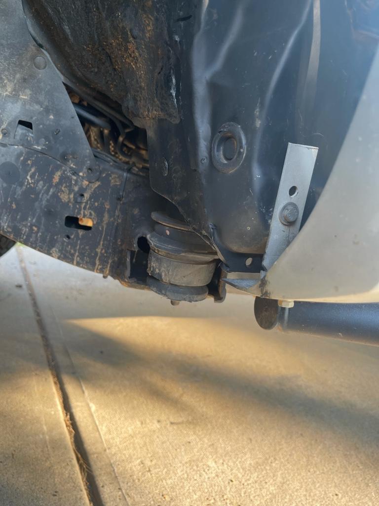

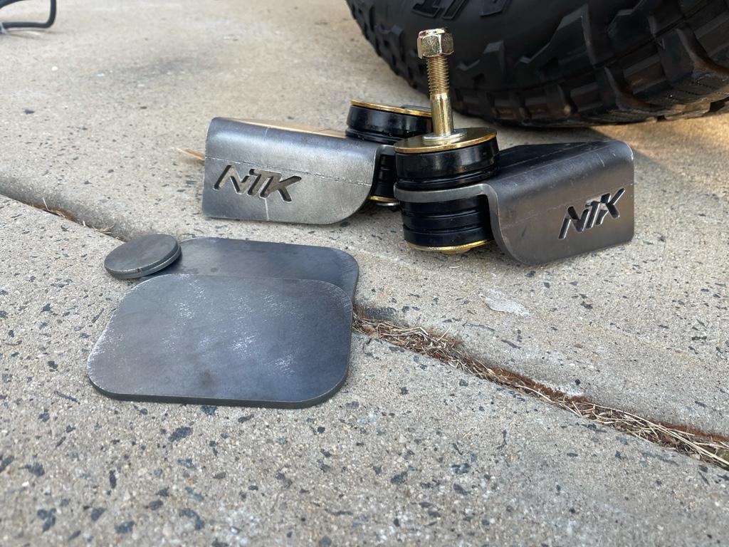

Got my NTK body mount relocation kit in the mail today! Not looking forward to cutting off the old one but can’t wait to have this don’t and extra clearance made.

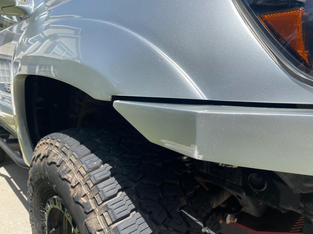

Spent some time hammering some more on the wheel well pinch weld where it still rubber way at the bottom. I am fairly confident I can fit 37s with a bit of sledge hammer work up front and clear everything.. but the rear is rubbing both the door and bumper so I’m order to fit them there is need to cut the bumper back an inch, weld it shut again, and slide the axle back back some.. when it’s time for a tire change I’ll definitely revisit the idea… however the thought of daily driving on 37 and having to change out wheel bearing almost yearly bc of it doesn’t sound too fun.. lol. If I ever go long travel I’m definitely going to be rocking 37s no questions asked.. but the rig is so capable now(and all new lol) that it’s impossible to justify the cost and time to do it.. would look good though..
I also spent some time cutting down and beating flat on the remainder of the radiator support that you could see sticking out from behind the bumper, much better.

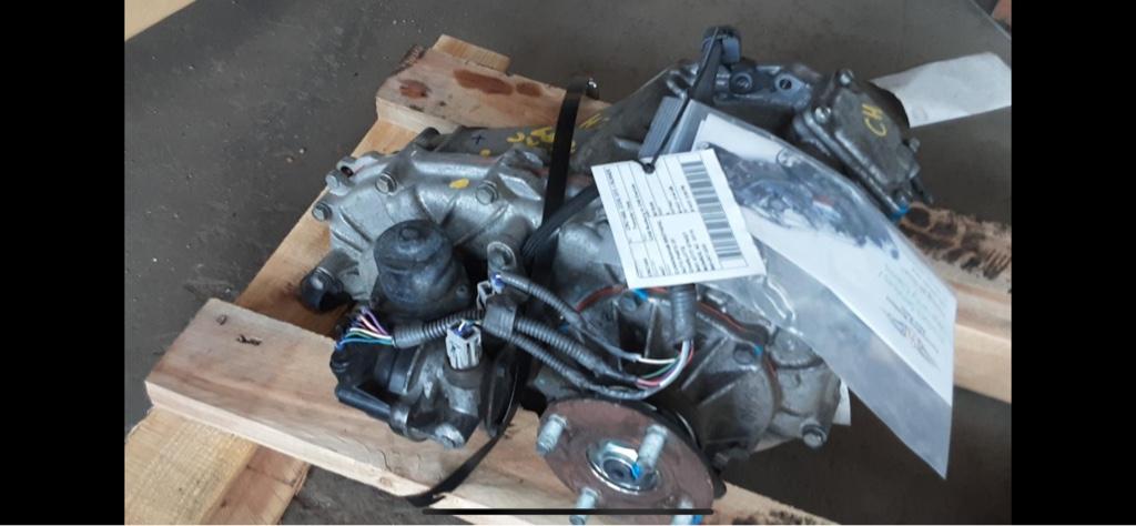

Well.. sure glad I asked for pictures of the tcase before going to pick it up. Not sure how they got it screwed up.. but the manual t case out of the 2015 4runner is not a manual tcase lol. I would have been PISSED if I drove 1.5 hours round trip for this thing.. lol.
They are showing an actual FJ cruiser case in stock with 139k miles for the same price so I’m having them check on that now. Hopefully it’s still there and I can pick it up tomorrow.
And speaking of the tcase.. (which we are sorting out now, they have a 2007 FJ with 118k miles for even cheaper that is coming out of a mom mobile that looks like it’s never seen any use at all) I got the first round of goodies to make the conversion happen.. I’m sure it’ll take some fabricating but I think these should work out nice.

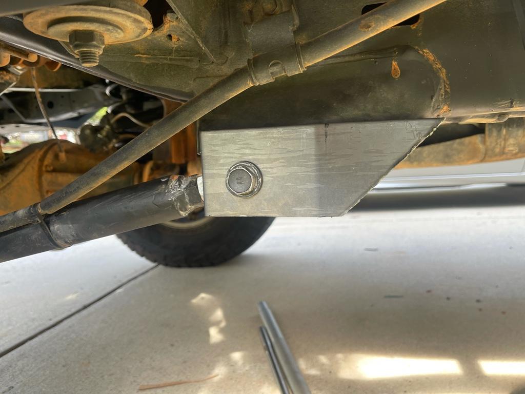

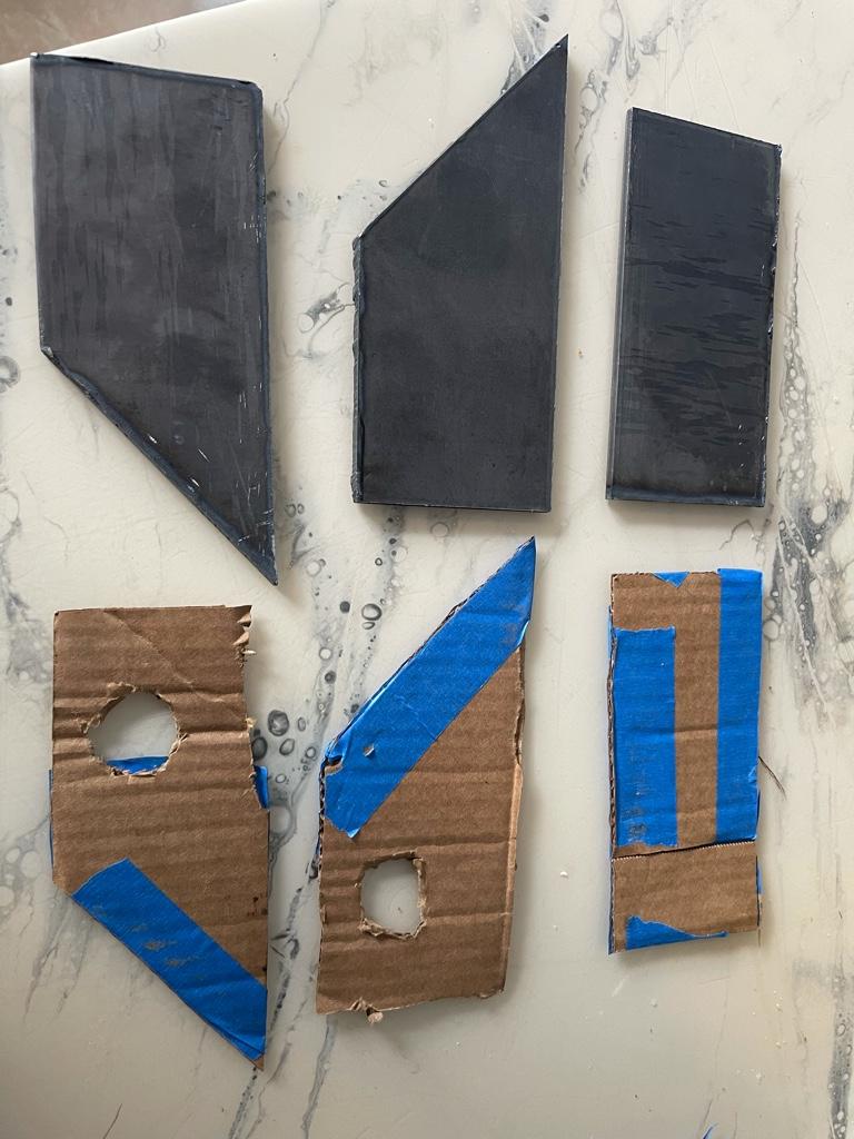

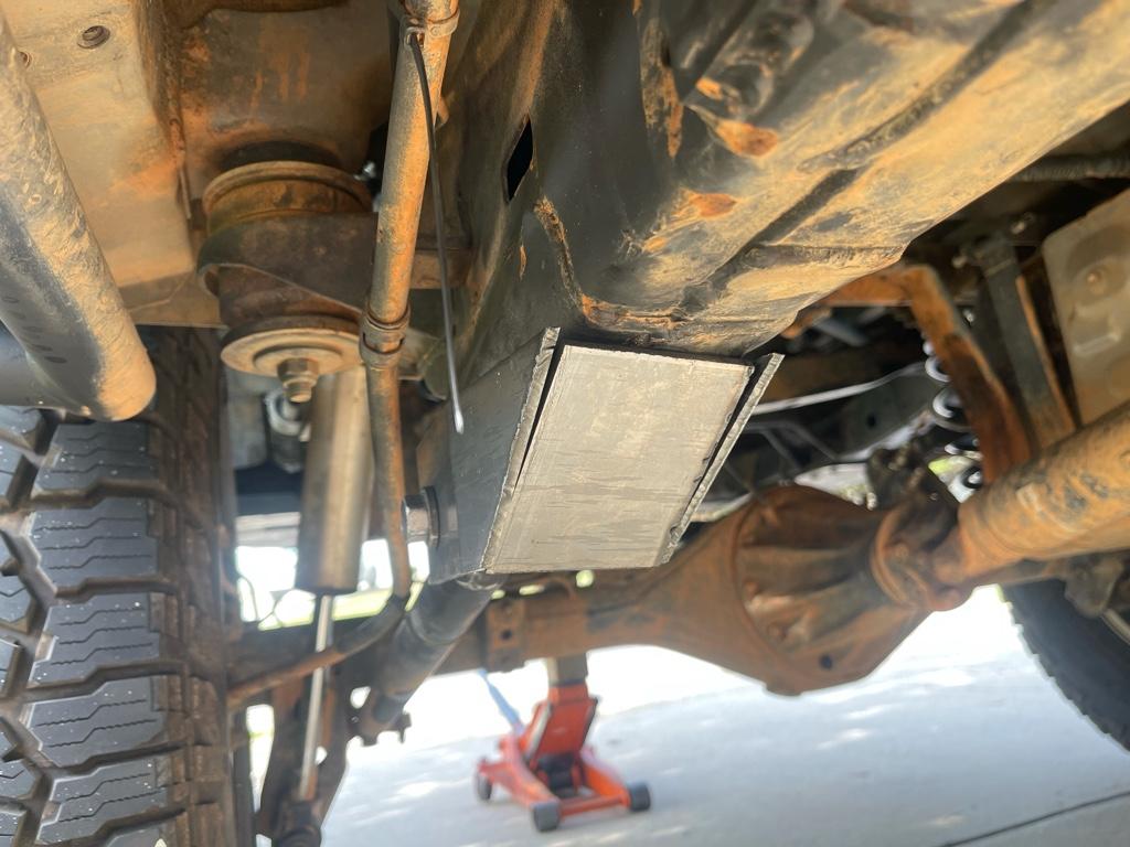

Started with a template for the lower link guards since I banged then up pretty bad last time, and they are small so figured it’s a good starting point.
Decided it wasn’t the effort to make templates, buy more sheet metal, cut and fab the differential skid so placed an order for the RCI one today, can’t wait to get it in.
The remainder of the skids I plan to fab myself. I need to make a gas tank skid, and some lower shock guards. Once the FJ transfer case is in I may think about fabricating a cross member with a skid to go under it as well since I sat it right on the tcase skid a few times as well..

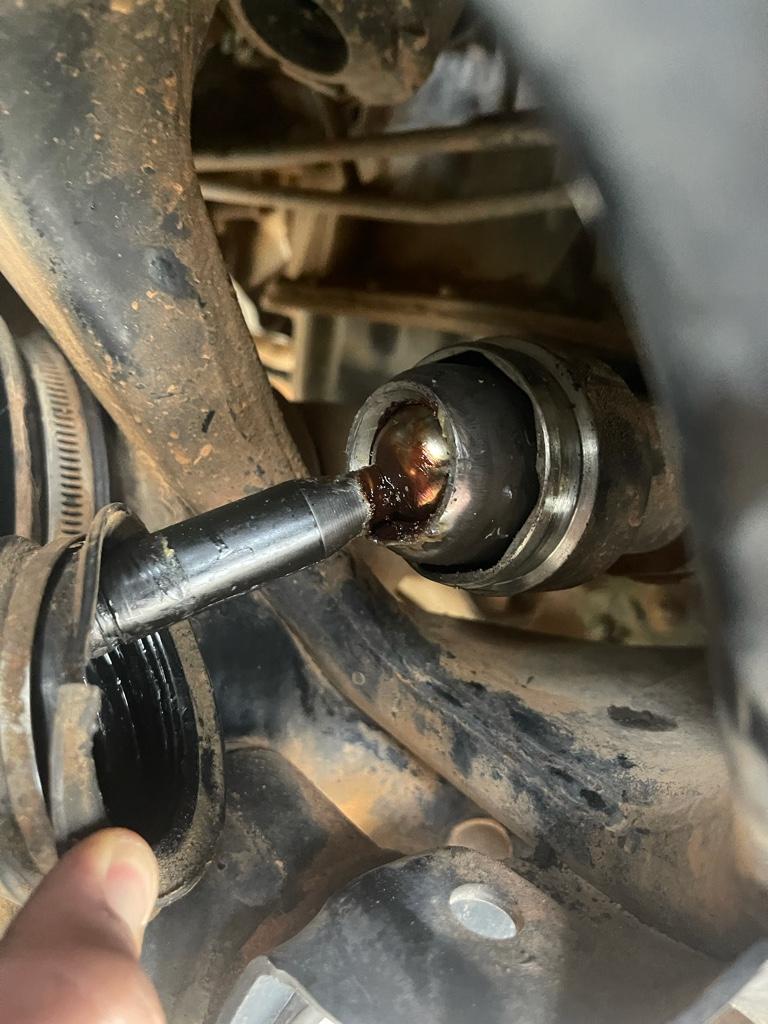

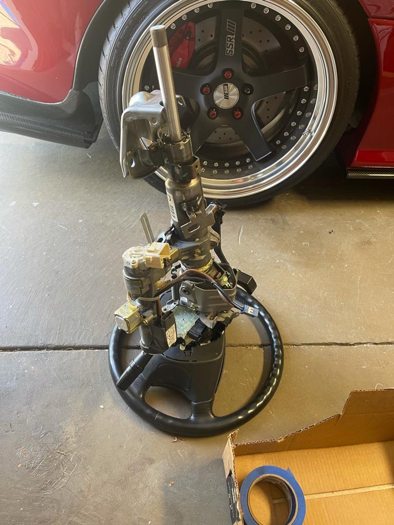

Got the inner and outer tie rods replaced yesterday with a driveway alignment :) and took some time this morning making sure there were no loose connections along my steering shaft anywhere. Found a thread on the tacom forums talking about play in the shaft resulting from a slip joint wearing out and needing a small tack weld. Come to find out after taking it al apart that the 4tunner is different. So no issues anywhere and I should be good to go.

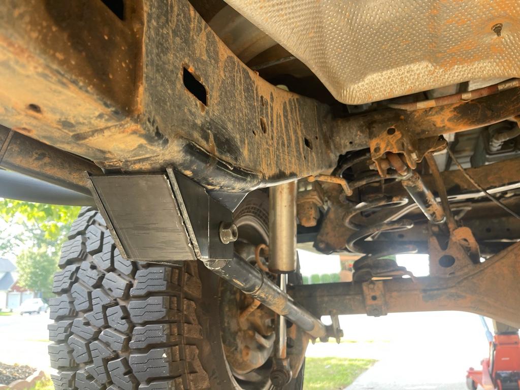

I can’t stand not having something to work on.. so I took a little time to make a new mounting location for my krazy beaver shovel. Instead mounting it behind the spare when it could rotate and hit my lift gate I decided to mount it vertically on the hi lift mount on the ladder. Now just to find a better spot for my ace… probably need to get a good clamp and throw it back on top of the molle panels where it started.
Not a bad start for the lower link reinforcement .. considered welding them in place permanently but then decided it would be a good idea to be able to replace later as needed.
