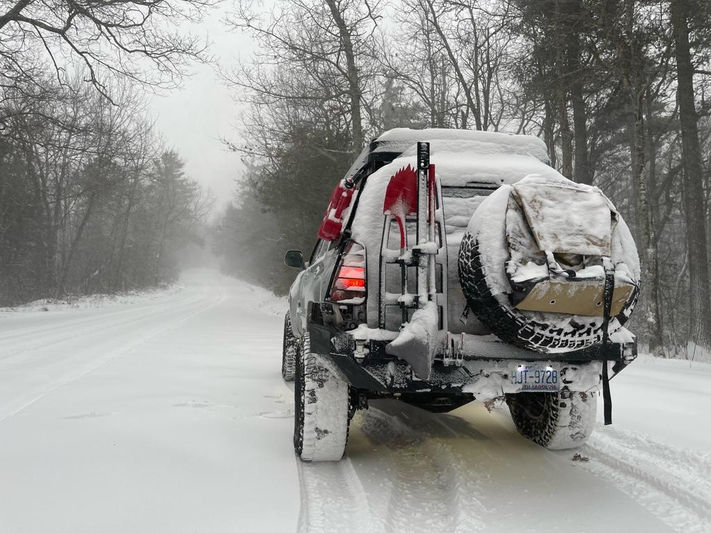

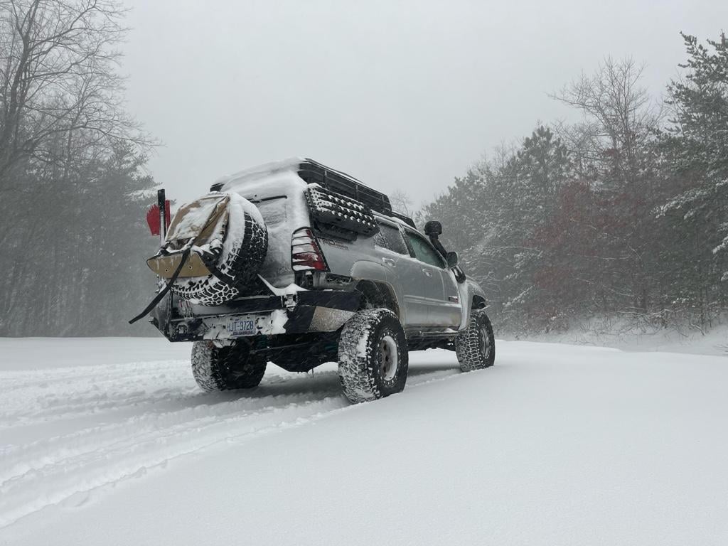

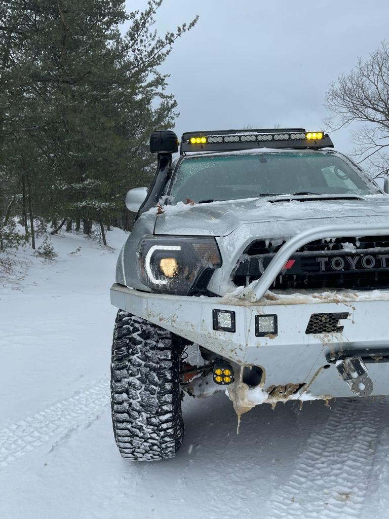

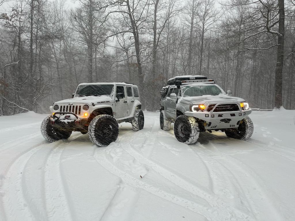

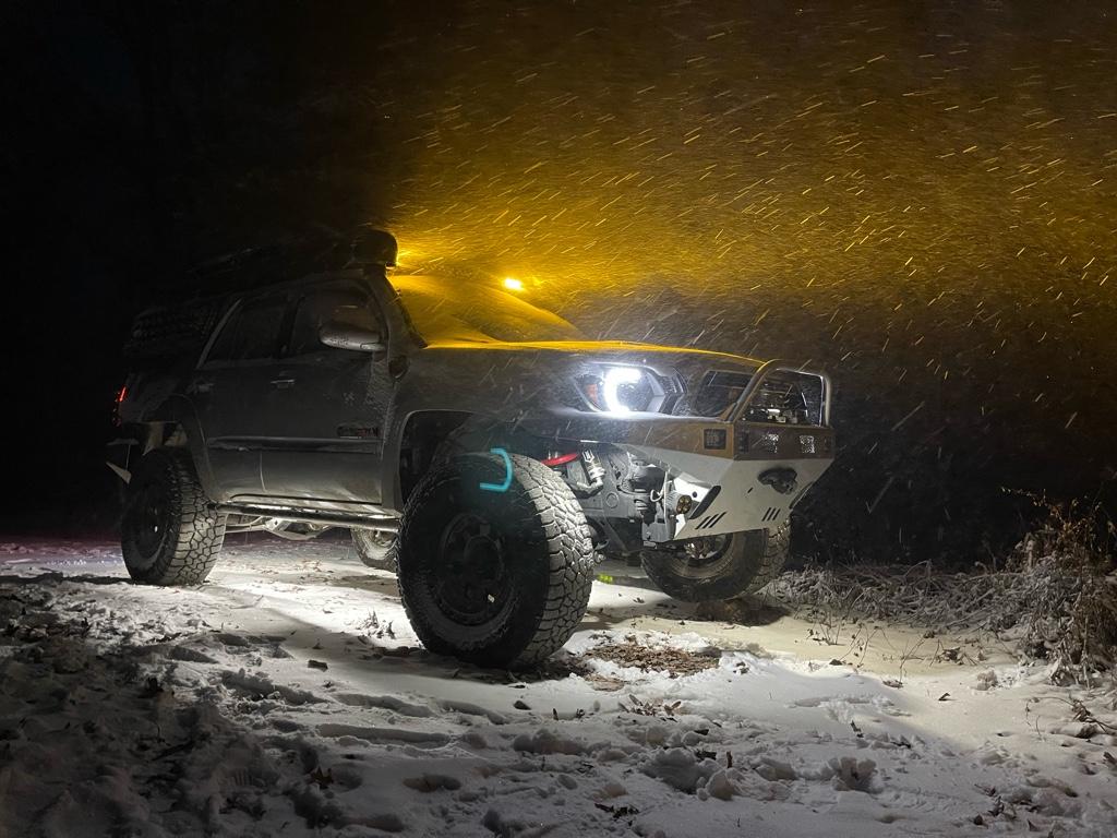

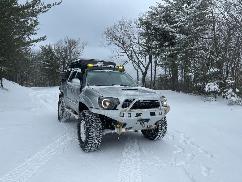

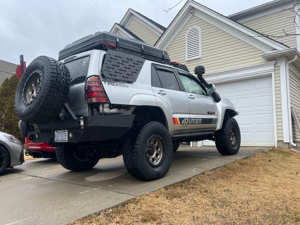

Not many updates as far as the build goes, but I did get a chance to get out into this winter storm for some snow camping and driving. Pretty cool experience, but took forever to get back home. The road conditions were absolutely terrible. Got some pretty cool pictures though.
Good to see you got the 4runner out!

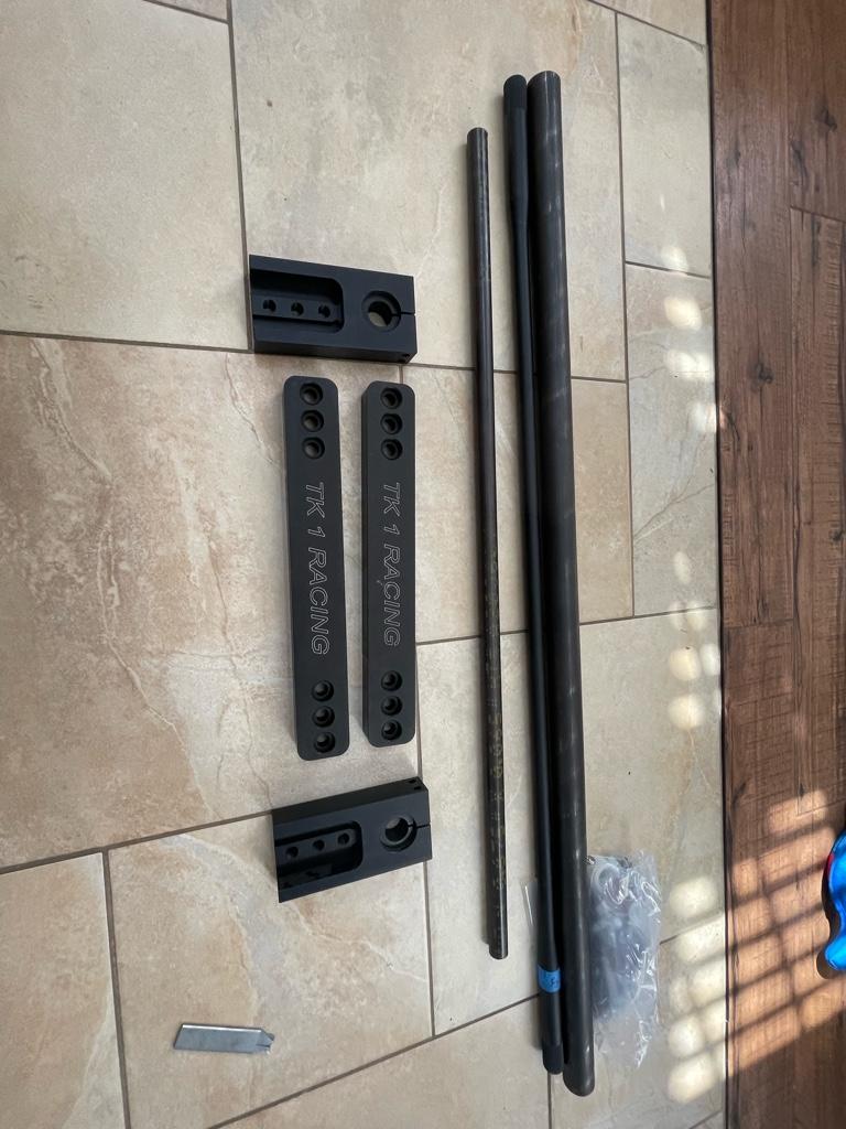

You still have those rear swat bar parts on order?
Hey man ! I do , I actually got the order in but looks like I should have specified a longer torsion bar, I got it at the standard 45inches it comes with bc it didn’t give me an option to select, but I actually needed a 48 inch bar. They’re are swapping it out with me though and I should have it next week.
Oh gotcha, so with the 4th gen 4runner, gotta go with the 48 inch bar?
We’ll his site says frame width plus 3 in … from what I can measure our frames are right at 45 in the back where I am looking to mount this.. should know soon enough

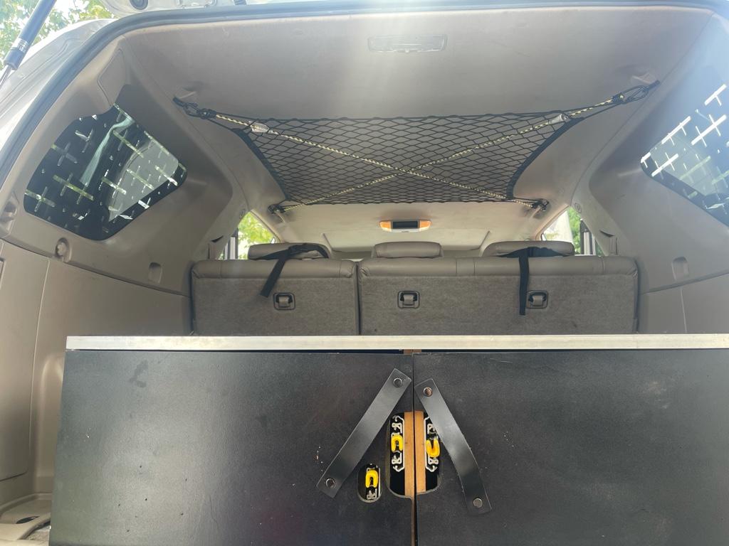

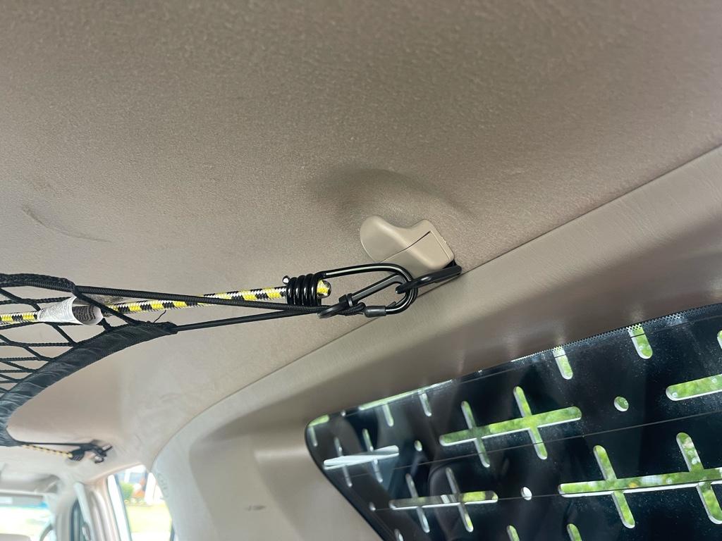

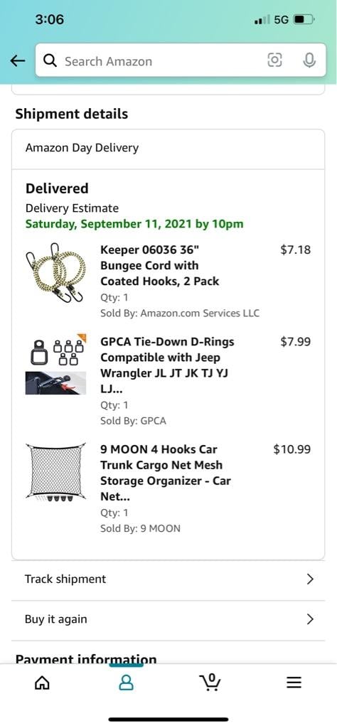

Looks good. I think I will 'borrow' this idea. Is it possible to get a picture of how you attached the front of the net, to the rear passenger grab bars? Please and thank you.
Also installed an attic cargo storage I pieced together from Amazon. Net, 4 upgraded D rings and 2 36 inch bungee cords for added weight capacity, 10 minute install, mounted right behind the handles and rear storage hooks with factory bolts and all. Should make some good storage space up top for soft thing like blankets, covers, pillows , etc. not bad for 28 bucks and 10 minutes of work.
Thanks! The front attaches the same way the rear one did, I literally just unscrewed the handle and hook and slipped the mounting brackets in between. Took me longer to fish the bungee cord through the net lol.
Hmmm. I found my extra mounting brackets/d-rings. I'll have to get them on the rear handles. But now I am thinking of making my own net. I found a good knot guy on youtube, so I'll just need to grab some 550 cord and get started.

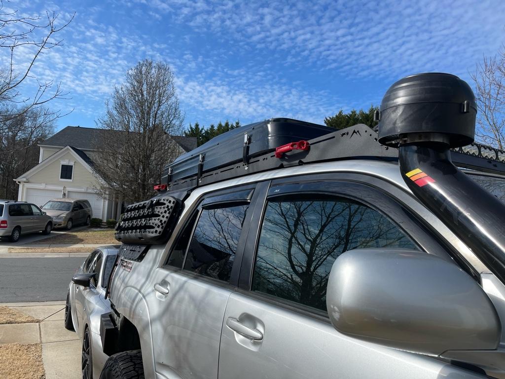

It’s the little details that matter :) installed some Agency 6 aluminum grab bars to make accessing the roof rack easier when camping. Tired of sliding my fingers under the tent and getting caught.

Well, I ordered the rear sway bar kit with the same options as you and mentioned about getting the 48 inch torsion bar. Hope it works!
Hopefully man! I got my replacement bar in but haven't had time to mock it up yet. Actually haven't even opened it yet.. lol. Hoping to get around to installing it in the next month or so.
Sweet, looking forward to seeing your install and hope it works out!

4) Rear TK 1 Racing rock crawling sway bar install.. (got all the parts in, and its long overdue to get some anti-sway action back in my life :) )
